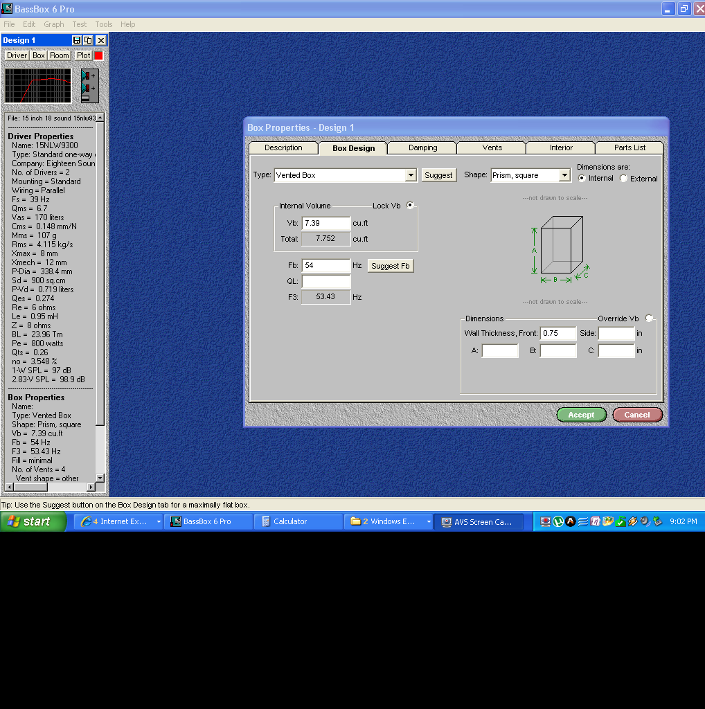

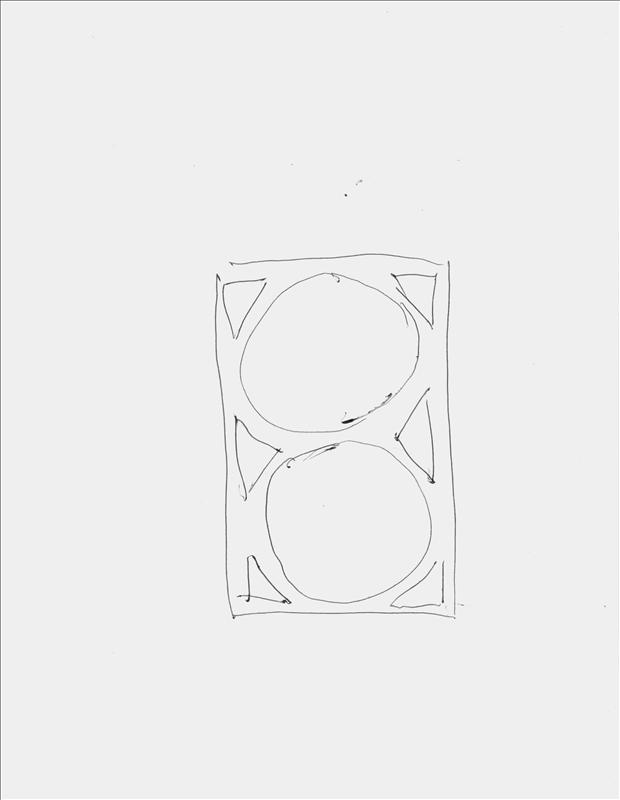

I am using the latest version of of Bassbox Pro 6.0.22, I am trying to keep the baffle of the cabinet as small as possible so the speakers will take up less wall area. To do this I need to have multiple ports. Bassbox gives me the area for a single port (3/4" long, both ends flush) for the two 15" drivers (in the Vents/Other tab) as 112.8 sq. in. When I change to two vents it gives an area of 41.49 sq. in. which times two = 82.98 sq. in. Can someone tell me why the area is smaller with two ports? is this correct? With 4 ports it gives an area of 15.45 sq. in. which times 4 = 61.8 sq. in. I have attached a very crude drawing showing the port configuration I want. I am also listing the thiele parameters, and a screen shot of Bassbox Pro . the four ports in the corners are all the same size, the two ports between the woofers are two ports the same size as the corner ones put together to form one port twice the size as the corner ones on each side. Basically the same as 8 ports all the same size. I thought I could enter in 4 ports into Bassbox and just cut them in half diagonally and connect two of them together for the middle two. But Bassbox changes the total area. Any help on this would be appreciated.

The smaller ports have a higher aspect ratio, they tune lower with less open area.

V loading will not save any area since my baffle board is only 18.5 inches wide now. the ports have no wall thickness since they are just holes cut in the baffle board (which is why I want them to be correct from the start). I am tuning to 54 hz because I am using two BMS 18N862 18" drivers for subs, the crossover frequency between them will be 65hz, 24 db per oct. The 15" drivers are 18 Sound 15NLW9300.
I think it's because you're not keeping Fb constant. If you keep Fb constant and specify two ports (meaning you specify the area), then the length should be increase by the program accordingly to maintain your desired tuning frequency.

The 18 Sound 15NLW9300 are 6.85" deep, a pair "V" loaded, like this:V loading will not save any area since my baffle board is only 18.5 inches wide now. the ports have no wall thickness since they are just holes cut in the baffle board (which is why I want them to be correct from the start). I am tuning to 54 hz because I am using two BMS 18N862 18" drivers for subs, the crossover frequency between them will be 65hz, 24 db per oct. The 15" drivers are 18 Sound 15NLW9300.
I00I
with a 5.5" front opening would only take up 18.5" width, leaving 15"x 18.5" of front panel space available for porting, or you could even reduce the vertical height if desired.
A large ducted port that will have plenty of volume and won't be "blown out" at high Xmax can easily be installed in that area.
Ducted ports are relatively easy to adjust, simply make them a little long, then reduce length if Fb is too low.
Fb can be determined by sweeping a sine wave tone, excursion will be least at Fb.
Ducted ports reduce the amount of reflected upper speaker response coming through the port compared to 3/4" depth holes, so less (if any) damping material needs to be used.
The more damping material, the less LF output.
The "V" plenum will cause a low mid peaking response (like a small horn) which can be EQd out, giving a bit more headroom than front mounted cones.
The reduced radiation area also will reduce comb filtering at the upper end of the speaker's bandwidth.
