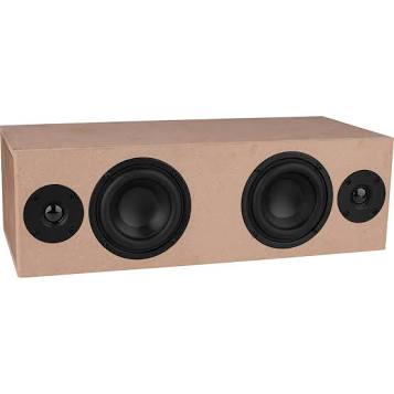

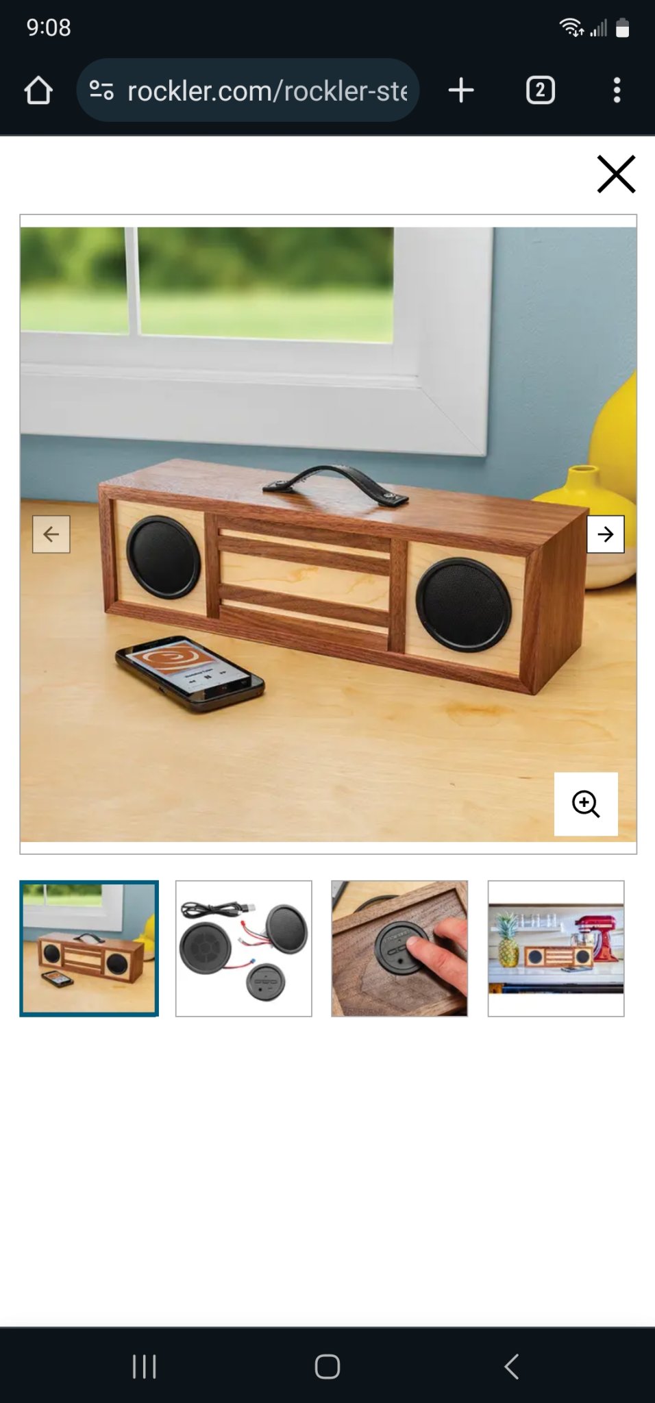

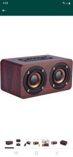

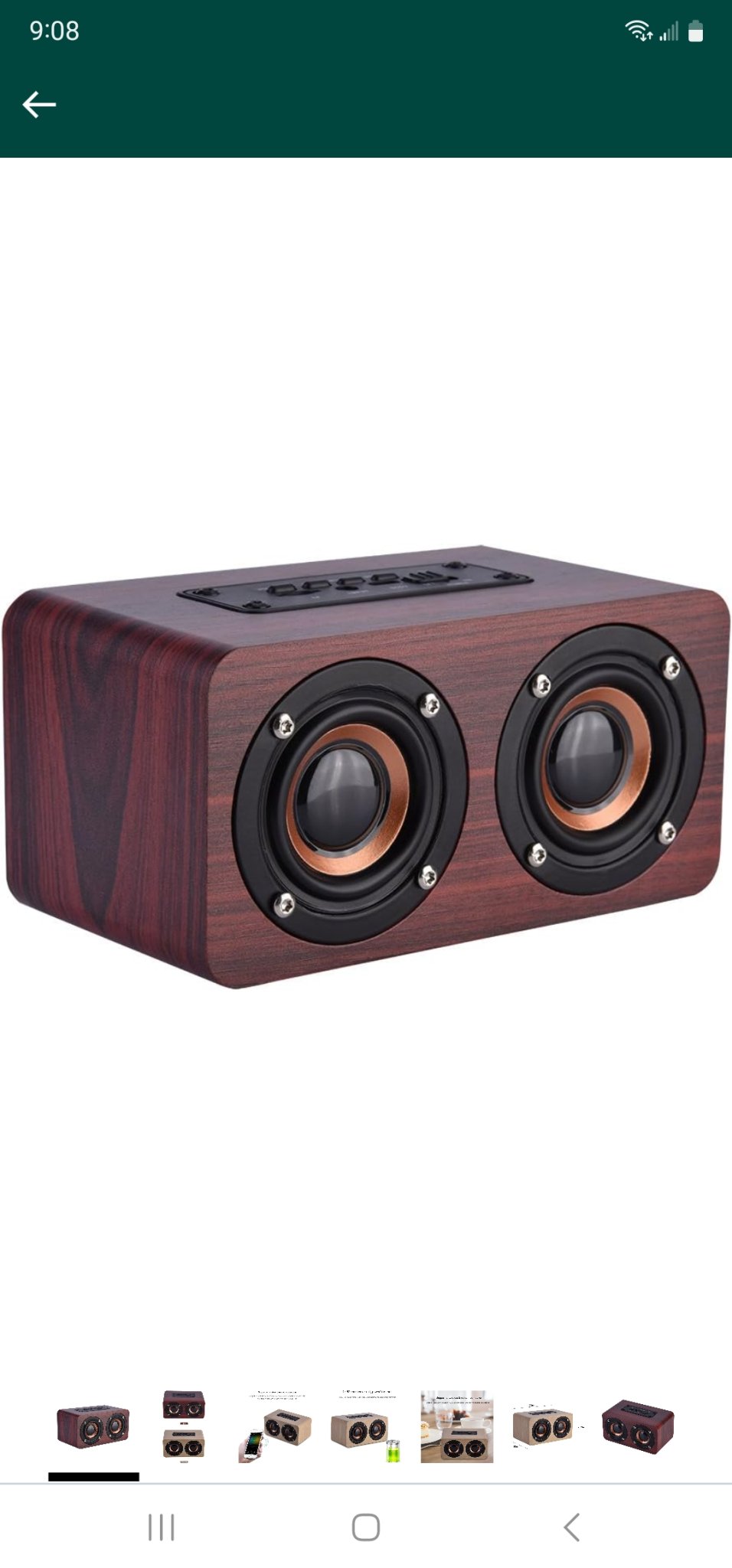

By the way, your example "download(2).jpg" is quite bad, bexause of tweeters horizontally next to woofers (combing!). And the "amazon" example would only provide stereo image when sticking your nose on the speaker ... other than that just "stereo combing".
Agreed...that horizontal placement is a disaster. It would work only if fullrange drivers instead of tweeters are used, just supported by the subwoofers.
