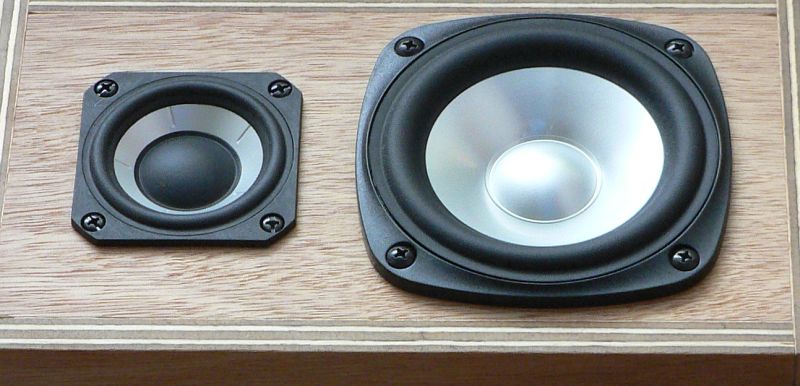

Guys, 2xND65's (full range) in a 0.06cuft box, happy with the F3 of 68hz, would one try 4 of 1" pipes (not sure length yet) or a L slot (box internal h 70mm d 90mm L 280mm). I'm trialling 7mm thick ply with 2 layers on the front, so have enough to make a L slot if it is most benefical. When sim'd a 20mm x 70mm wants a length of 350mm and has a 1st port resonance of 484hz, is that too high? I would love it (if going a L slot) to only have a 10mm wide opening?
Any advice would be appreciated as most of my port sizing to date has been heavily assisted and i'm not 100% sure what the 1st port should be.

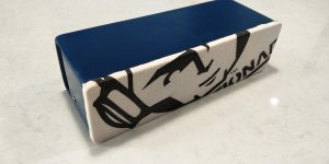

Sorry it was two drivers in a 0.06 cuft box, just for a battery Bluetooth application. It seemed to model alright in Winisd with a F0 of 75-80 hz.

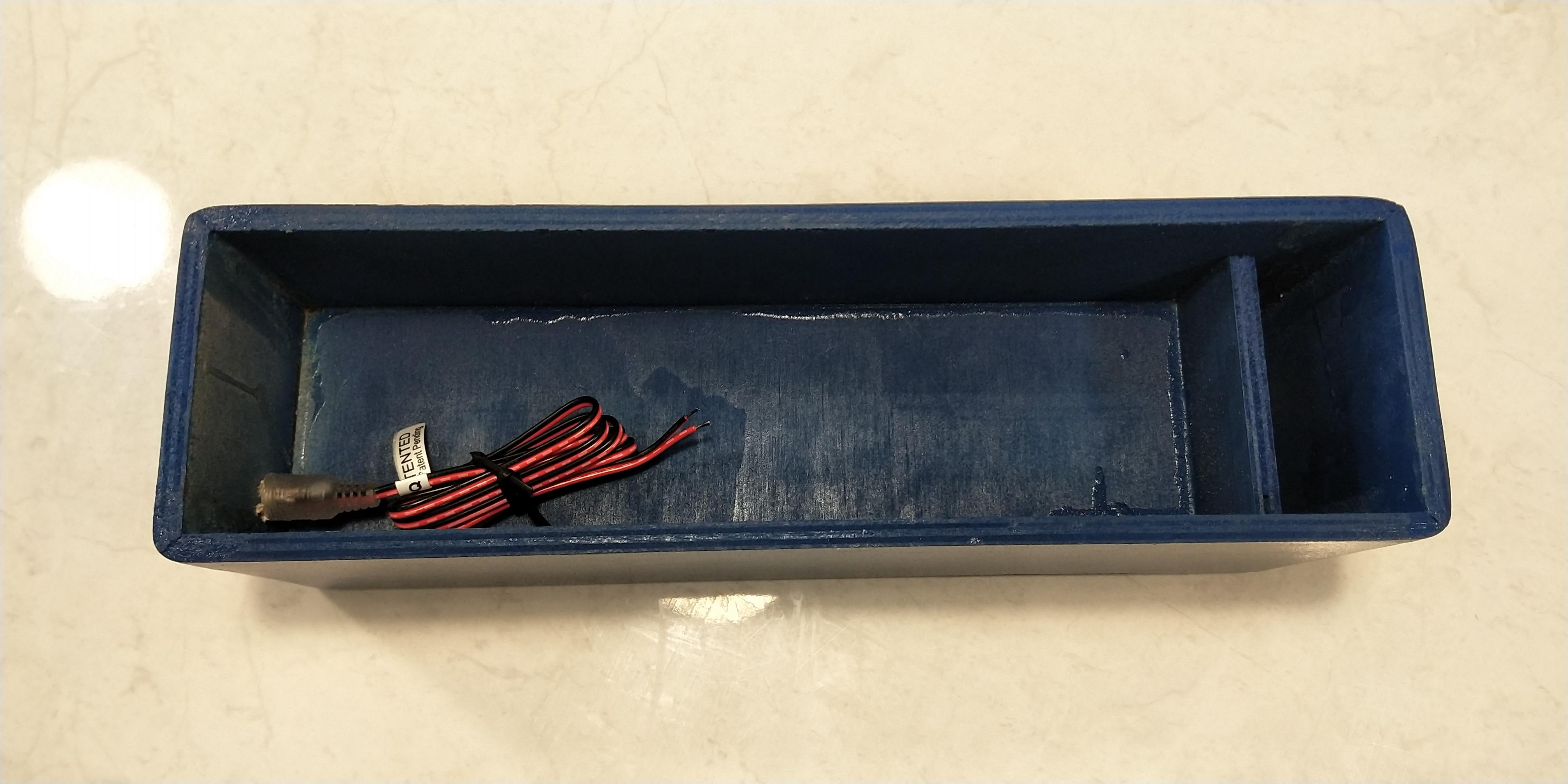

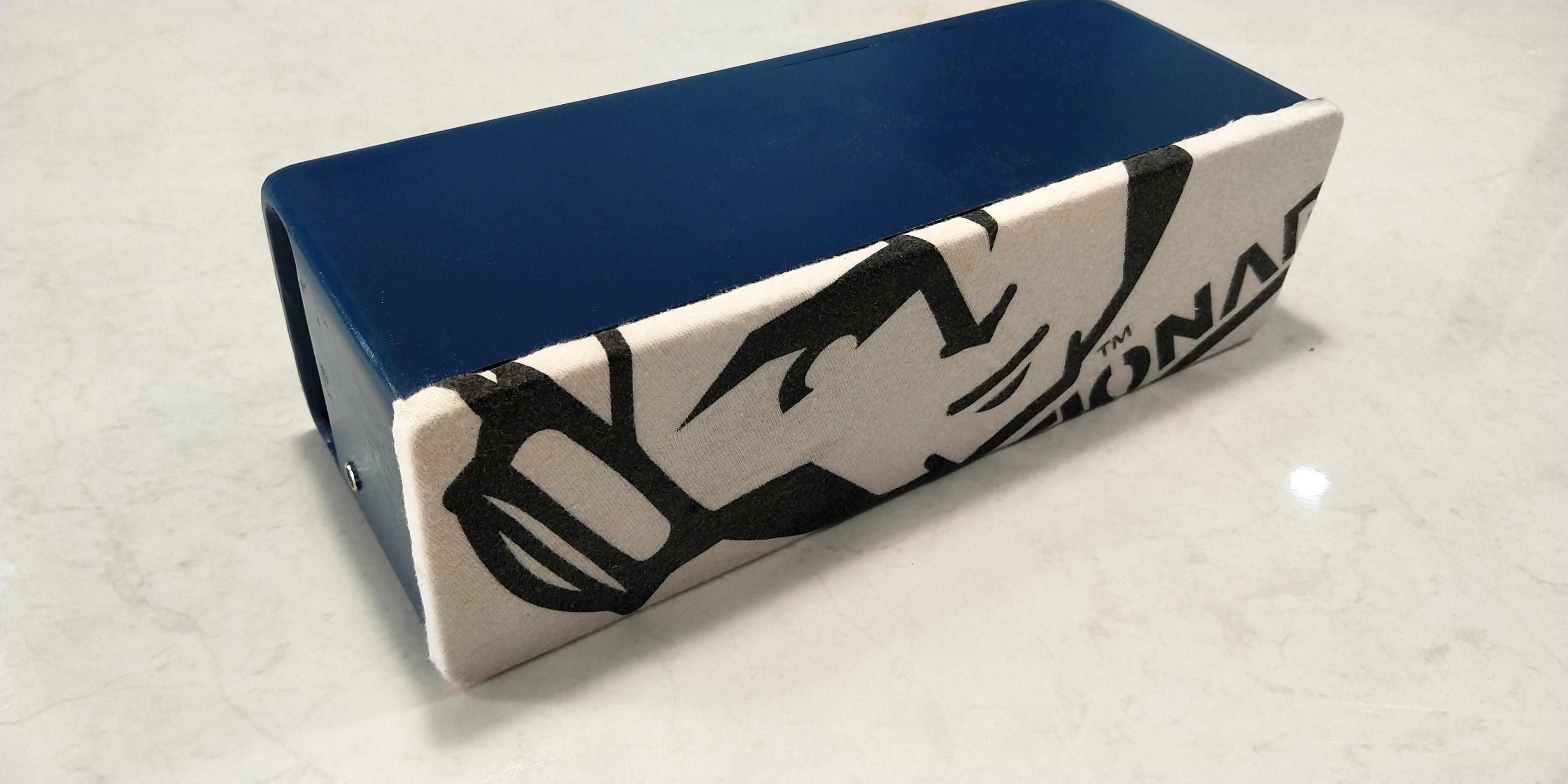

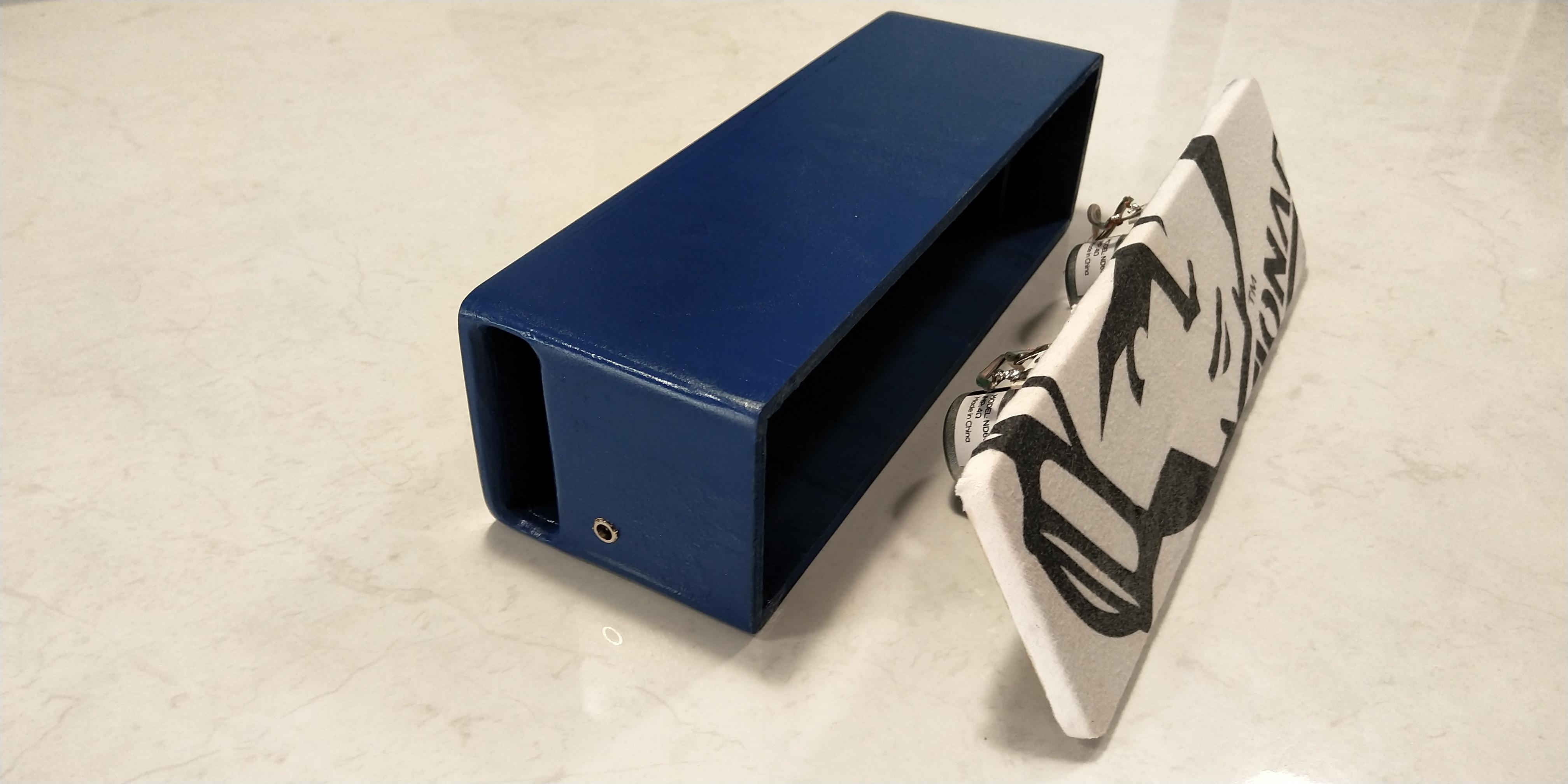

Look I will say something now, I got impatient and built the box, then put a l slot port in and routed the end (where it comes out). Then stupidly super glued the speakers onto the back of the faceplate thinking it would be easily removed. To be honest it sounds alright but did reduce the box volume by putting in the long port, does sound a bit bright at the high end

Yeah it definitely needs a bsc, I think my port ended up being 20*65*300mm. I still have some left over resistors and inductors which might have been since last time i tried something with the ND65 4ohm's

have you considered placing the port on the outside of the cabinet? this way you suffer no decrease in internal cabinet volume. The only consideration is the visual esthetic.
I had a few errors in judgement with this, first being the use of super glue..thinking it could be used as a temporary hold, but it looks like more than I thought came out and having maximum bond. Hence the material over the speakers as I couldn't finish it off like I wanted without damaging the drivers.
The other was impatience and being obsessed with making something extremely small for what the drivers are. The time I add the BSC and amp, batteries there isn't going to be much space left

A few port basics.
Slot ports are lossy. Multiple small ports always take up more space and are always worse than one big one. Triangular ports in the baffle corners are about as bad as it gets. Long ports have nasty pipe resonances.
Try for a circular flared port of similar area to the driver with a length not much more than its diameter. From there backwardwards you will start compromising something, somewhere in the design. My rule of thumb is that if the port starts to look really silly, either the driver or the enclosure is unsuitable for the job. If it's a baby battery Bluetooth speaker I wouldn't get too excited about any of my above comments...

the cabinet you show is going to behave more like a transmission line than a reflex vent Try damping the line and chamber and see what it sounds like.
Ok, what would one anticipate with dampening? I have a little stuffing I can slide up the line, might need to source some for the chamber. The only reason I ended up going the L Slot was because some gent on here got some great results with the ND65's but his enclosure was larger.
I put my BSC together before and let's just say real estate is at a premium in the chamber, pretty much didn't think of the impacts, but just going to finish it now and see how it sounds
