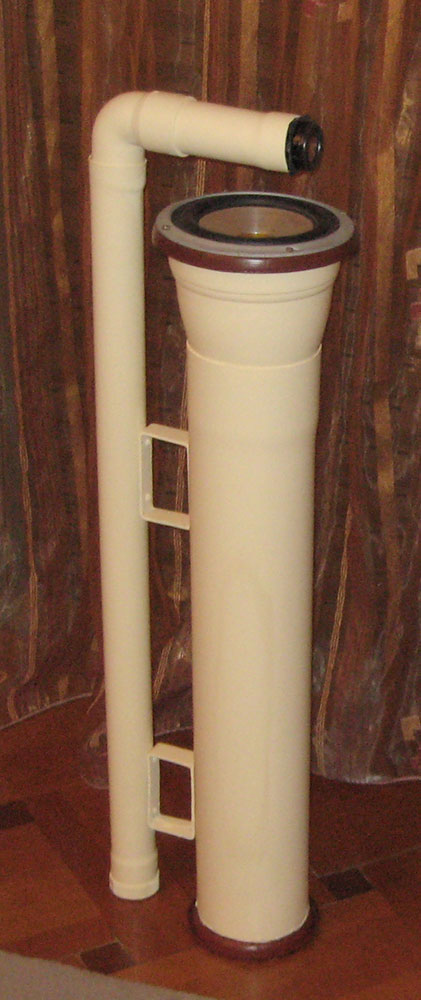

From my experience of building Pluto clones, I conclude the wider the tube, the better bass you will have.
My first version was with a no-name 6’’ woofer I had in hand (watch attached picture). In this version I use a wider tube in order to fit the 6’’ woofer. Although it was lacking detail in the mids (because of the crap woofer) the bass was deep, spacious, without much coloration or booming.
In my second build of Pluto clone, I used a 5,5’’ Jamo woofer and the recommended tube width dimensions. Result was better mids, not so low bass as before, but more boomy and coloration than before. YouTube - Pluto like Omnidirectional speakers.
