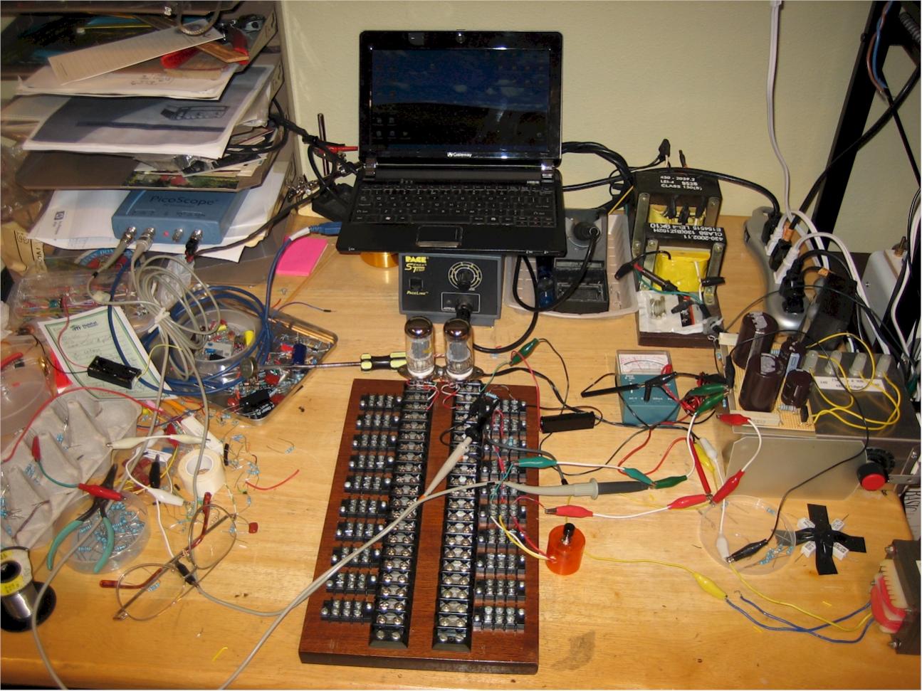

I went with the pushbutton method for now. Only change is that I needed to use a SPDT switch to connect the plate to ground when it's not energized, otherwise it floats to various random-seeming values.
The first curve I got (Vg = 0.00) looks OK but needs some smoothing. I'm plotting in Excel so the math should be easy to get to, just haven't figured it out yet. Once nice thing about using Excel is that it can remove duplicate data entries, which at ~100 samples/sec means most of the data (all of it redundant).
Also a shot of a "steam punk" solderless breadboard idea I'm trying out. $40 worth of terminal strips off of E-bay, but worth the money if it makes wiring simpler. Haven't made up my mind yet.
Thanks to all for the help...
