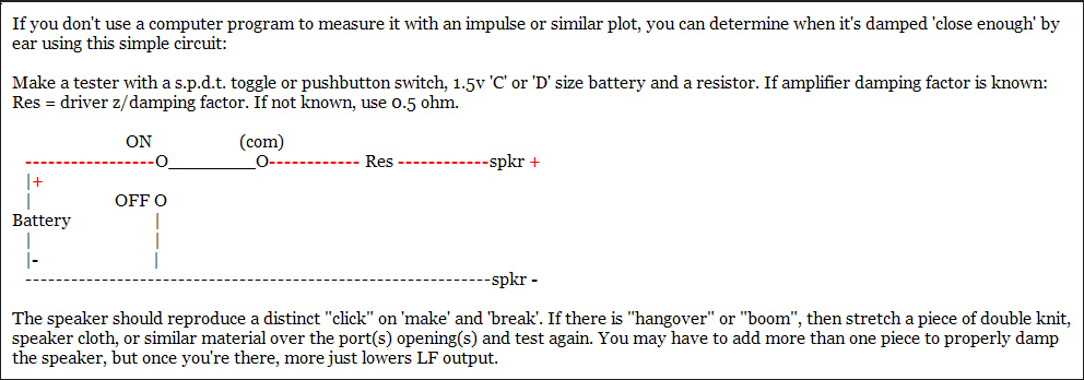

a/ the data is accurate, and b/ you're running a normal voltage source amplifier rather than something with a higher output impedance (e.g. a SET amplifier), then something like a 121.5 litre vented box tuned to 38Hz would be a reasonable start. If you can stretch to a larger cabinet, it should suit Vb = Vas, Fb = Fs. In both cases, damp as desired using the old click test.

Click test = attached
