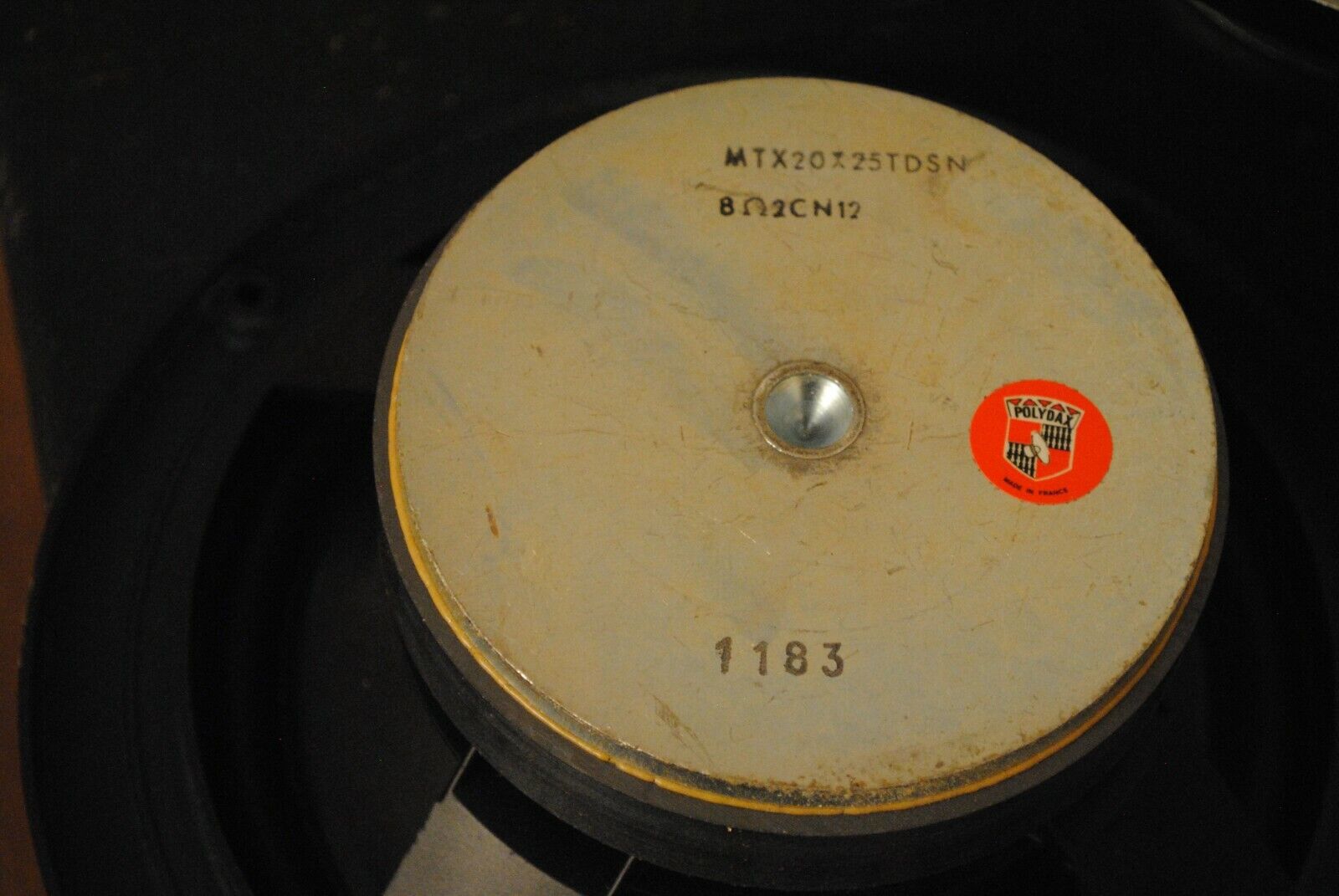

I am considering purchasing the 9" woofers as pictured in this post and need help designing crossovers along with anything else I need to consider in order to finish the subs.
the aforementioned woofers are marked MTX20X25TDSN but google turns up nothing re: specifications.

The finish and shape reminded me of my Volkswoofer.
"Stacks" or whatever chosen name goes. Subs in bases can be somewhat limiting. Your more than less stuck with nodes that may be. Unless moving the entire system. That too is less than optimal. In the past owning sub bases they basically dictated where to set up. Somewhere I did not want.
Second free subwoofers offer better tunability.
The basket means the sub is well made. That cast aluminum was only on the higher tier stuff back then. If you chose you could still do better with current subs for not a ton of money.

after a great deal more reading / research hopefully things are starting to come info focus.
my current thinking is as follows;
miniDSP 2 X 4
Dayton Audio APA150 (1 per channel)
I was just offered a great deal on a pair of Peerless XLS Series 10” Woofers but apparently they don't like a cabinet the size of mine (4 cubic ft.)
so maybe Dayton Audio RSS315HFA (or similar) or step up to 15s ?
