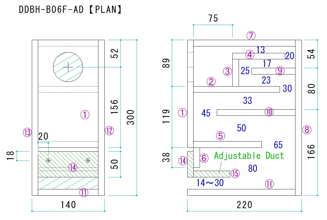

Pensil P7HD would be an option: https://www.markaudio.com/wp-content/uploads/2022/09/Pensil-P7HD.png

That's on the short list. I don't understand what I would gain and give up were I to choose between a tapered folded path, folded Voigt pipe and the Pensil simpler TL.Pensil P7HD would be an option: https://www.markaudio.com/wp-content/uploads/2022/09/Pensil-P7HD.png

Just to clarify a point -the pensils are actually almost the opposite of that. The pensil alignment / alignments I created are typically (by intent) larger in volume terms than most MLTLs of similar (or lower) tuning. When I designed them a traditional acoustically large volume was a design objective for broadband gain purposes, to allow tuning & positioning flexibility, and because in the process I could damp the excess & provide something approaching a traditional resistive TL impedance load so they behaved reasonably consistently with a range of different amplifier types.
I didn’t get this concept and, therefore, didn’t take the damping far enough when I built Alpair 10.2 Pensils. The result was that I only used mine for a couple of months and moved on. I can only see all this now, after my recent experience building a pair of Maeshowe; the damping is as important as any other aspect of the build.damp the excess
My mindset in the past was always that I wanted to squeeze as much bass out of a design as I could. This is probably driven by the notion that “everybody knows fullrangers can’t do bass”. Your designs are so damned good that often enough there is simply too much bass by default, and the challenge is to tame it, not squeeze it for more. People like me need to pay more attention to that.
Regarding the OPs decision, I second the Castle microTowers. I know he wants single driver and has already said these aren’t in the running, but he did specifically say he wants the sound to come from “nowhere” (and everywhere?) and this is something that the Castle microTowers do better than most.
