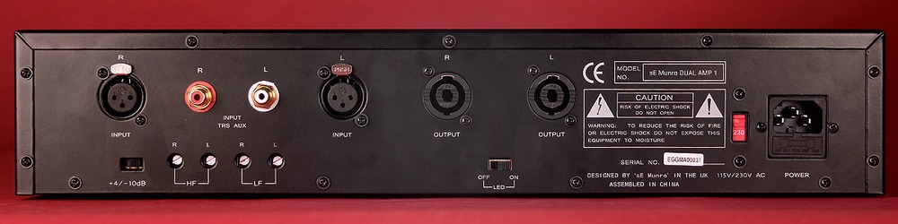

Thank you both for the replies!
This looks hopeful:- Alps series SRBM thanks Moose.
And Buck, you've saved the day as you highlighted that I do actually need Balanced inputs (Balanced Main and unbalanced RCA Aux) - so that would need 3 pole?
I thought maybe with the number of pins on that switch, it might be.
I'm not an expert at balanced inputs except for what's obvious: each balanced channel has three wires, not two. On your amp, this is only on the "main" input; the "aux" just has two plus ground.
Maybe someone with more experience can toss in their thoughts.
