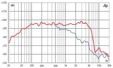

The Celestion is ok. But nothing particularly noteworthy, I think. So I'll raise you one, since we're raiding the bargain bin for PA components.
Have a look at this:
How much do think this retails for?
If you thought it's well over US$100 / €100E, you'd be wrong:
https://www.thomann.de/intl/turbosound_ts_12w350_8a.htm

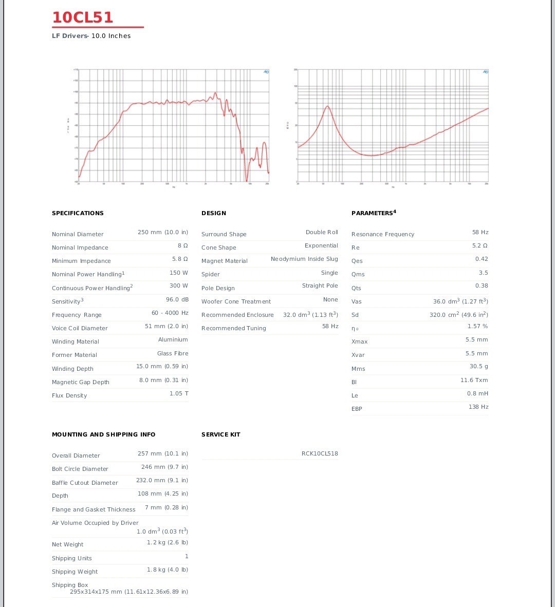

The grs 10 inch pa woofer looks quite good as well, Matt at mtg made a two way with it that I'd like to make, the vbs 10.2, crazy performance the cost if you ask me.

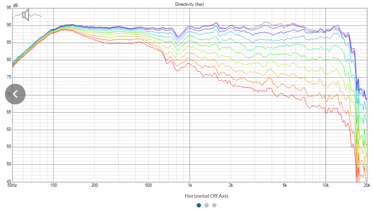

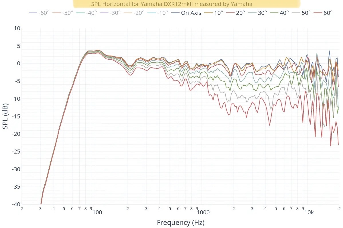

Here’s the DXR mkII speaker, as measured by Yamaha, published at spinorama.org

I'm pretty darn happy with it.
DSP is nearly a requirement; the stock response is shaped like a "smile":
https://www.diyaudio.com/community/threads/favorite-horn-cd-combos.363667/page-2
The lower treble is recessed by about 4dB, right out of the box.
But add a MiniDSP and it's real high fidelity.
In the measurements posted above, the beamwidth is narrower than it is "in real life." Basically I moved the mic from left to right to do the measurements. What you SHOULD do is move the mic in an arc centered on the speaker. So that you're always equidistant.
I was in a hurry when I made that measurement.

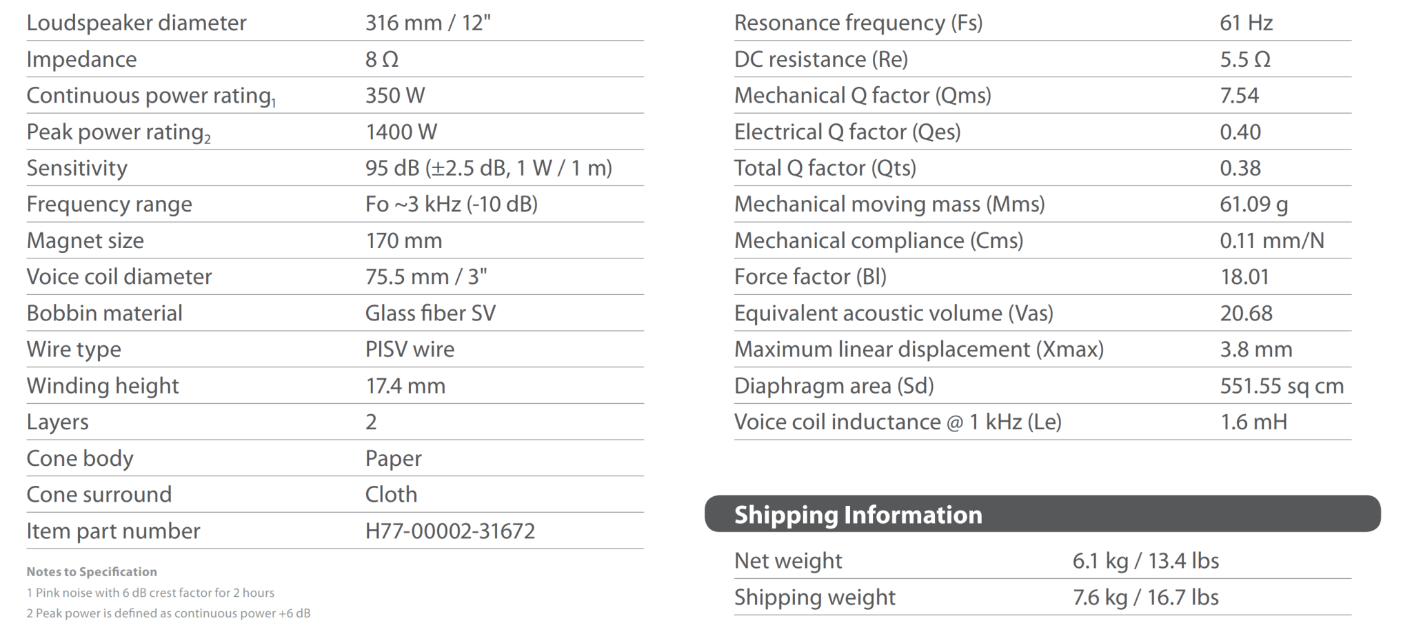

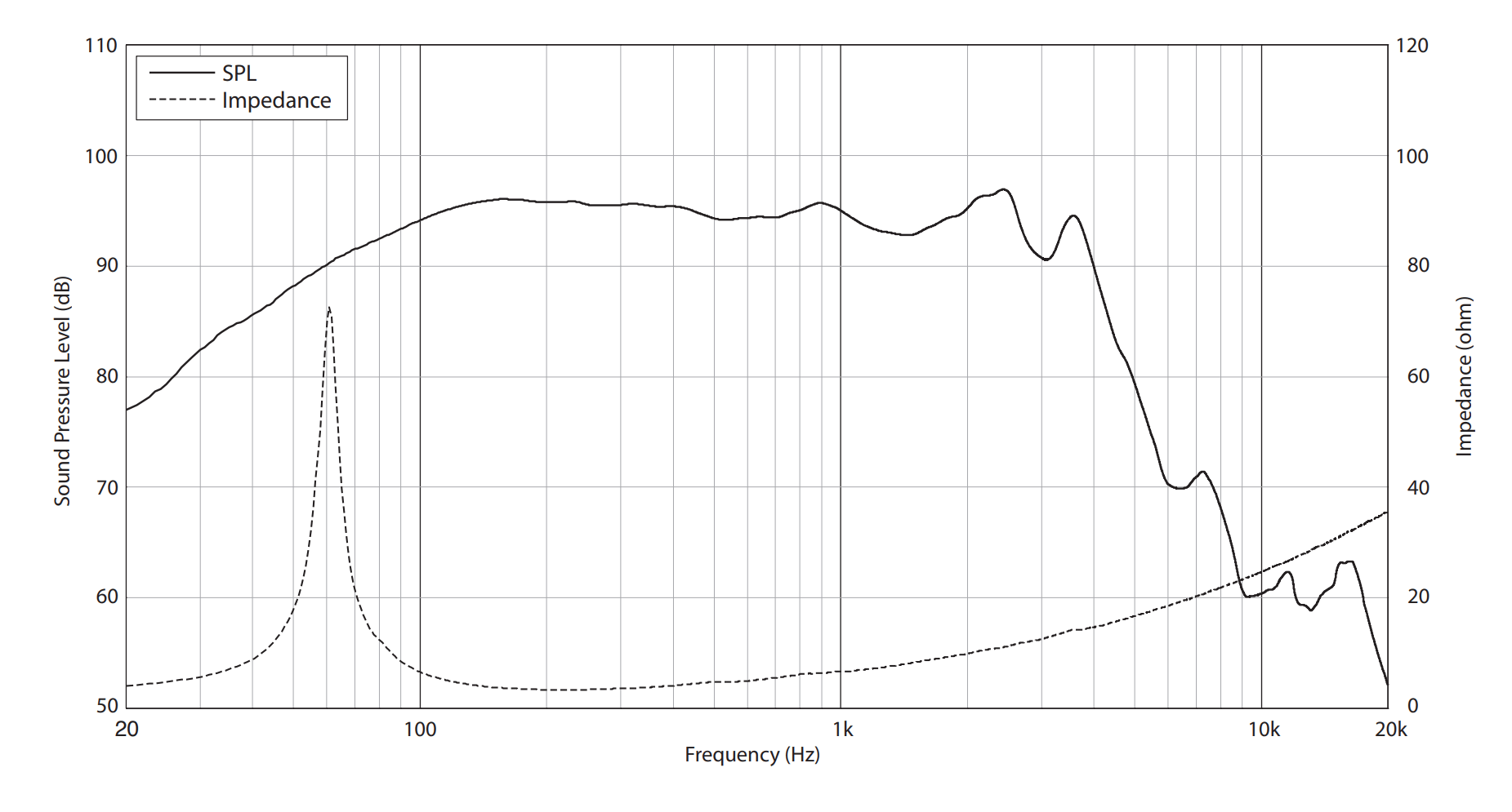

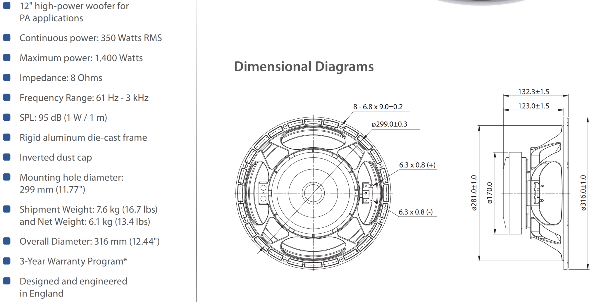

Don't forget about the Fane 12-300.
https://www.fane-international.com/view-product/SOVEREIGN-12-3002#tab-5
0 and 45° if my memory is still functional.

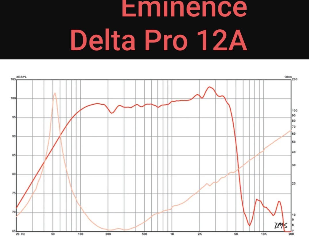

What about the Eminence Delta Pro 12A? That's a very good woofer for the money. Yamaha used it in their S112V passive cabs, which were crippled by the cheap crossover, cabinet and garbage compression driver. That woofer will certainly handle more power and stay more composed than the cheaper Alphas or various Celestions. It goes pretty low in a decent ported enclosure and has reasonably clean midrange.

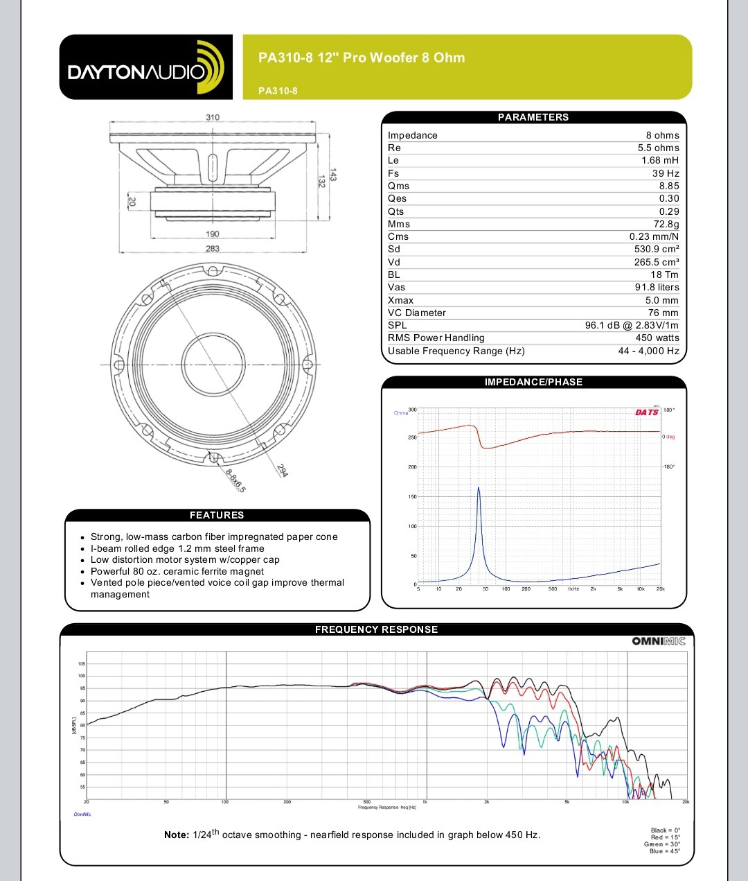

The Dayton PA310 is another great one with exceptional low end capabilities.
