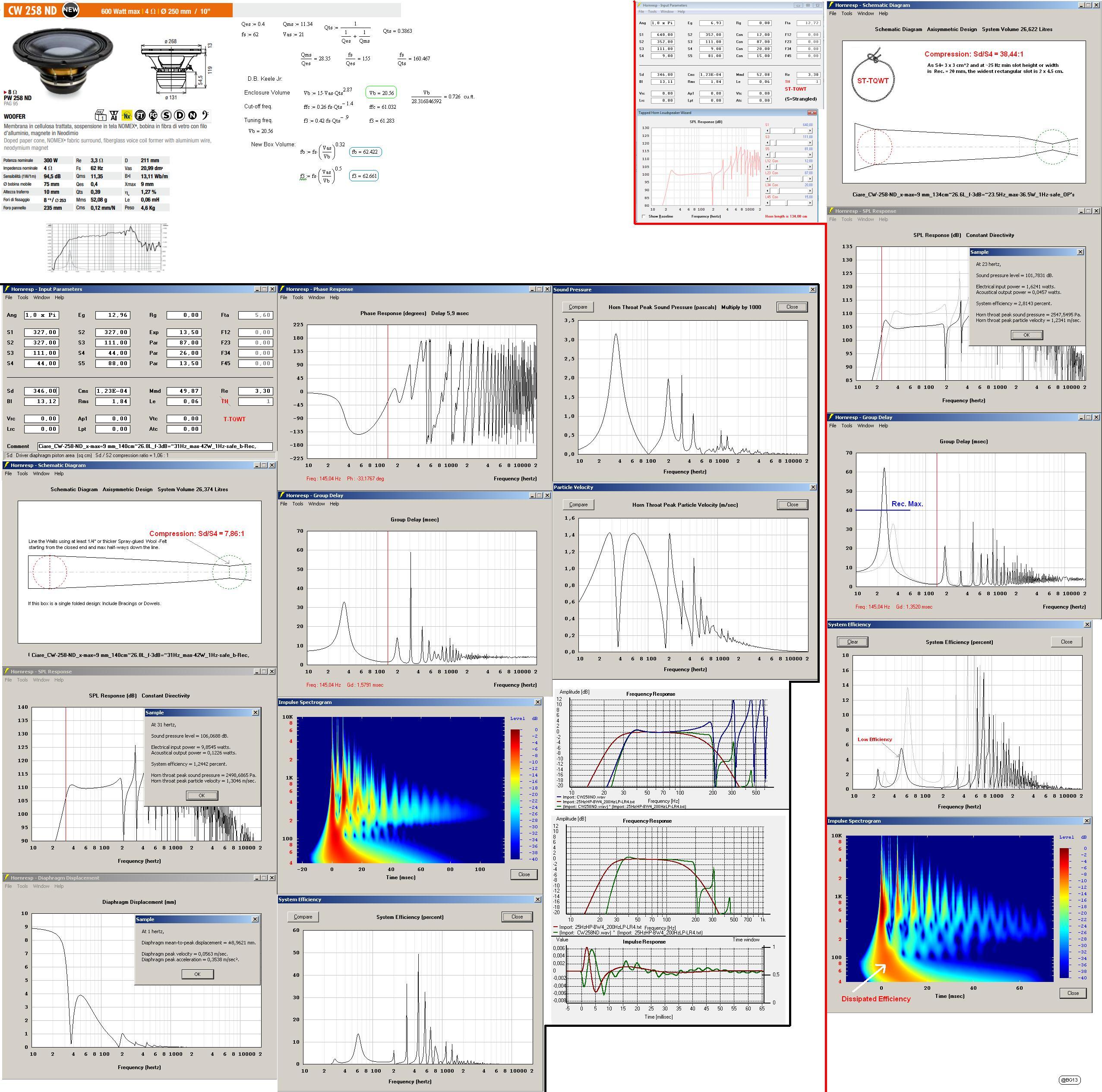

I know search for optimal mini sub is well talked on the web. I've read all i can find...But most of time, it is for max spl. I think tapped horn can be also use to get very small cabinet with very flat frequency from 20 to 200hz. It would not be efficient, but it would be to use at low level at home, only for bass playing. I cannot access to picasa to upload images, so i'll have to explain.I can't post now hornresp simulations.
First, i made simulation with all tang band speakers from 2 4" wich was not so bad, to 8"...i tryed with some B&C speaker (10nw64,8nw81,8fg51)...But as i can go 4ohm, it's not so much optimal until i get a 4 ohm speaker, or 2 8 ohm. I've tested with some 18sound, some sica, seas, and some ciare pro, faital. And that here i discover ciare public range speakers... the cw258nd is a 10" 4 ohm speaker with a very low VAS.
In a 5 segment tapped in only 20 liters it reach a near flat response from 30 to 180 hz with a group delay of 20ms @30hz (not so bad) at 92-94 db @1pi space (nead a wall). With 12 watts, it make 100 db. Diaphragm displacement is only 2,5mm...far from the 9 mm xmax. The impulse response is bad, but as it only for sub...i don't know if it really matter.
I choose first this speaker because it the only 10" 4ohm speaker with a VAS near 20 without going for rubber surround.
His xmax limit would be reached at 100w, and it would push 110 db.
After all, if finally it is possible, it should maybe realized in a kind of Bill Fitzmaurice Jack10 like this Another Jack 10 build - Page 2 - finnbass.com ; It is a interesting way to do a cubic tapped horn and seems to work well.
As it's only numbers for me, does 100-110 db in a 1pi space seems you "enough" ?
There would be a active crossover in the 180 range to mix with a guitar cabinet used as "medium-high" speaker. The idea is to have practice bass, and guitar cabinets, in the smallest volume possible keeping good lows. A small tda chip amp would run the low (and maybe after something bigger) and a 1w SE UL ECL82 for the medium/high.
I need your help because it's only simulation. I tryed to do the best i understood from what i've found on the web. But it would be the first time i try tapped horn.
Did i misunderstand something ?
Does it seems you a interesting ?
Any suggestion ?

It would be enough for practice volume for me, but I don't like loud volume. I have my 5 watt Epiphone Valve Jr. practice amp attenuated about 10 dB (equivalent to 1/2 watt output) it will only do 100 dB flat out at one meter measured on the floor.
Counting on boundary loading is generally not a good idea, better to use half space in your figures.
You will want to delay the top cabinet by approximately the path length of the TH for proper integration, otherwise the low bass will seem "slow".
Hornresp generally exaggerates peaks and dips, the little 35 Hz bump may not happen at all, at any rate your small room response will look nothing like the chart anyway.

The low B on a five string bass is 30.86 Hz, only 1/3 octave above where papasteack's simulation drops off.for guitar ? you mean bass guitar ? why do you need 20hz ?
Slapped bass strings have output down to a few Hz, can make a 26" kick drum seem anemic by comparison when reproduced well.

Most "guitar speakers" wont have the right parameters for a TH.In a 2pi space, "lows" would be at 95db ...but does it make a huge difference @30-180 hz ? would 95db be enough at bedroom level ? with loudness effect, it seems complex to me. With 100w, the tapped horn simulation in a 2 pi space give me 103 db...So, the project seems realist, it's a very good news !

Just like a FLH, you will need to delay the top cabinet to line up a TH.We, or at least i do not want too much the speaker to add too much coloration (harmonics...) for bass. Lows are yet difficult to reconize. Whereas for guitar speaker have very low xmax and biggest xlim to add harmonic content. And I ve tryed bi amping.
It just worked very fine until the 18" have been played to hard and getted very bad. Probably going to far over xmax. I didn t have a high pass. It was a big error.
Now i want to try a different mini beast... Tapped horn make me very curious.
Other than that, the TH should sound punchier than a BR, and can be tuned very low in small cabinets using small speakers.
I have measured BR and FLH distortion, below FB/FC distortion can exceed 100% (the harmonics louder than the fundamental) with really small level input, like 10% of rated output.
Designing the Fb to be at your lowest note is a good idea, but don't worry if the response curve is rising (or falling off a bit down low).
The sealed Ampeg SVT 8x10" cabinet rolls off down low (from around 80 Hz if I remember correctly), but has enough cones to still move air down at 30 Hz.
With a TH with a small high Xmax driver, you can get as much or more clean 30Hz than an SVT in a much smaller cabinet.

The thread is about making a 30-180hz tapped horn with a 10" speaker, in 22 liters, for bedroom level. It don't really matter the purposal i want to do of it.
21 liters is very small, so it's a challenge. And the speaker choose is unconventional. This is a "big" speaker for a so small tapped horn. But, in hornresp, it seems ok !
When it will be the time of simulating and building crossover, i'll probably open another thread if i need help. My choose of bi-amping is yet done for this project. I've yet solder some parts. Maybe for another project i'll go fullrange for bass, but it's not for this time.
I stay monoamp/fullrange for guitar of course.
So please stay focus : ciare cw258nd in a 21L th horn fb 28 hz 95db @ 2pi @12w @4 ohm @ 30-180 hz. Good idea ?

PapasteackAn externally hosted image should be here but it was not working when we last tested it.
I've lost my optimised test, but it was not so far from somthing like this...
Looking back at your sim i notice that you havea S4 area of 9 square centimetres
I dont think that this is a realistic area for S4 in a physical horn.
Papasteack
Easy to agree with..
b
Thanks !
As far as i understand (and manage to say it in english!), S4 is the area of the horn in front of the speaker near outside mouth. So for a 10", we have to take his middle of the speaker to mesure. How do you suggest to mount the 10" speaker "in S4" ? Speaker front would go to S4 so it instead of rear, it would be easier. As S4 only make 44sq cm, with 3 mm x 14, half the cone should be masked ? I work wood pretty well, it's not a problem. I worry about differential sound pressure on the cone. The 10" cone area, can make S4 bigger (i don't know how to say that in english....) than hippotetical if not considered. It's..."as far as i understand"... Working wood, does the idea should be to make each point of the cone at the same distance of a S4 point, and this S4 point at L34 from a S3 point, and L45 from S5 point ?
