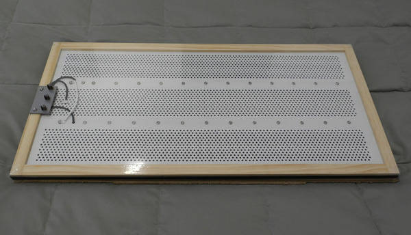

I'm in the process of gathering material for an ELS project and came across this perforated plastic material:
Perforated material punched with round holes
It looks like it has a lot of potential for Stator panels. One side could be made conductive by spraying with automotive copper spray. Any opinions fron the experts on this forum?

Assuming low or no daylight exposure and relatively low, room temperature, it seems reasonable to give it a try.
Polyolefins are prone to cold flow, so I would not use it as a part of load bearing panel structure.
You can't use then masterpieces developed by fellow DYIers with perf metal as a reference.
In respect to the PP painting/coating (real life experience 🙁)

Styrene is easily destroyed by most paints/thinners/solvents and quite brittle.

Styrene light louvre material is really junk plastic which is loaded with high amounts of plastizer so the grids will not break when they are ejected from the molds. They use regrind and the actual plastic consistancy will vary greatly form piece to piece. That said it is strong (enough) and easy to work with takes paint and glue (there are adhesive issues) though solvent welding is the best method to insure long time joint strength. Acoustat used styrene light louvre to good effect and with proper care and handling will last a good long time.
You also have to take into account the plastic is in close proximity to highly charged air and there is a very small quantity of ozone produce by the speaker which you should know eats everything. Acoustats can be run all day every day for about fifteen years before any significant degridation starts to appear. There are very many Acoustats out there which are 30 years old and still functioning, not as well as new mind you but running all the same. I think that for diy applications the styrene grid louver offers an inexpensive easy to work with base upon which to build esl panels be they perforated metal or tensioned wire as the grid structure adds both strengtrh and damping. While available in half inch (as used by Acoustat) and three eights thickness I prefer the three eights thick material as it minimises the tunnel length presented to the air flow off the diaphragm.
Light louvres are available made from acrylic which is in every way superior to styrene but in most cases is not normally stocked by suppliers due to cost. I think a general expected life span of fifteen very good years and an additional possible fifteen is more than reasonable for diy builds. I dont think I have gone more that three to five years without wanting to change a design anyway. Wire stators offer the highest quality and highest consistency of dielectric of any method of build I can think of.
All methods of construction come with their own issues and special requirements. It will depend upon the builders skills knowledge and tools at hand to determine which method best suits them or a given project. HI tech solutions to design problems almost always come with hi tech problems you must solve. Take for example the Quad 63 which was at the time an ultra hi tech esl design. They have a hord of construction problems and quality issues and even after a multi year re design are in my estimation still problematic. Comepare the Quad to the ultra simple Acoustat andy you have your proof in decades of trouble free service. Now I am not saying ther are not old Quads out there still playing music because there are, what I am saying is that no other commercial panel has near the track record of the Acoustat. So as I see it if you want a superb esl which will last a life time look to build a better Acoustat.

You're probably right. I think I'll stick with the perforated metal stators.
