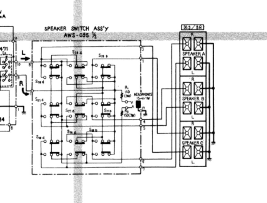

i am looking for information about the vintage receiver Pioneer sx1050.
There are rumors about the excellence of its headphone out.
I have found a free service manual online but i am not able to spot the HP out circuit 😱
I would like to know if it uses the signal coming from the speakers out.

Nothing excellent about it I'm afraid 🙂
Its the standard series resistor approach tagged to the main output

Hi and thank you All very much indeed for the helpful advice.
However looking at the schematic and if i am not wrong the 150 ohm resistors in series with the speaker outs increase the HP outs impedance to 150 ohm.
Is not this value a little on the high side ? So only high Z headphones could be used. If not the control on the bass would be not perfect for the damping factor issue.
😉 Well spotted. I didn't elaborate on that earlier because it might have confused the issue.
From the point of view of 'level matching', a series resistor is a good compromise. Low impedance phones need little voltage and that is precisely what they get with a high value series feed resistor. High impedance phones typically need much higher voltage levels for a given level (perhaps 2 volts compared to say 100 to 200 millivolts for the low impedance) and the series resistor automatically provides that. Just put some numbers into the series circuit and work out the power levels.
Damping is another matter. Headphones (like speakers) are designed to be voltage driven from a low impedance source. This is where the series resistor fails, and as such the unique impedance curve of each particular headphone will give a unique (and inaccurate) frequency response.

Thank you very much again !
so there is indeed an impedance issue.
A proper headphone amp is the sane approach.
No more doubts about it.
