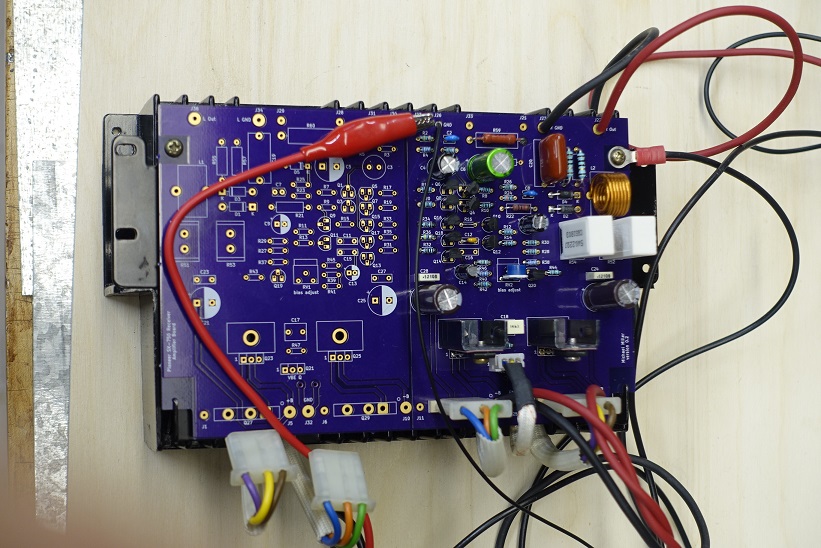

Would anyone be interested in a replacement amplifier board for the Pioneer SX-750?
As a design exercise I designed and built a PCB to replace the stock amplifier board with the aim of improving the less than stellar performance in as close to a "drop in" package as possible. As benchtested, the board has met my design goals.
- Slew rate is 15V/us into 8ohm at 40W which is fine for a 50W/ch amplifier.
- THD+N (1kHz, 50W, 8ohm) has improved by a factor of 20X from 0.082% to 0.0038%.
- Bias is maintained by a VBE multiplier rather than the original "rubber diode" STV4H.
- DC offset measured ~1mV using beta matched input transistors

Was just testing a new pair of TO-3 output devices in place of the 1970's devices and am very surprised by the improvement in performance. Did not expect to see any change to be honest. I will sort out the picture links in case this is of interest on here.
