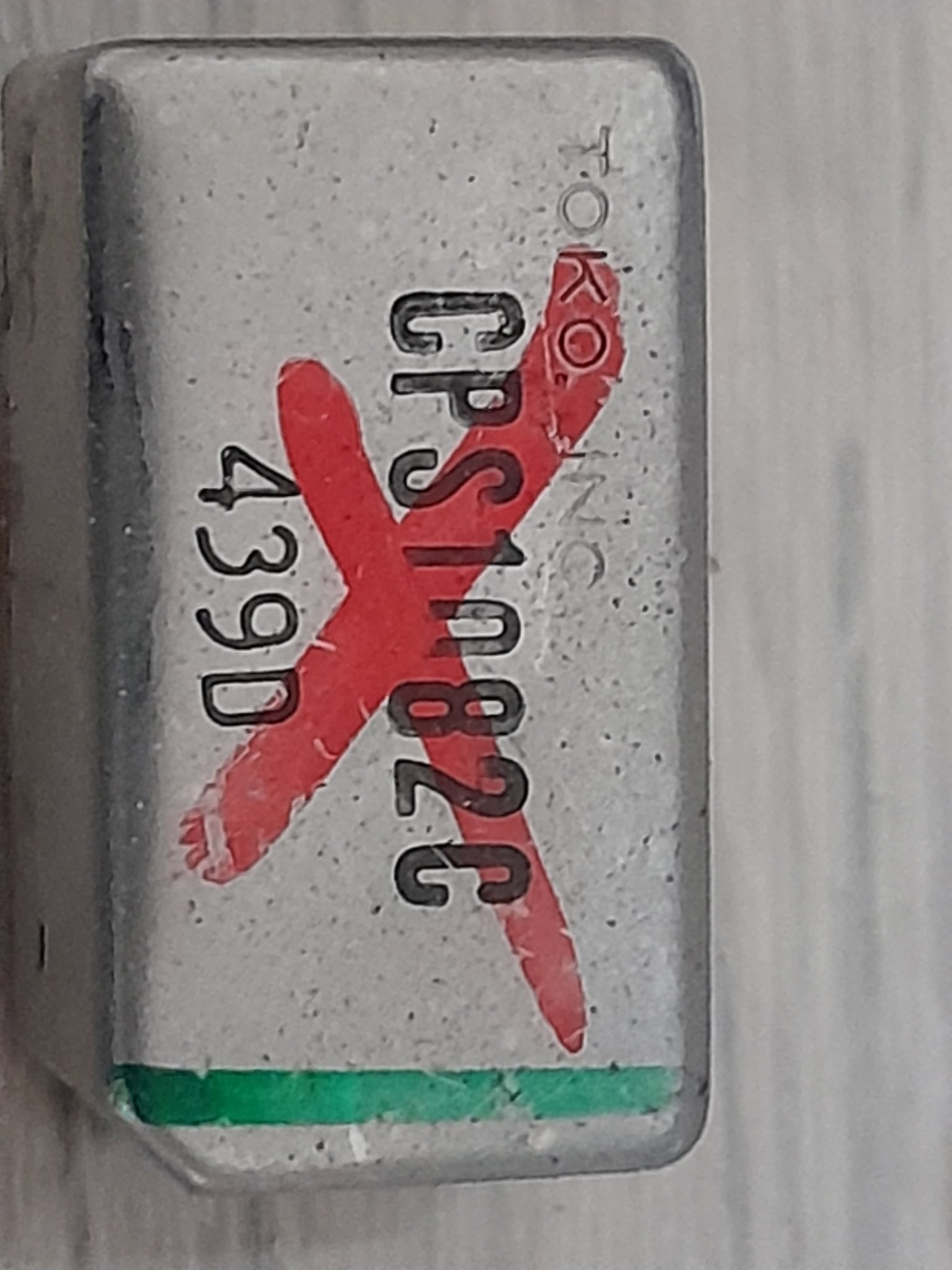

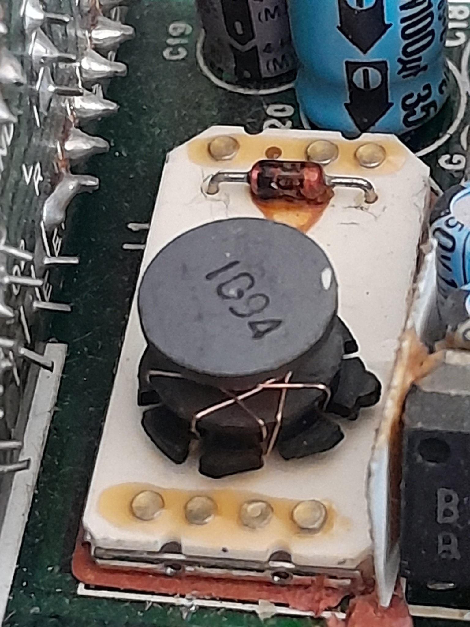

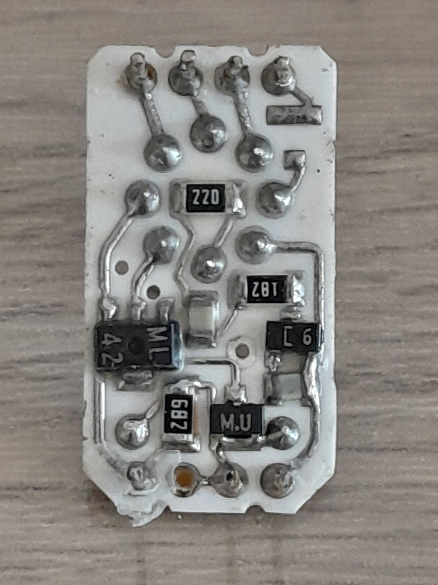

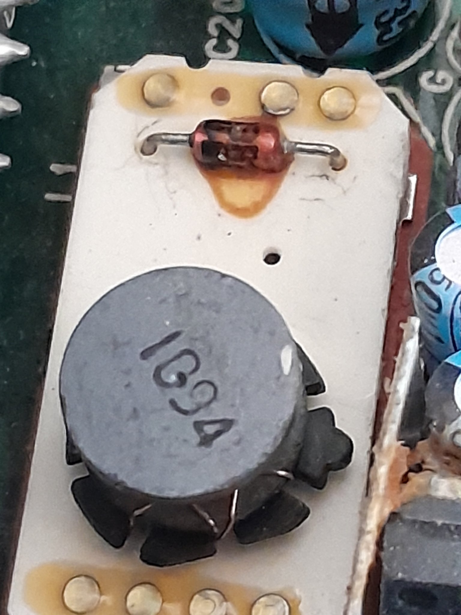

Hi I could anyone help repairing an old Pioneer FX-K9 component car radio cassette,
The dc-dc converter looks like it's failed, it there to power the display which isn't functioning, completely dead.
voltage readings on the dc-dc converter as follows
Pin no 1 0.040 v dc
no 2 0.359 v dc
no 4 12.76 v dc
no 5 0.040 v dc
no 6 0.040 v dc
no 7 0.040 v dc
no 8 0.001 v dc
the part number is obsolete so I'm looking for a possible substitute, does anyone have any experience or knowledge of working with this or similar dc-dc converters?
any help or suggestions appreciated.
I have a service pdf if required, thanks

The only thing that seems like it could be a problem is a possible bad solder connection on the lower capacitor. It could just be the shadow in the image.
Can you connect it to the board with wires to see (with a scope) if there is any activity (oscillation) on the board?
Have you checked the resistors for value and the semiconductors to see if any are shorted?
