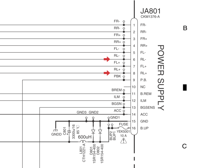

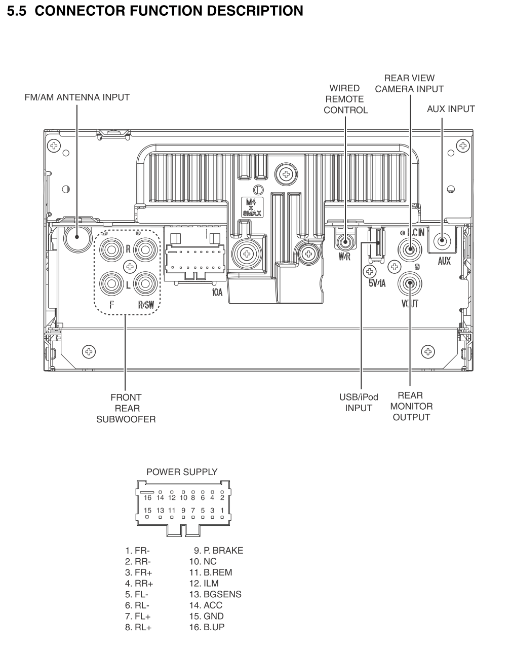

Light green? Page 36 in the owner's manual.
I found a better diagram in the service manual.
