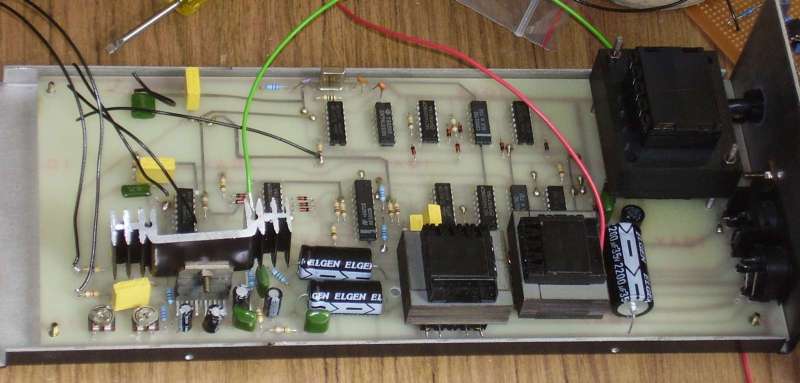

The two small pots on the right of the phot adjust the output voltage (one for each phase).
Ignore the extra wires attached to the top of the board, they were there so I could graft in a different quadrature generator which allowed adjustment of frequency, phase angle and cogging torque. Before you ask, no it is not available any longer and never will be again.
I had hoped I would see something that looked a little more professional, the level of quality IMHO is quite poor - not in keeping with the rest of the turntable design. The PCB looks very amateurish, and the poor execution leaves me questioning the quality of the design as well. The older version DC drive pcbs I had looked somewhat worse, but there were no mains level voltages present on that board. I don't think PT did electronics well at all...
Depending on how old this thing is it should probably be recapped, and I'd certainly see about boosting the voltage a bit. Note that you should try to adjust both phases so their output voltages are pretty close to the same. (90 - 100V depending on vibration)
I'd probably get some more reliable pots from the like of Bourns or similar as I've had some problems with similar pots in other devices - long term they're not that reliable.. IMHO

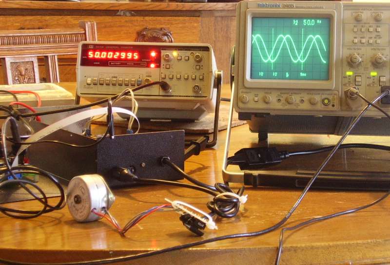

IIRC the frequencies are 50.0 Hz and 67.5 Hz
That would make the most sense and is pretty standard these days, in the other thread referred to a poster mentions 100Hz at 33rpm.
There is at least one seller on eBay that offers an electronic controller that is supposedly good.
As per phot, 50 / 67.5 Hz operation is confirmed.

You are right, the DC supply is a rough and ready cap input rectified supply straight off the trafo.
I doubt, however, that this is the problem for the OP. The troubles he reports are typical of those encountered when a two phase motor has only a single active phase. In this condition there is nothing to tell the motor which direction to turn, so sometime sit won't start at all and other times it will start but the direction will be random.
The wiring between the controller and the TT is every bit as rough and ready as the rest of the unit. If you have confirmed that both output phases are good on the board the wiring is the place to start looking. I'd disconnect the motor inside the TT and check for continuity from the controller. While you are there, check that the motor windings themselves show continuity.
