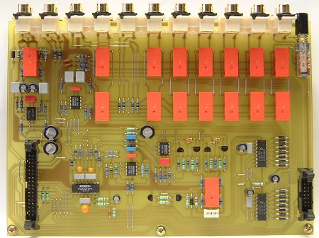

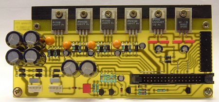

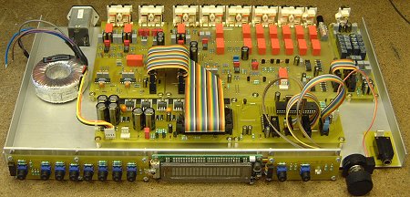

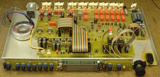

Thought that you'd be interested in seeing some pictures of my PGA2310-based preamp that I've been building. Full details are on my website - http://www.mhennessy.f9.co.uk/
I'm at the testing stage - so I haven't had a chance to critically listen to it yet. But, I'll hopefully be able to report back at the weekend...

Thanks for everyones comments - I'm glad you liked the pictures!
mlloyd1 - A friend at work has a simple milling machine, so I'm hoping he will cut the display window and switch holes for me. Should be nice and accurate...
However, I've been so impressed by recent pictures from Peter Daniel and others that I'm considering ditching the 1U rack case and try custom-making something!

Like your PCB's, must have taken you a while to design.

You're right, I spent ages on the PCBs. I quite enjoy it, I'm afraid! The main analogue PCB went through several drafts until I got something that looked nice, incorporated everything I needed, and felt electrically 'good'.

Can't wait to see some pics of the finished product! My vote: go for the custom case. You'll thank yourself later!

Yeah, go for a custom case. See what I meant good, old days. No displays then thou.

Peter Daniel: That was the thread that got me thinking about a custom-case! I'm very jealous of your aluminium skills - I'm sure I'll have lots of questions for you in the future
