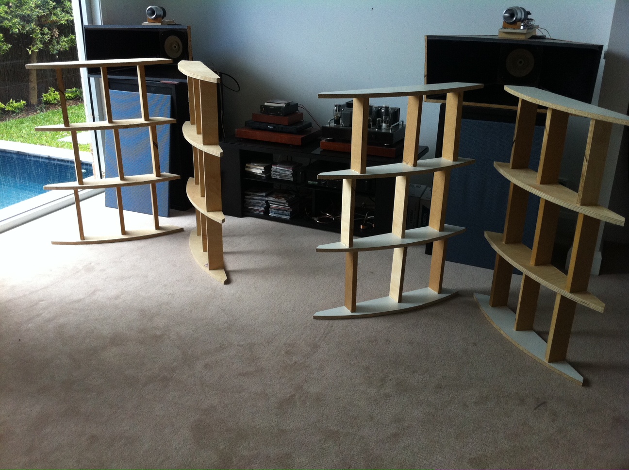

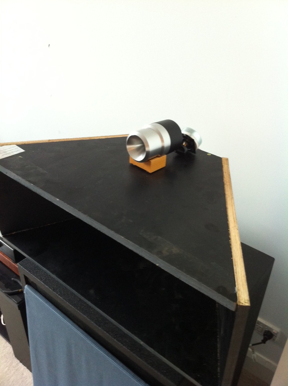

Current project is a 3-way 'Altec' horn system, featuring a radical mid bass open baffle 'horn' (wave guide) from Bert Doppenberg (of Oris fame).
http://forum.bd-design.nl/index.php?id=17004
Bert's design uses x4 15-inch woofers each side and is 9 feet tall...mine is the half version.
http://forum.bd-design.nl/index.php?id=17095
I will use x4 Altec GPA 416's (I already have two).
At this stage, mid horn will be the Eliptrac 400Hz, DIY with MDF. Driver likely Altec GPA 390.
Eliptrac 400
http://www.greatplainsaudio.com/downloads/390series.pdf
Tweeter horn is the Visaton TL16.
All fun stuff.

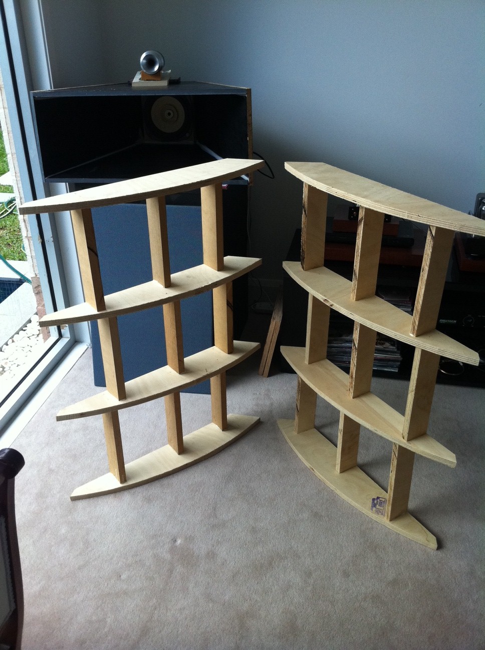

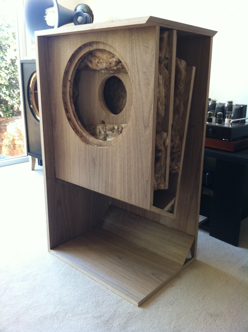

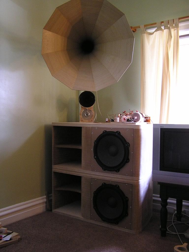

I've built heaps of speakers before, Tannoy GRF, Cornscala, Bill Fitzmaurice horn subs, Lowthers...plus designed my own radical C-Horn. I'm also a licensed builder for the Carfrae Little Big Horn. Have also built large bass horns for US GOTO rep, Ming Su.
See pics attached.

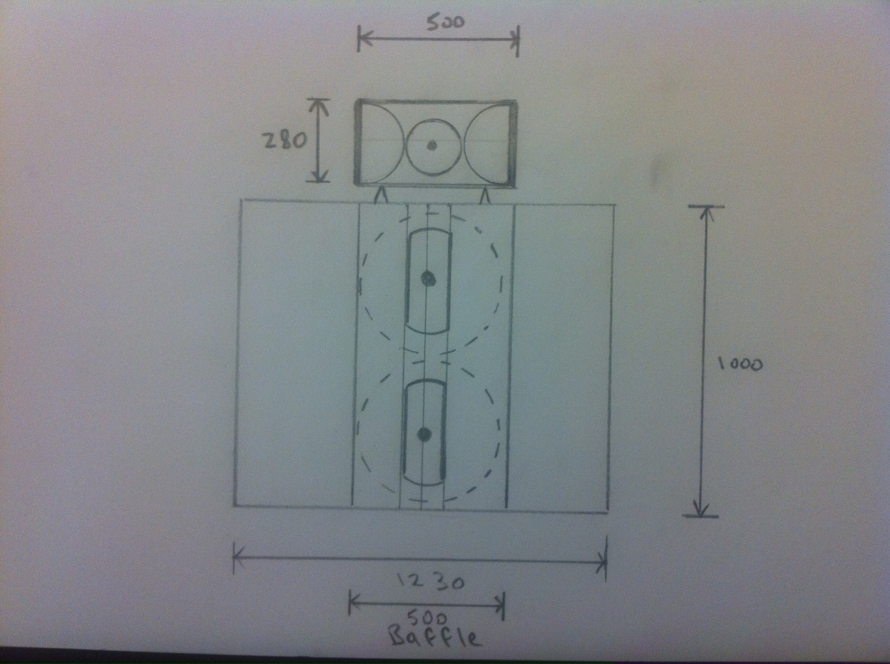

I hear you. I guess, though, there's something still quite appealing about the OB design...I think the aesthetics are very much a statement...just take a look at Bert's full 4-driver/side verison. Besides aesthetics, I would suggest little/no coloration from the design would be worth persuing....certainly that's the logic behind most people's OB goals. (Remember, the goal of this project was max mid-bass attack.)
As to the 416's vs Bert's woofers, yes, I accept the differences...but I'm confident about the outcome, as the 416 is such a versatile driver, and the flare is not dissimilar to the A5/7. For bass depth, either an EQ'd approach or separate dual tapped horns will be used.
What do you have in mind when you say, "an elegant 'statement' with superior performance to boot?"
Kindly
