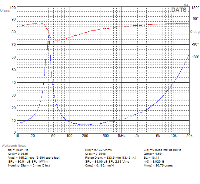

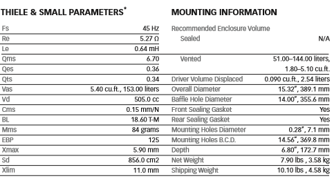

I ran free air and vas tests for one of the two drivers and came up with some pretty pronounced deviation from factory data sheet. (1 and 2)
Although BL is pretty much bang on. But Vas is way higher and Re is a bit higher.

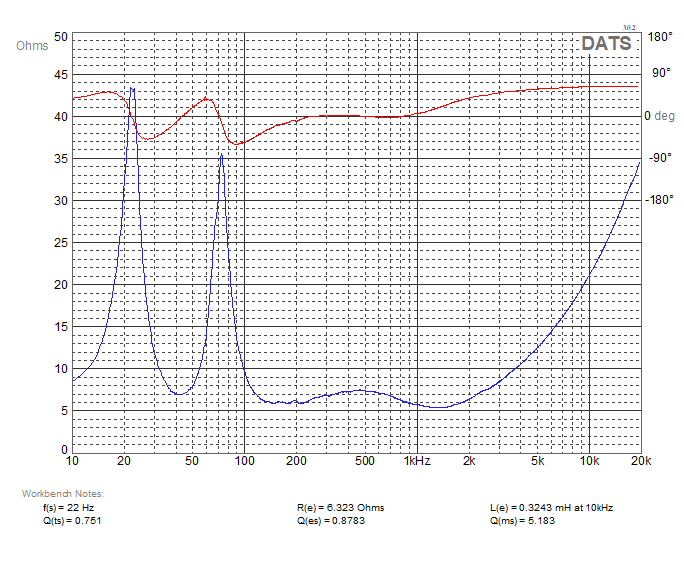

And then ran tests in cab for my 15/6 cab details of which are in my post 15/6 bass cab design. (thumb 3)

Is it possible for sustained periods of heavy use to impact the FA parameters like this? Or do I have a problem?
In the third thumb, 15.6 DATS, it says the Re is 6.323 ohms. What does this mean?
From this data on the 15.6, what would you say the nominal impedance of this cab is?

Vas is is proportional to suspension compliance which is a very hard parameter to control and varies a lot with temperature. Try doing the measurements at different temperatures and you will see.

Re represents the resistance of the voice coil. Resistance is one of the three components that can make up an impedance.
Is it not fourth components; resistance, inductance, capacitance and frequency?
One could argue the semantics either way... I think it is correct to say that impedance of speaker driver changes with frequency... and at a given frequency, impedance is made up of resistance, inductance, and capacitance.

DATS v2 here. Eminence Delta 10A also measures with a much higher VAS, lower FS (57hz rather than 66), slightly higher Qms, but RE is only a fraction higher. Qes is spot on.
