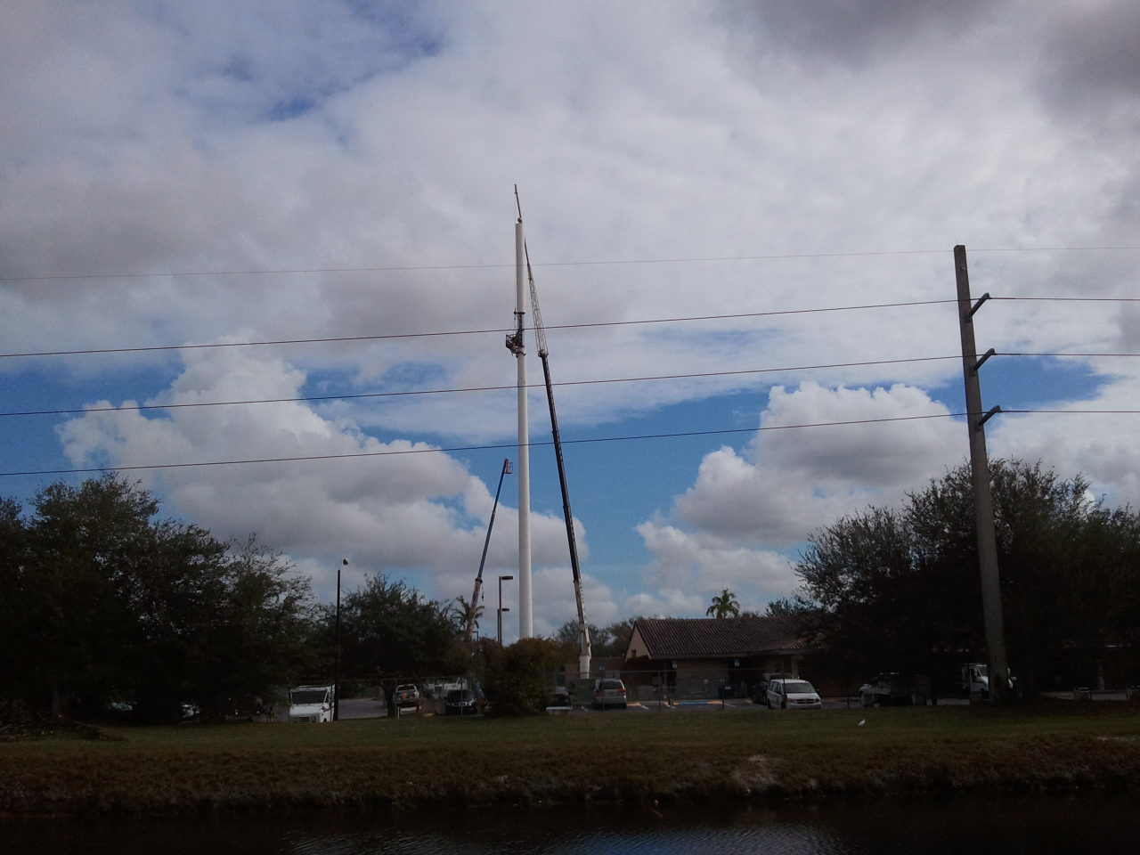

Somewhere in the mid 1990's the power company put in this set of 765 KV transmission lines right across the street from my house in Florida. As soon as they went live 160, 80 and 40 meters became useless. The "S" meter was pegged on 160 and 80 with only a loud 60 Hz buzz from the speaker. 40 was marginally useful on a cool dry night, which rarely occurs in south Florida. During the summer rainy season the only contacts I could make were from Europe in the early morning using JT-65 on 14.076 MHz. Much of my experimentation was done in the VHF and above region.
AT&T killed all use of 902 and 2304 by planting a cell tower right across the street. It also killed any hopes of EME contacts on the higher bands since the large amounts of AM modulated RF in the air required a filter in front of the LNA, raising my system noise floor by an instant 2 dB or so.
