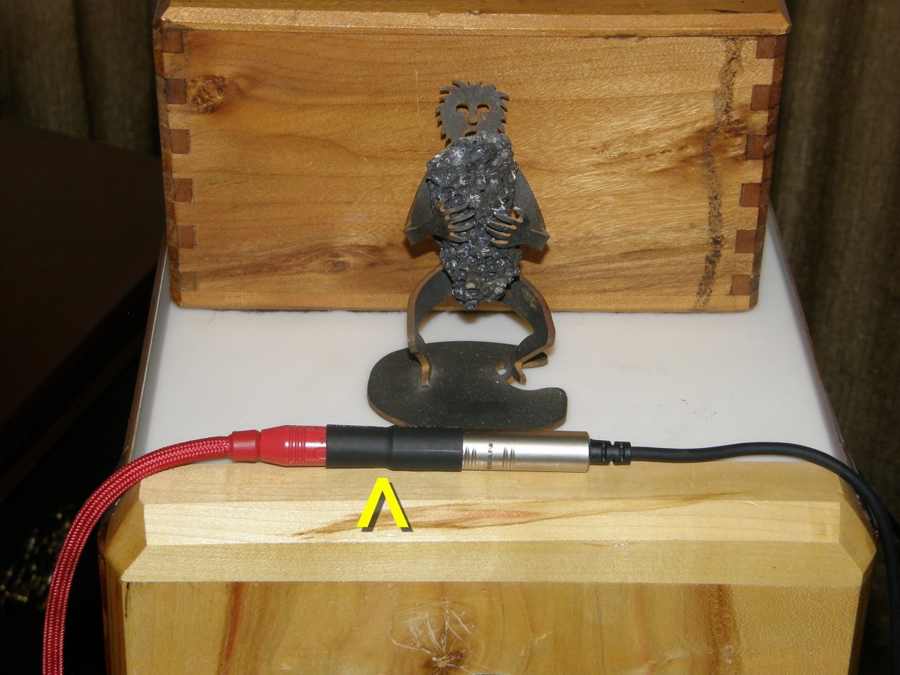

Then you wisely planned the heatshrink with glue, but with time since the red connector seems to be conical it could even slip out again (crossing fingers).
To avoid running 400 more risks why not cover the two connectors up to their constricted end?
Just sayin'...
Just sayin'...
I thought the same but after testing the grip that this double wall heatshrink has on the connection, I couldn't move it even a tiny bit. There are indentations on both ends that allow extra grip. The real answer is to get a longer headphone cable, but I already have $100 invested in the 10 foot cable that is being used.
I'm glad you did. 🙂after testing the grip that this double wall heatshrink has on the connection, I couldn't move it even a tiny bit.
