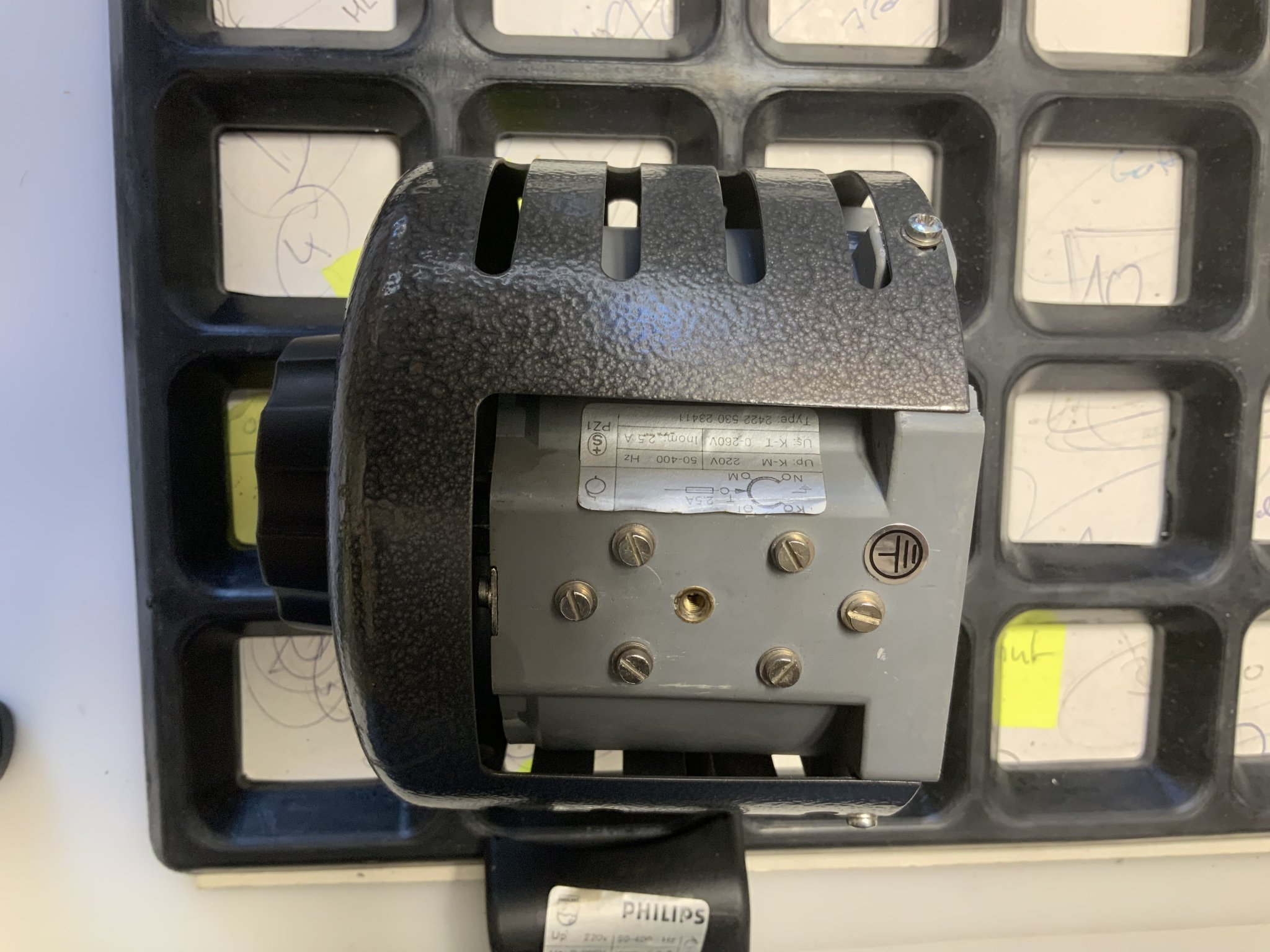

my Name ist Mat and I am new here and hope someone can help me to connect my Philips Variac type 2422 530 23411 the right way.
My question, where I have to connect the mains and where the variable output?
I think the left side is input and the right side ist output (the top screw in the middle and the right screw on the bottom) I am right?
Thank you so much for help.
Have a nice weekend!
Mat

You have the advantage in having it in front of you but none of those screws look like terminals to me.

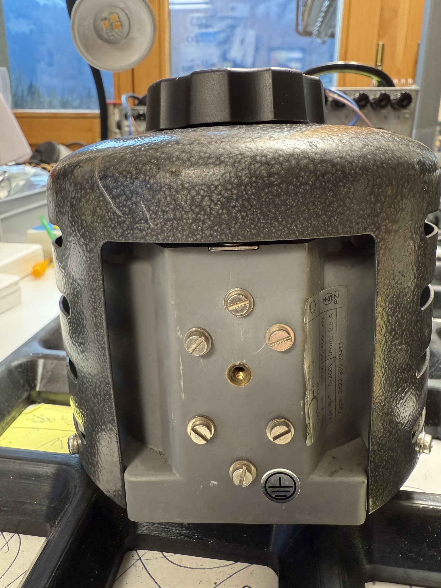

Sometimes it is difficult to identify the taps by resistance metering, but this is a 2,5 A variac Phillips/Filec ( the model lives on under other names obviously) so it is doable if you have a good meter.
The connections with the highest resistance is the outermost and I would recommend to connect these to the mains. The variac will then give you 0-100% of mains voltage.
It is possible to connect to the inner winding connections and then use it as a boost, giving up to 260V.
If you have low voltage AC output transformer, hook it up to two of the connectors (not the ground one) at the corners and measure the output voltage between one of the terminals and all the other connections.
Turn the handle and remeasure and you will find the wiper connector. I guess it is the center one.

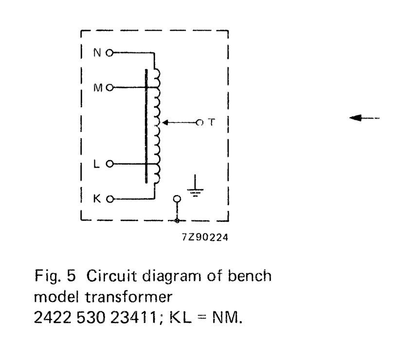

The layout in the photo of post #4 seems to be correct. This should be standardized for all the Philips Variacs.
https://bitsavers.computerhistory.o...6_C08_Philips_Variable_Mains_Transformers.pdf
page 50/144 (or 41 on the actual page) has the official schematic and specs of 2422 530 23411
So no more guessing.

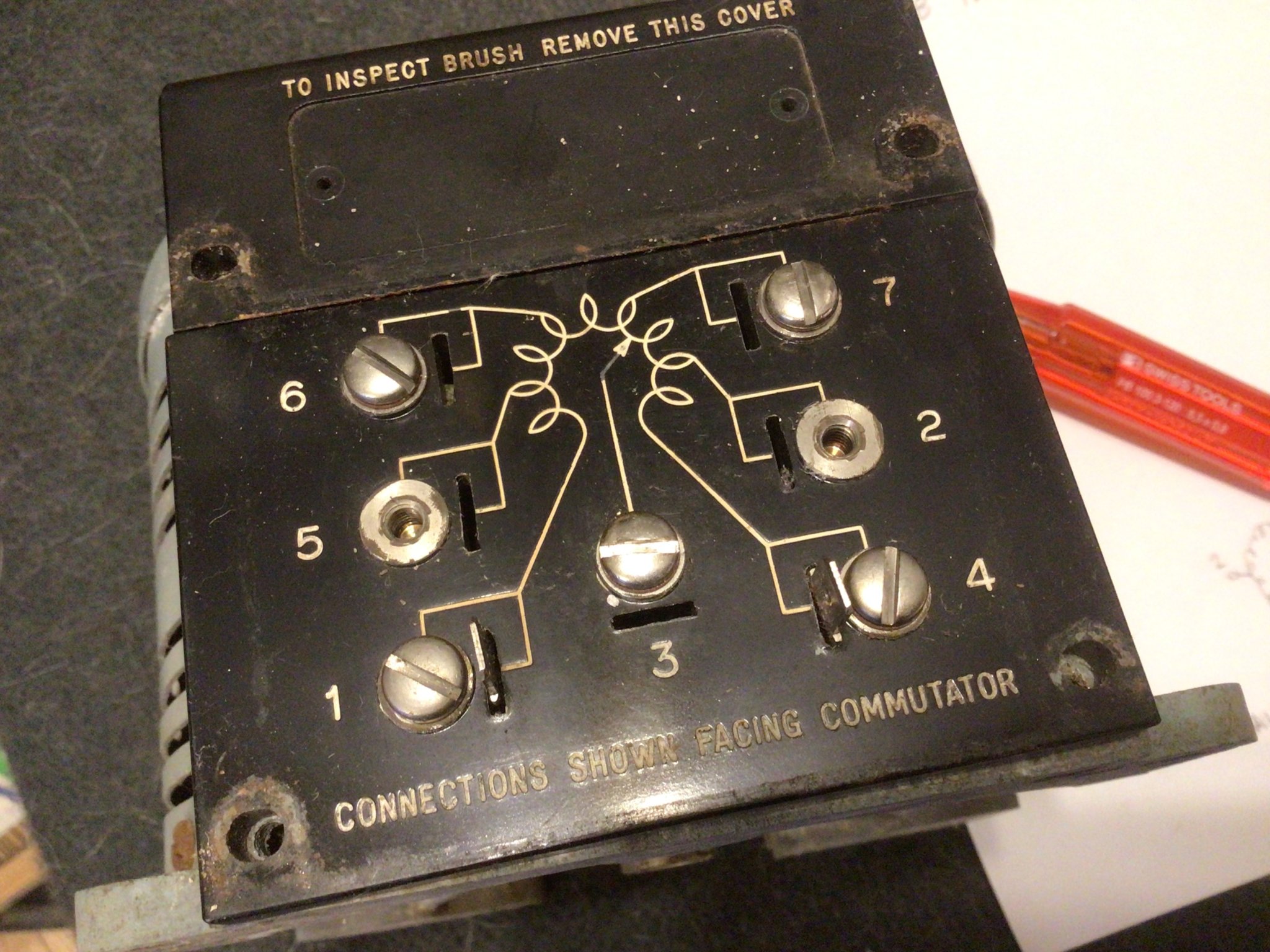

Mat, could you post another picture, this time taken more from the right looking in at an angle to better capture the label to the right of the terminals? Based on what I can see of it, it appears that the bottom most center screw is the earth ground, and the two just above and to its left and right are the winding ends. The topmost one is the wiper, and the two below and to its left and right are likely taps on the main part of the winding. I know US made variacs typically have such taps as they allow the unit to output voltage greater than the line voltage - e.g. the US ones are typically tapped such that with 120 Vac in, the extreme end of the winding is at 140 Vac.
This example of one made by Superior Electric in the US has provisions for four taps on its terminal block, but in actuality only uses the ones marked 6 and 7:

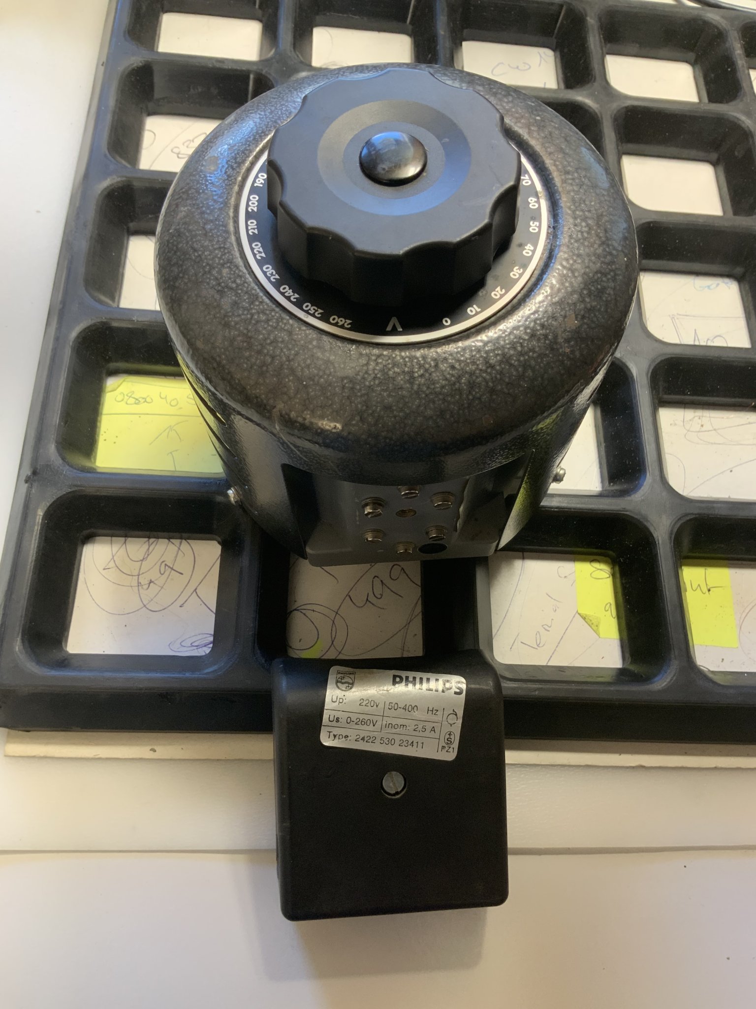

Does the voltage scale turn with the knob, with the reference a mark on the enclosure, or is it fixed to the housing and the knob has the pointer? I can’t tell if you turn the knob clockwise to go from zero to max or counterclockwise - it looks like the scale is stationary, so it’s CCW to go from 0-260. Is that the case?

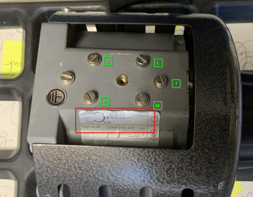

I think the pinout is shown on the label:
The middle pin is probably chassis (as shown in the schematic).
Easiest is just to take the cover off and follow the connections.
Second best is to measure the resistance of the winding with a multimeter.
edit: unfortunately the mechanical drawings in the datasheets above can't help us either for this particular model.... 🙁
edit2: an output fuse is still missing as well

You're welcome! 🙂Perfect, thank you!!!
Cheers, Mat
But please, do a visual inspection first, don't assume these connections just yet!
Also, unless you're planning to run devices on higher voltages, I would probably use the NK connection.
This seems to be 1:1 with the output, while the other other could give you an higher output.
On the other hand, that also gives you the ability to compensate for some voltage drop.
