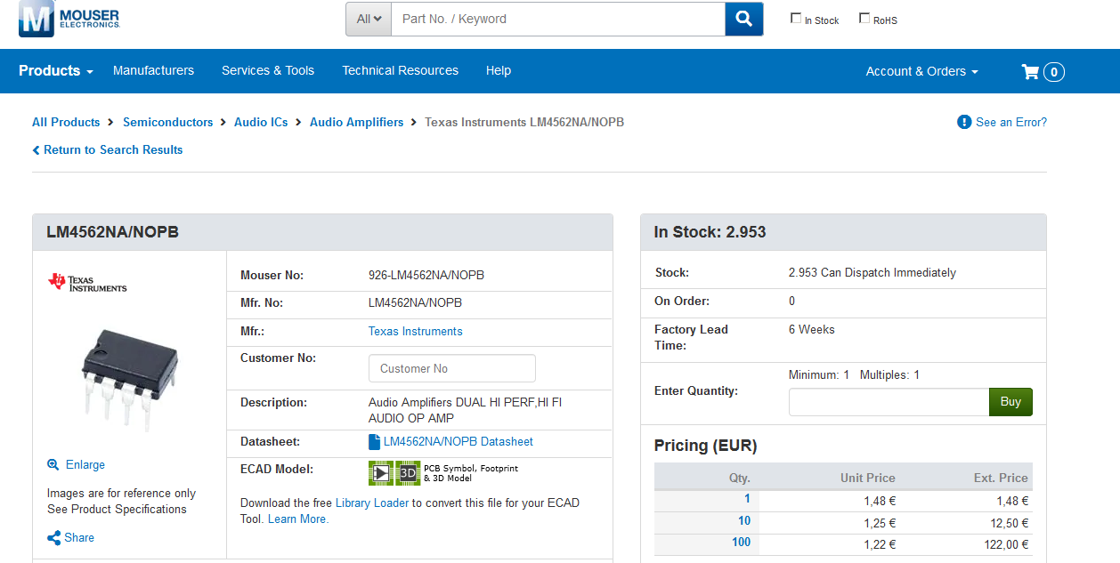

Can only find TI DIP8 ones.
By renouned distortion you mean the slightly higher distortion above 10kHz? Doug Self measures this as 0.0008% to 0.0012% at 20kHz, compared to 0.0007% for other brands. (2nd ed. of "The Design Of Active Crossovers")
On Semi SOIC8 ones on a SOIC->DIP breakout is a possible way to go.

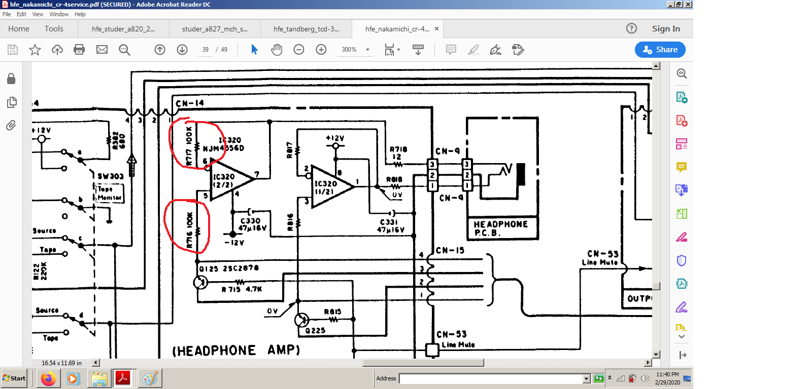

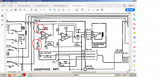

and those are really nothing but 741s stuck in a dual package.Yeeech!!njm4559 are low offset versions of njm4558...
...hence mediocre, at it's best, for audio…
That's excellent advice; thanks. I have had trouble in the past with 4562s, and never thought of doing that.But watch out for the RFI immunity issues - sometimes as a voltage follower the LM4562 can pick up radio stations if the inverting input is directly connected to the output (internal oscillations?) 100 ohm resistor in the feedback path apparently cures this. (As reported by Doug Self in his Active Crossover book)
really?!and those are really nothing but 741s stuck in a dual package.Yeeech!!
3 MHz BW, 1 V/us SR is much better than a ua741and those are really nothing but 741s stuck in a dual package.Yeeech!!
Not that different to a TL082
The Fairchild era RC4558 datasheet declares 3 MHz BW and 0.8 V/us TYPICAL
Not as good as the NJM part, but still better than a 741
The current TI RC4558 declares 3 MHz typ, 1.1 V/us min, 1.7V/us typ
This parts spec has been all over the place, but looking at some old CD and DVD player boards, the TI flavour is the one used.
I'm actually using the 1k max value prescribed for common mode canceling technique resistors in his "Small signal" book.For some njm's you can safely use higher values up to 100kohm depending on application.100 ohm resistor in the feedback path apparently cures this. (As reported by Doug Self in his Active Crossover book)
