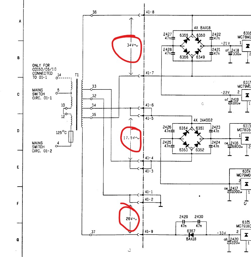

Measured all supply voltages and got kind of confused - it didn't measure +-9V, but +12 and -13V, which is very high for CDM, I think. So I (mistakenly, as I discovered later) thought there could be a problem with the power supply (transformer hums audibly), checked all, even changed the supply wiring to 240V (was 220V), didn't make a change, then I even built a little regulator circuit with LM317 and 337 to feed clean +9,5 and -9,5V to player, which turned out to be a waste of time - player behaved exactly the same way and the regulators would get hot, would need large heatsink, so I ditched this idea.

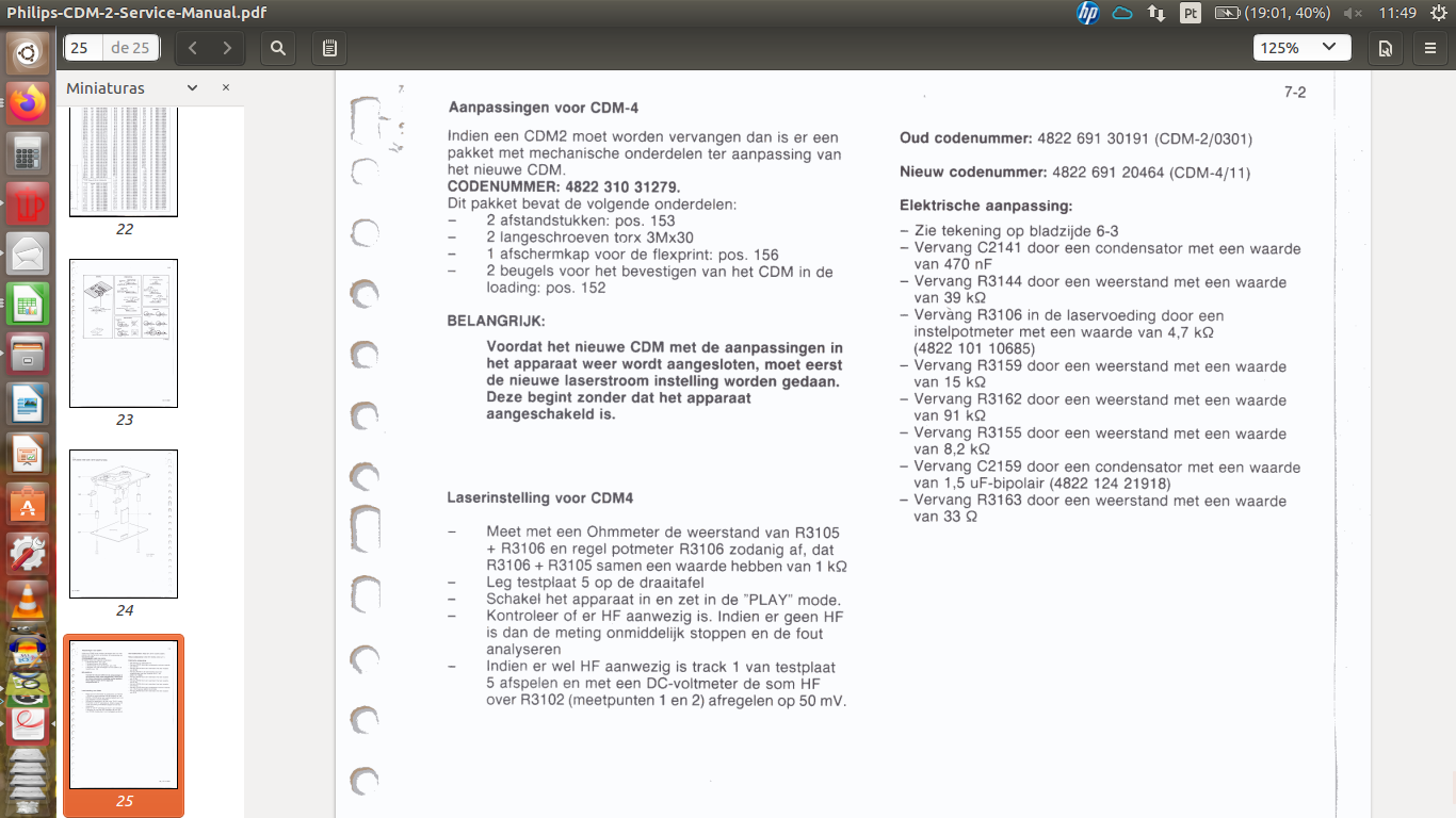

I got myself the service manual of CDM-2, but then actually found out that this player had received a new laser head, the CDM-4, somewhere in the past, as the servo board was CDM-2/29, if I'm not mistaken right now, but the laser is CDM-4. This was interesting and I actually found the part where Philips indicates exactly what has to be modified to be able to make the CDM4 laser work with the old servo board. I checked all of the adaptations, I mean, I didn't know the history of this player, maybe adaptation was made wrongly? But no, all was exactly as in service manual.
I was getting a bit desperate and was running out of ideas. But then I had an idea: what if the player would need to warm up to be able to play? As I had it on when I was measuring for quite some time! Well, I left it on half an hour. And guess what? It worked! Not perfectly, but would play here and there.
I then searched the internet for this and found the solution: it appears that Philips at that time used so called "griplets", which seem to be a very frequent problem on more well known players like CD104, for example, and can cause all sort of problems which generally go away when player is warm. What seems to happen is that the solder in those griplets (which connect one plane of the PCB to the other) has cracks and doesn't conduct well anymore, while with heat and thermic expansion, it starts to conduct better.

What I was most amazed of was the really high voltage of the unregulated rails, it's far off the values in the service manual (+12 and -13V), which is also far beyond what Philips states for the CDM transport (+-9V +2), I wonder why this was done... I mean, one can get pretty close with a transformer, even unregulated, so why would they choose a transformer with voltages that high?... could it have changed some of its properties over years, raising voltages? is that possible? I don't know...

Discrepancies in service manuals of that era were very common tbh so I wouldn't read to much into the value of the unregulated supplies. Nothing will have changed with the player in that regard.

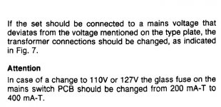

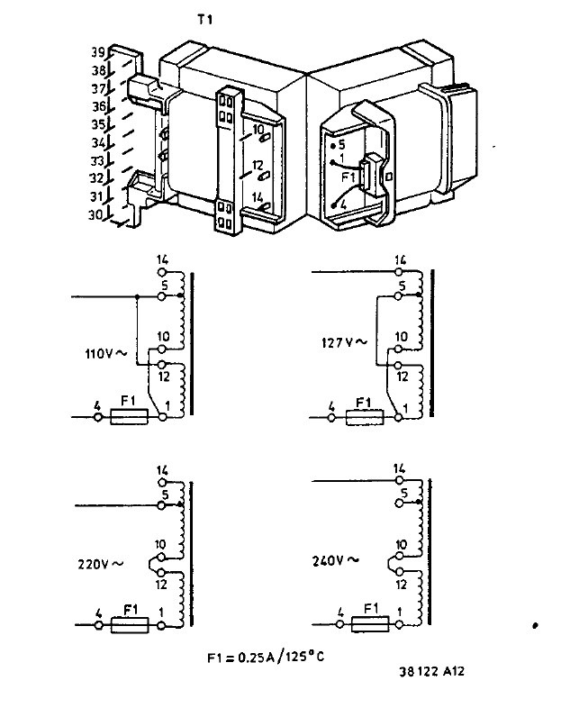

I have got the CD 150 yesterday, but the transformer mounts got broken in shipping. There is one Blue wire coming from mains switch circuit got broken from transformer side. I am unable to make out where this wire would connect on transformer. There are two wires on switch side Reb/Blue, Blue one is detached from transformer. I tried to find online pic but there is on cover on transformer for the wires, so I can't make out. I have also downloaded the manual, but not sure where to solder this wire. My CD player is 220V version. It would be better if anyone send me pic of his 220V version.
Please find below pic of the wire and connection. Please help.

You will have to follow the connections detailed in the service manual.
I would recommend that you identify the windings with a meter on low ohms range if there is doubt. When you think you have it correct disconnect the secondary plug and switch on and check the AC values on the secondary look correct. Remember they will be a few percent higher with no load.
That helped. The wire actually belongs to the bottom of transformer. It powers up nicely. I am now facing some issues. It's playing alright on some CD's giving err on some tracks, and not playing some CDs at all. What should be the issue? The transport is also noisy while loading/ unloading the CD, and at the start of the CD. It sounds very good BTW.By expanding your second photo I think that the blue wire was connected directly to the bottom terminal that has the two transformer winding wires going to it (in a vee). This is further evidenced by the 'crush' marks on the blue wire.

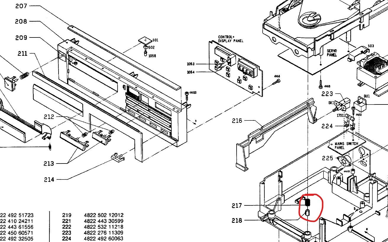

There was some small spring with Black soft plastic inside fell from CD player, when I tilted the CD player to remove the bottom screws of transformers. I have read the service manual and it looks to be from switched, but my every switch works properly as it should. Can any one help to locate the place for this spring.
Regards
Sachin
They are the suspension for the mechanism. I think there is one in each corner. You will have to lift the mech out to access them (takes seconds).

I took the swing arm including laser from a Magnavox CDB500 with cdm4/19 and installed it in place of a defective 2/10 in a Philips CD160 some 10 years ago and it is still working. The only change I made to the Philips was to adjust the laser current and grind a bit of the swing arm to allow necessary clearance.Hi,
nice Job! Please confirm: A CDM-4 can run with circuitry made for the CDM-2?
But needs some mods that were documented by Philips?
