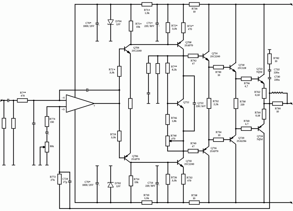

here you have, a not too much old, schematic diagram.
The missed parts depends you source impedance and your own decisions about...the chip is TL081 or other op amplifier...the feedback network must obbey op amp datasheet.

Interestingly the output is quasicomplimentary and requires beta matched parts. Not for the faint hearted!
Another thread here Wim Schilperoort found replacements for most devices
@earlrapp - did you ever get around to answering Tandbergs query on what the actual output devices where? 355N1
- Philips AH578 shematic
