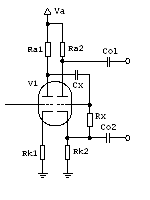

Hi to all
Can I call this Splitter Catodyne?
A complete scheme can be seen here (use Acrobat 6.0 or more):

That is a very poor circuit, IMHO. There is no way a 12AX7 concertina splitter should be driving parallel PP EL34s in UL mode. Putting a 12AU7 common cathode amp stage on the front is a bad idea because of the tube's poor linearity and the splitter's bias circuit is wrong too.

jane said:This is one of the few split load inverters I have seen with grid leak bias.![]()
Jan E
AndreasS said:Probably this is a mistake of the schematic: R23 is to small for grid leak bias.

In the scheme (k4040) I see a 0V grid polarization.
Also ECC82 as preamplifier and ECC83 as Splitter
This other scheme seems me correct, ECC81 with R12

The ECC83 split load as given will give a maximum peak signal output of about 40V before it runs out of steam (quickly hooked up) - and that is at quite visible 2nd harmonic distortion on the scope. (A 47K plate load in parallel with only 110K next grid resistors is looking for distortion.) Then grid-leak bias only works well when fed with a low impedance source. A feeding ECC83 is definitely not, apart from the grid leak resistor being too low - at least 10meg should have been there. Or it could have been direct coupled, although hardly successfull with an ECC83. I have said in the past that I do not see the ECC83 as a good choice for any kind of duty in a power amplifier. A pentode input to low mu triode phase-splitter would run circles round the above (ECF80, ECF82, 7199 etc. - and no comment from the "pentode-is-noisier" clan. That is in theory; certainly not audible in this kind of application.

The ECC83 (EF86, triode of the ECL86, ECLL80) are tubes, that can work with grid leak bias.
So this concertina phase inverter with grid leak bias we also meet in other amplifiers: Revox G36, Telewatt VS55, Grundig NF10.
The datasheet for the ECL86 (triode) gives an output voltage of 9 Volt RMS with THD 0,4%.
Regards Andreas
Regards Andreas

The problem is that I don't succeed in quantifying well the
total polarization of grid leak...
How can I simulate this with spice ?

Can an ecc83 pilot a double couple of EL34/KT88 in optimal way?
tnx !
Gold_xyz said:Which is the advantage of this circuit?
Advantage I don't know..., this phase inverter needs a low impedance driver (< 40 kOhm).
Gold_xyz said:Can an ecc83 pilot a double couple of EL34/KT88 in optimal way?
For small output tubes with high gm (EL41, EL84, E80L) may be used..., for EL34 or KT88 this phase inverter IMHO isn't a good solution.
Regards Andreas
It is not just a question of whether grid-leak bias will work (at all), but how well. I have no reliable model for the ECC83 for Spice, but my Philips Tube Data Sheets show the following comparative data. (The ECC83 is quite similar to the triode of an ECL86).

The question comes up: Why this almost fixation with the ECC83 in this type of circuit in many power amplifiers? If one insists on this, the ECC81 will be considerably better, at the penalty of slightly lower gain. But there still remains the matter of Miller capacitance for the first stage, unless a low input impedance (lower than most volume controls seen there) is used. With due respect for other designers, I rather fear that the operation of the ECC83 is not well understood if used in this application, at least for uncompromised quality. Spectrum analysis (harmonic content) of such instruments is revealing.
This explains my choice of a pentode-triode (moderate gain) here, as said. Yes, if one wants to use the ECL86, making use of the given triodes, than condition 3 above. The grid-leak bias method is to my mind specifically for low output conditions (pre-amplifiers), under the above conditions, because a low enough feed impedance is not always feasible (certainly not another ECC83 triode, anode fed).

ray_moth said:What makes people think there's supposed to be grid-leak bias in that design? That would be weird, to say the least! Isn't it more likely to be simply an error in the schematic?
In the case of Velleman, the actual PBC layout follows the schematic.
It might be an error in the first place, but the error follows the production line to the end product.
Jan E
http://www.adrian-kingston.com/images/Velleman/k4000.pdf
This have the same Grid leak Catodyne Splitter
In the next projects of Velleman the scheme has been modified.
see K8010 and K8011
