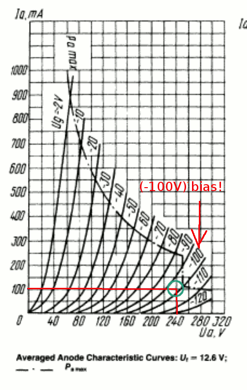

I wasn't familiar with the 6S33, so I downloaded its datasheet and took a look. Mu is only 2.7, which is an indicator of problems to come when the intended use is audio (guitar) amplification.
The datasheet shows that weird things happen to the allowed maximum anode dissipation just above 240V DC, so that seems like a reasonable upper limit to B+ voltage.
With 240V on the anode, it takes (-100) volts (!!) of grid bias to bring anode current down to 100 mA (24 watts anode dissipation.)
This suggests you'd need about a 200 volts (peak to peak) input signal just to drive the 6S33 to full clean output.
Nobody uses guitar amps 100% clean in 2019, so you'd need considerably more drive signal than that, to overdrive the 6S33 even a little bit.
You might just barely pull that off if the driver is a small-signal pentode, running on the same 240 V B+. A driver triode is out, unless it has a separate and much higher B+ than the 6S33 itself.
With an input signal of some 240Vpp, and a maximum output signal at the anode of less than 480 Vpp, voltage gain of the 6S33 stage is less than 2. Add in the step-down ratio of 8.7:1, and voltage "gain" is about 0.23; call it -13 dB. It's an attenuator, not an amplifier.
Because the output stage attenuates rather than amplifies, you need massive voltage gain in front of the 6S33, to bring up the relatively tiny guitar signal to the whopping 200Vpp needed for full clean output, or more realistically, to maybe 300V - 400Vpp to allow overdrive.
Using the typical Fender spec of full output at 20 mV from the guitar pickup, you'd need a voltage gain of x20,000, or +86 dB.
This would require a minimum of three cascaded half-12AX7 gain stages (or better, one 12AX7 followed by a small-signal pentode driver), along with a low insertion loss tone control design.
Even if workarounds can be found for the MOT-as-output-transformer problems, the design of the rest of the amp is a bit like an attempt to touch the back of your heels with your nose. It is not impossible (for a contortionist), but it would take a lot of hard work for rather small eventual rewards.
