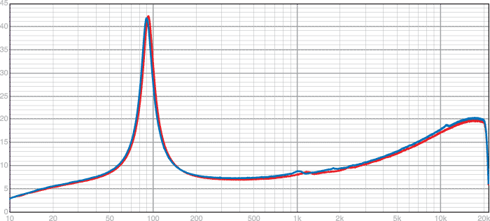

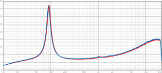

Here is an impedance magnitude graph (RSC 8" FR)
dave

> a speaker whose impedance varies with changing loads.
Wait a minute. What "changing loads"? The air-load is essentially constant. You can shift it a little in the bass with corner placement, or box venting, or horn loading. But corner placement effects are small at the amplifier, and effective horn-loading is a completely different design.
SY> Speaker impedances ... vary with level
Yes, when the coil starts to come out of the magnet gap (huge excursions) or when the copper gets so hot its resistance rises (high average power). When the coil does start to come out of the gap, back-EMF and impedance drops; but not lower than the midband impedance. If the coil actually comes out of the gap and bounces back, huge oscillations are possible, but this is speaker abuse, more than amp-abuse. If a speaker is designed to work to the edge of the gap and beyond, as in competition car-sound woofers, the designer will balance a bunch of factors, including the ready availability of cheap (transistor) amplifiers. A tube amp may not be the wisest pick for throwing a woofer that far; but few tube amps have the power to really get crazy that way.
So I don't know what mojo's quote means.
The commonest impedance variation is with frequency. I took dave's plot of a very typical full-range speaker, assumed it was flat with a modern zero-Z amplifier, and plotted for several non-zero-Z sources for DF of 8 to 0.25.
[IMGDEAD]http://headfonz.rutgers.edu/sp-Z-dB.gif[/IMGDEAD]
You see that a speaker with perfectly flat voltage response but a bumpy impedance response will have "errors" with a non-zero source. (OTOH, you can design a speaker to be flat with a hi-Z source, and it will be bumpy with a zero-Z source. Most "good" speakers before the mid 1950s were tuned for significant source impedance, and sound blah on a zero-Z source. As an extreme, Nelson Pass is working/playing with high-Z drive and selecting and tuning the speaker to suit that condition.)
Since you have a VOLume knob and will trim any amp to a "reasonable" sound level, I have corrected for average output.
DF=Infinite is the modern standard, and I've assumed it is "flat".
DF=8 would be a transistor amp with long thin wires (typical BestBuys stuff) or a light-feedback tube amp. It gives +/-0.5Db errors.
DF=2 approximates a naked triode. Errors are OTOO +/-1.5dB. The bass-bump and top-rise may be pleasing.
DF=0.5 seems to be about right for UltraLinear without other NFB. DF=0.25 is getting into naked pentode territory. Both of these give an obviously boomy one-note bass for a speaker designed for large DF. However this and the top-rise may compliment the limits of a single-driver full-range system, by boosting where it starts to fall.
