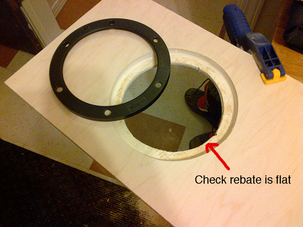

I always drill pilot holes and fully screw one of the provided hex-head screws into each pilot hole (and back out again) early in the process. This eliminates the risk of cracking the wood (not much to work with!) and dramatically reduces the risk of slipping and pushing the screwdriver through the cone during installation.

Glad you're making pilot holes. When time permits me to make boxes (very rare alas), I always recess the drivers and make pilot holes. Always best to employ this method.
While you have the opportunity, please check the flatness of your rebates (see pic). Make sure they are accurate. If there is some minor variation, use a little silicone or rubberised sealer (the sort used on windows, bathrooms etc) and GENTLY screw the driver into position taking care to "nip up" the screws. They don't need to be very tight, just enough to secure the driver. Don't use a power-screw driver to do this operation. Use a hand tool so you can "feel" the bite of each screw.
Use a flat steel ruler and eyeball the flatness of the frame fit into to baffle. Adjust individual screw tension to achieve frame installation flatness.
Apologies should you already know all of this, its good to remind/help newer members reading this thread. So I much welcome more posts from you.
