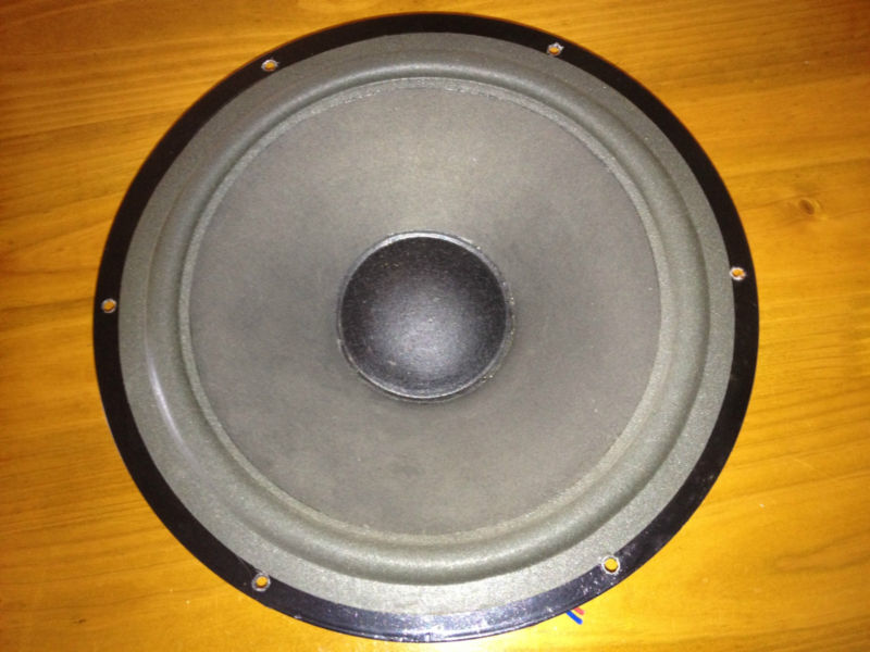

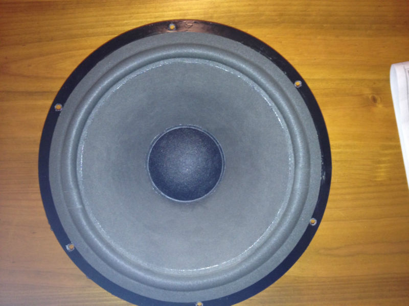

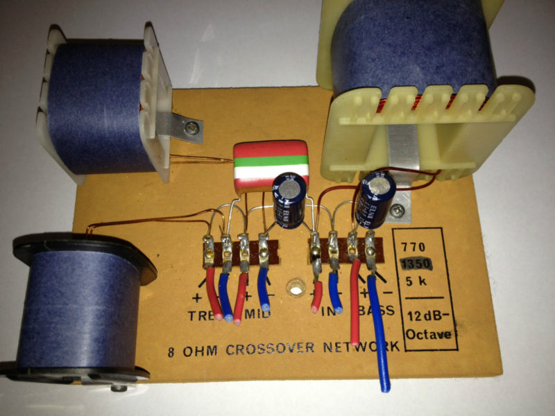

Hello there, I am just wondering what these speakers are all about. I got them off an auction site today but I reckon they are from the 70's and may not have any pdf, graphs or data available. I am just hoping someone may recognize them. I will try to upload the pictures so you can have a look.
The bloke that sold them said they have been re-cushed in the past and that they were in 100lt boxes. the same fella was selling a 3-way Xover that I guessed may have come from the same enclosure.
The original speaker manufacturer is unknown to me but the Xover the chap was selling is a very basic 2nd order job with intersections at 700Hz and 5kHz. - see the piccie

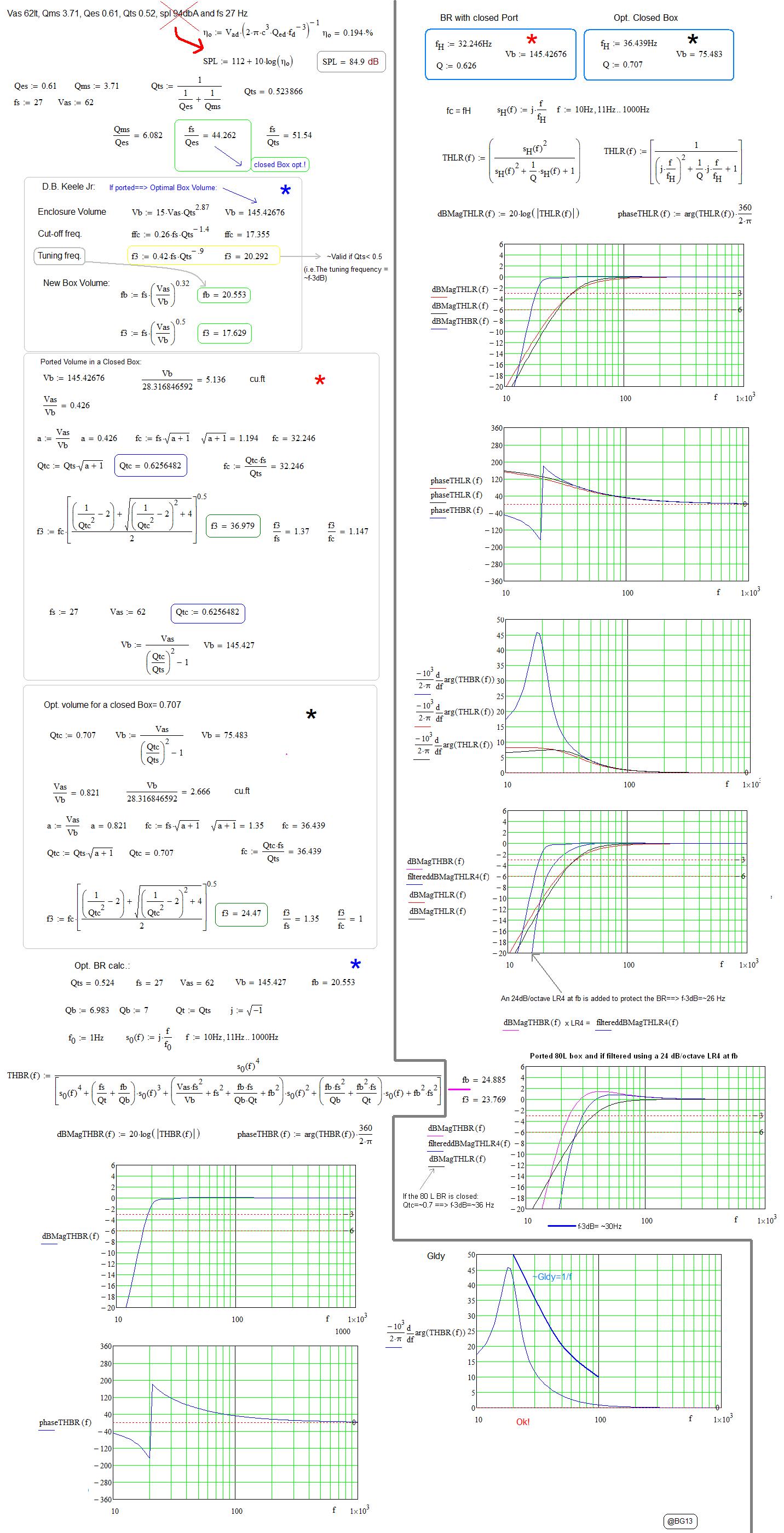

OK, I have roughly determined the t&s small signal values and they are; Vas 62lt, Qms 3.71, Qes 0.61, Qts 0.52, spl 94dbA and fs 27 Hz
These results a back-yard estimates and not entirely accurate but they give me a good starting point. The fs figure is wrong because they resonate at ~ 25Hz, but the calculations told me that it was 27Hz.

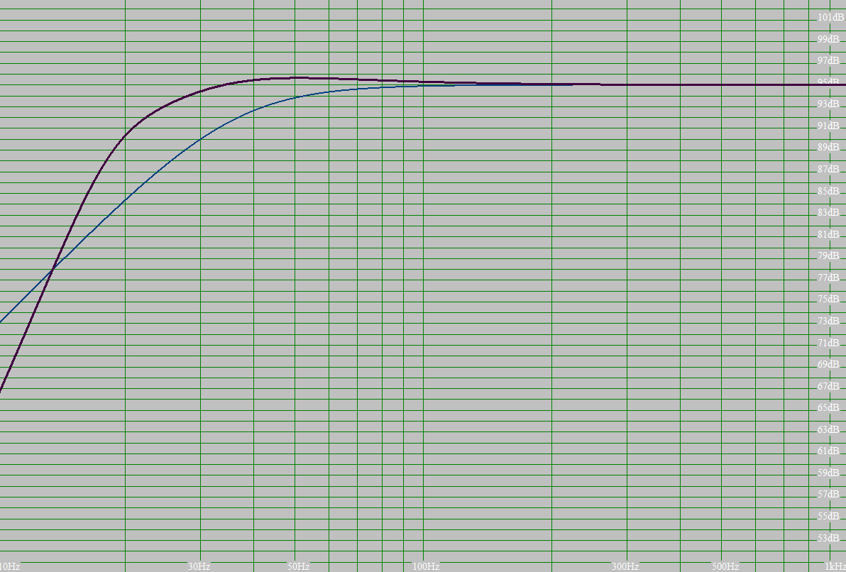

Question? Take a look at the two plots added in the picture below, the volume of the boxes I want to use is 84lt or say 80lt for a vented enclosure. Consider the age of the speaker (33years but reconed say 10 years ago). Look at the ported model which has the higher spl down low in the 10 - 30Hz region. Now, can you tell me if this will over-extend the speakers suspension and damage the voice coil former with the dire implications of such a stress?

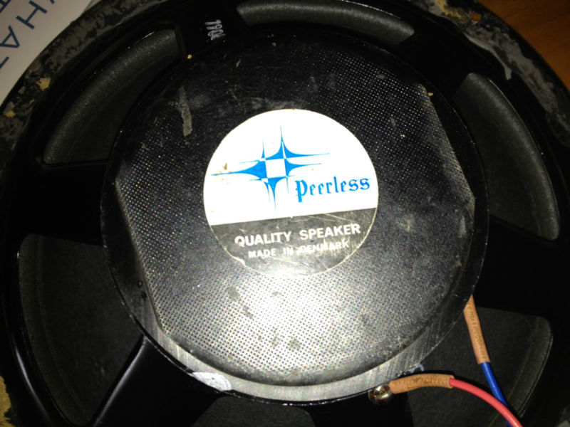

For your Reference I now know that the speakers were part of a kit marketed in australia back in the eighties, the 'PAS100' and as the name implies the bins were 100lt. They were a sealed type of box.

..Question?.. spl down low in the 10 - 30Hz region. Now, can you tell me if this will over-extend the speakers suspension and damage the voice coil former with the dire implications of such a stress?..

The magnet has a flux density of 11,800 gauss and my home made meter measures 560uH at 2.4kHz and 660 at 240Hz, if this is a help.
I put your figures into my box program and I am surprised but they will deliver really good bass in a 100 litre box, but assuming an X-max of 4mm they will handle about 15 watts to give you that 97dB and an F6 / F10 of ~26 and 20 Hz
Using a smaller box of 50 liters you would not loose much in the way of extension and you would be less likely to damage the driver by over driving, it they were mine I'd use a 50 liter box heavily stuff with fiberglass
Using your figures a ported box will be huge at 180 liters and have problems below 40Hz

I concur with the graphs posted by Bjorno, DCR VC diameter, X-max or the magnet gap and plate thickness are all needed to give approximations of power handling and SPLs. I used 4mm as my experience says that is a safe approximation and typical of woofers of that decade
It would be far better to relate how the T&S parameters were obtained and if they then can be verified as true for that particular model,then it would be easier to offer advise with confidence. The specs as stated,suggest a sealed box is your most likely candidate
Resolution - Sealed Box

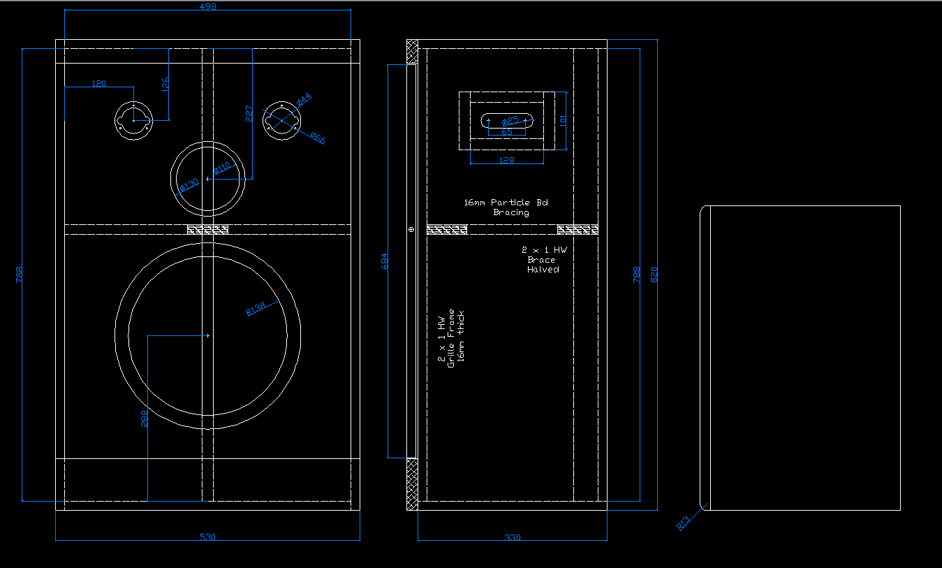

Mate, I think you are right, in fact I drew up an enclosure last night, see below.
I have a few options for mids; an open frame 6.5" woofer (too much hassel I think as it will require more joinery), A jaycar CM2085 polycone, or CM2090 1.5" domie. The latter has some limitations I think, so I reckon I will go with the old-fashion CM2085 sealed unit which is rated at 95db so I will put a 1.5db cut on that also.
There are a few options for the high frequencies, including a CT2010 1" dome, a pair of 8r foster titanium domes in paralell (with the assosciated impedance drop at hf) or my preferred option of a pair of 4r vifa ring radiators XT25SC90-04 in series to give the finished speaker a minimum impedance of around 7 Ohms across the entire spectrum. The vifa's are rated at about 90db so a pair will make their presence felt.
At the moment I am thinking about a second order Xover all the way through from ~ 800Hz to 4kHz. That is a low pass for the woofer, bandpass for the middie and high pass for the tweeter. I am thinking about reversing the polarity of the signal to bring the whole caboose back into phase.

What ever you do, don't use that POS sealed back jaycar mid.
That Jaycar tweeter is actually OK if you cross it around 3k tho and I would keep to single tweeter.
