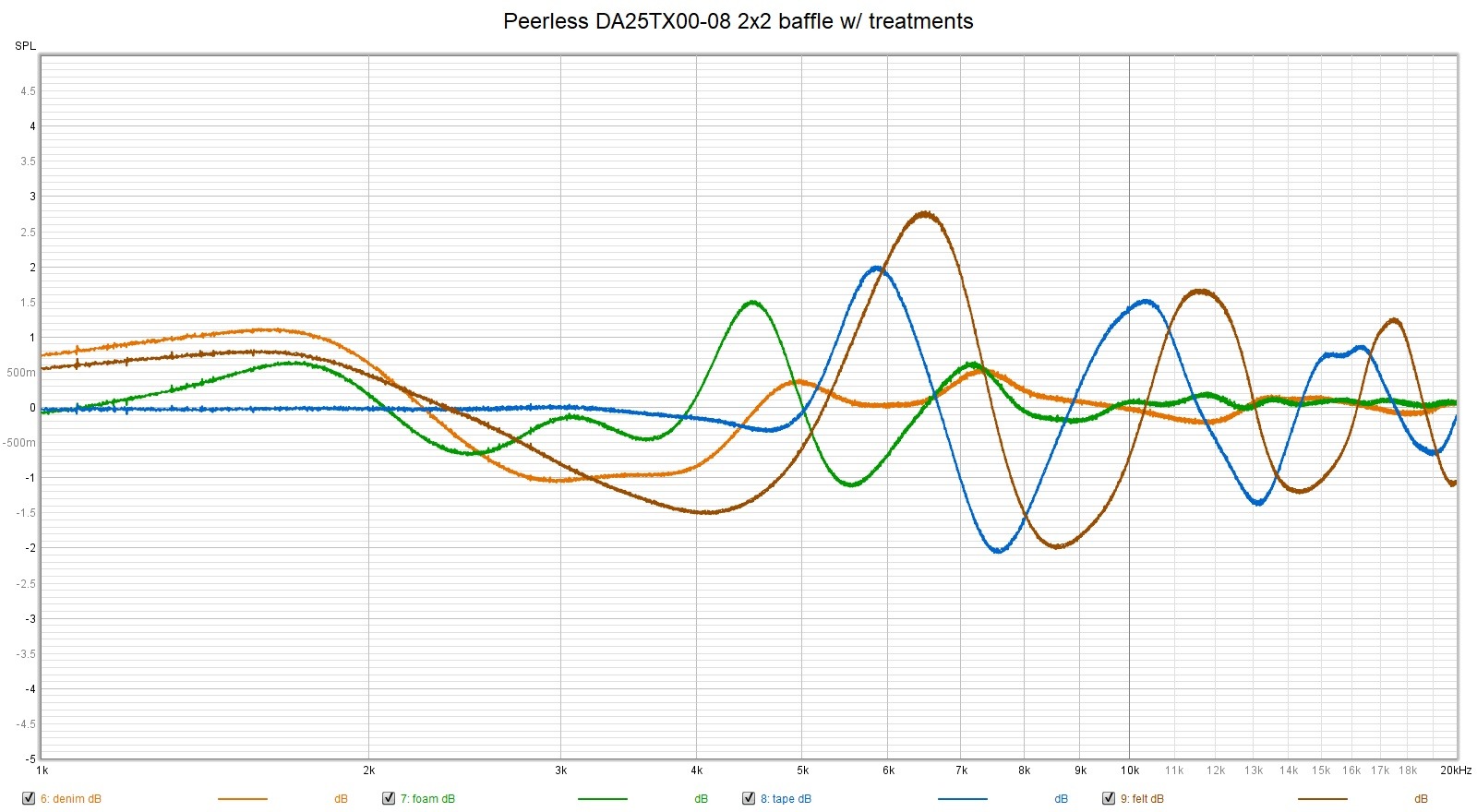

Before deciding to run the Jordan JX92s full range, 2-way designs were tried with both this tweeter and the HiVi RT1C-A. The Peerless/Jordan combo crossed over at ~1300 Hz measured technically excellent but was a bear to get there and sonically didn't do it for me. Following up on why, a few different simple baffle treatments were measured to see if something was just missed in implementation. Maybe so. The Peerless sends so much energy orthogonal to its axis that even its 1.5 mm front plate 'baffle step' apparently requires careful consideration.
The composite graph below shows the frequency response deviations caused by the different treatments versus a bare tweeter. The big surprise is the felt sheet, a lot of wreckage for an absorbent pad 90 degrees off axis. BBC-style felt looks pretty good. All plots were time windowed to remove the effect of the baffle edge. The only hint about the felt sheet's impact is a significantly increased spike in the Energy Time Curve.
A Jasper Jig is expected today to recess the tweeter for optimal testing. If it improves on its already +-1 dB response, given the very low distortion it may get a second go with the Jordan.
Suggestions welcome or feel free if you want to see some of the other measurements.

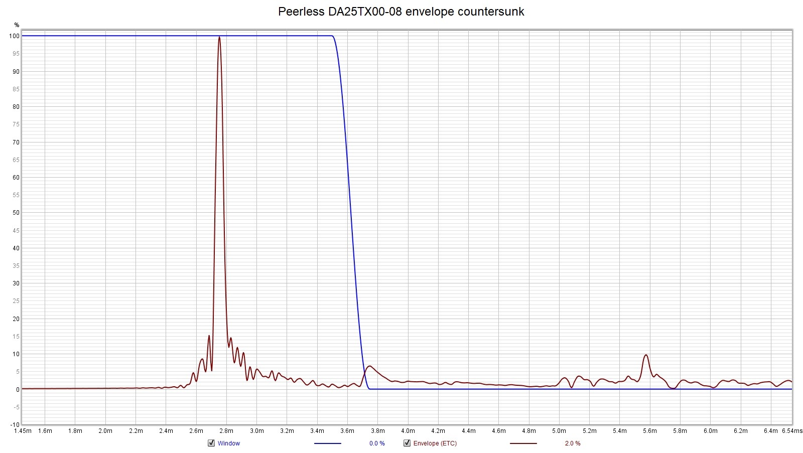

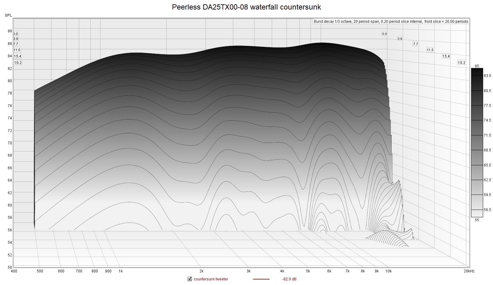

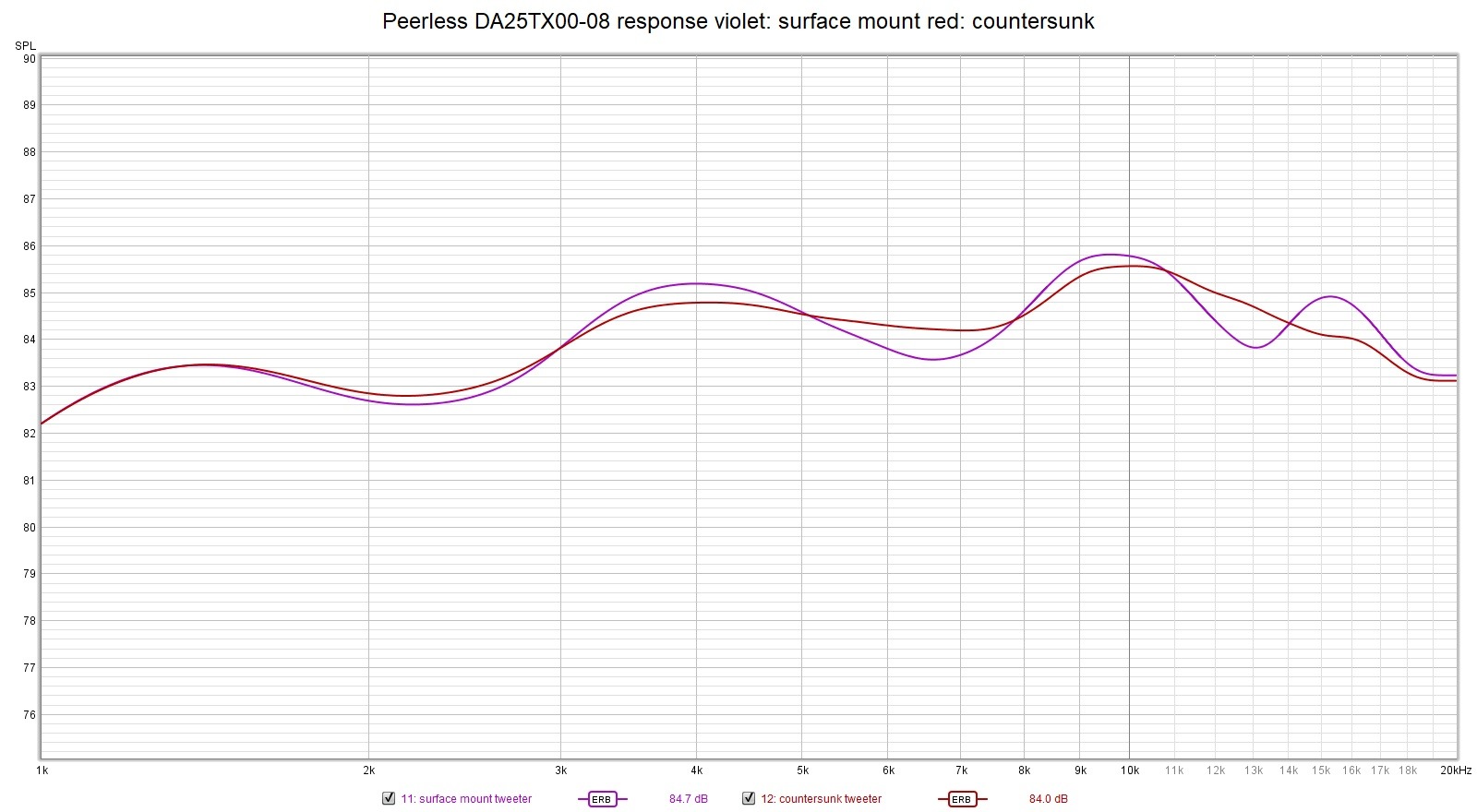

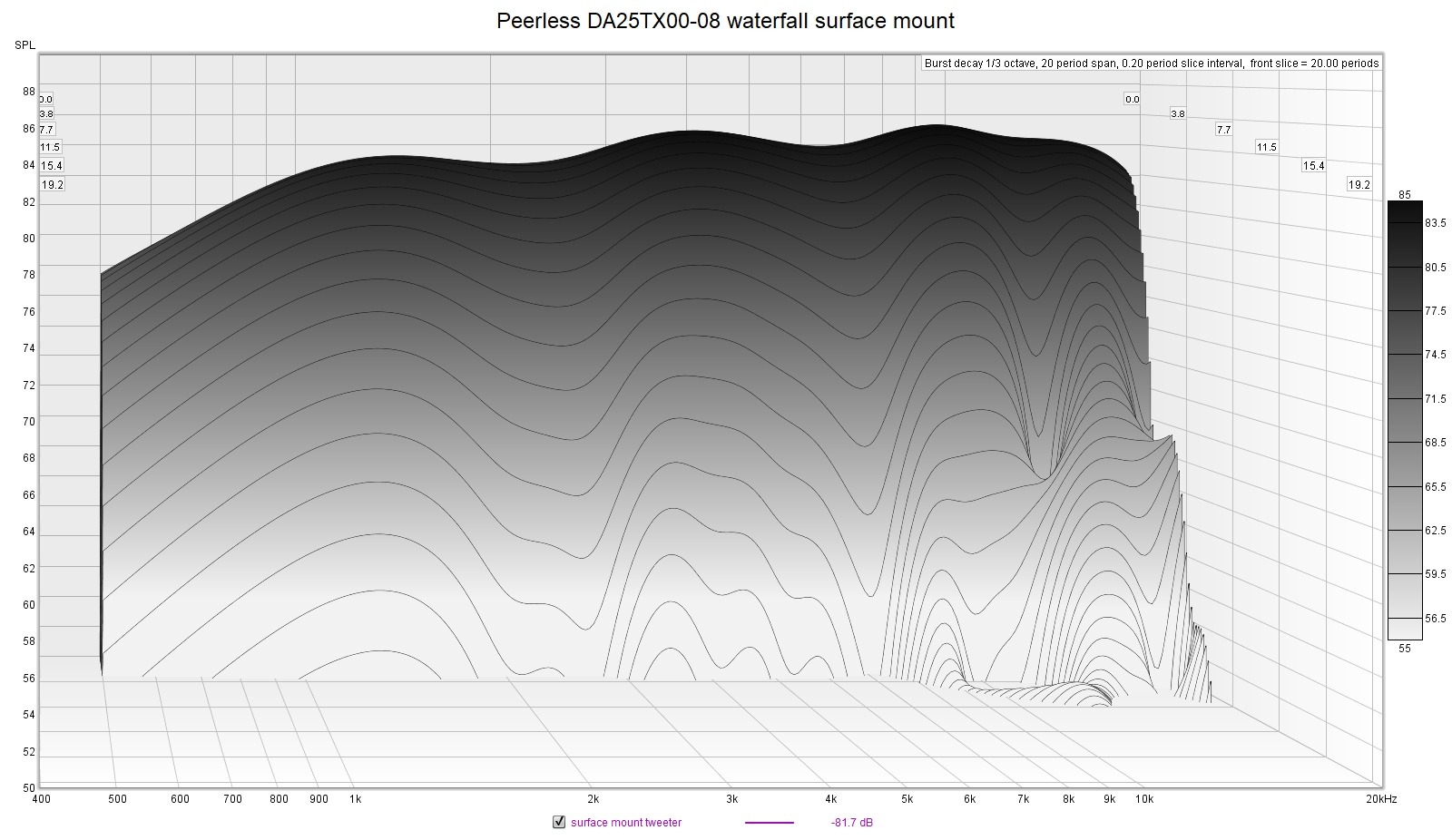

Following up after (mostly) flush mounting the DA25TX00. The routing was a fraction of a millimeter too shallow. A bit better performance is likely with a perfect flush mount.
The very impressive response, ETC and distortion results are nudging me toward another shot of mating it with the Jordan JX92S, which is equally impressive below 2 kHz.
