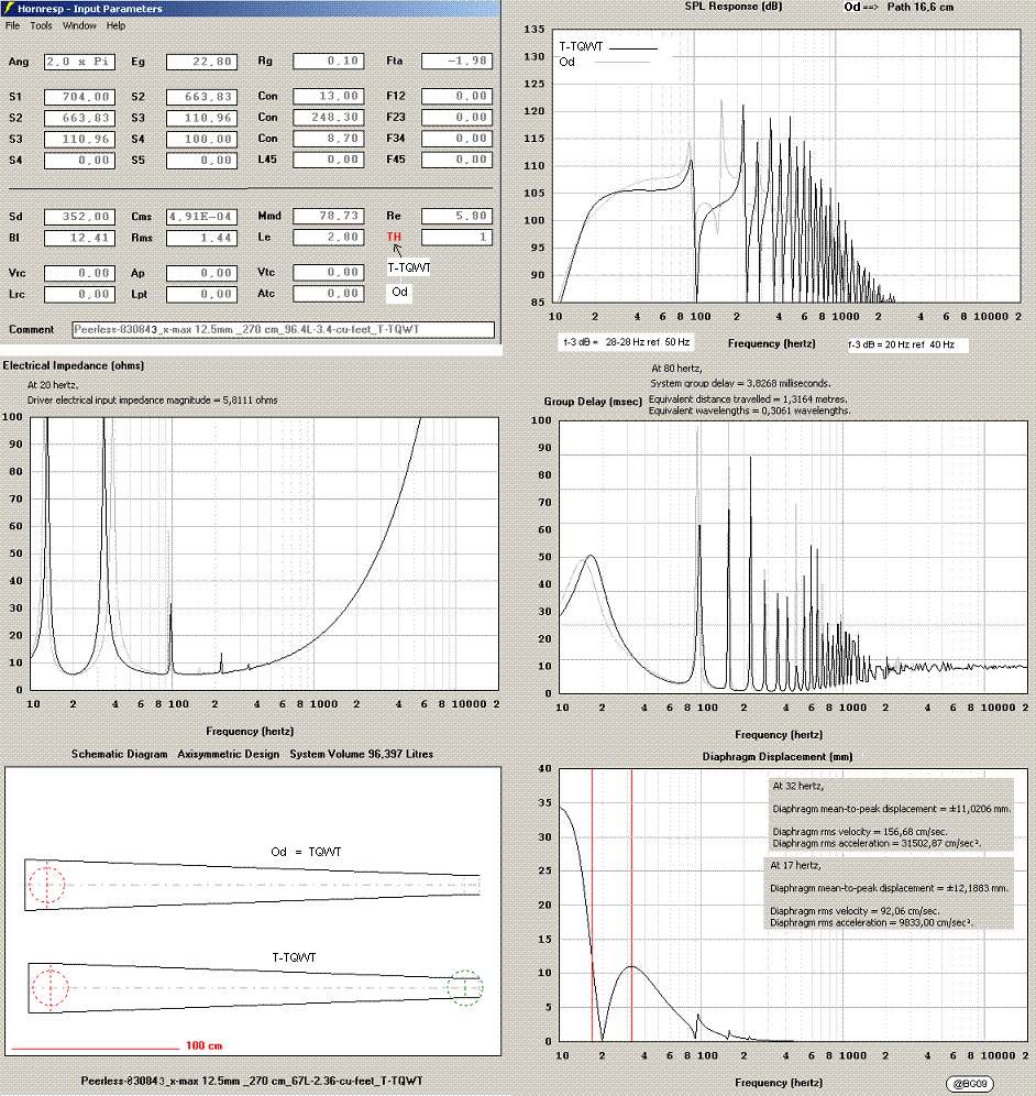

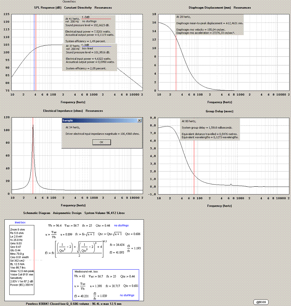

Yes, Ive used all the XXLS 10" drivers in different designs.
A couple of different HR simulations using the Peerless 830843:
1(3)-3(3)
b
