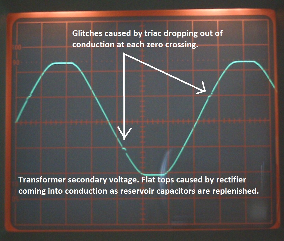

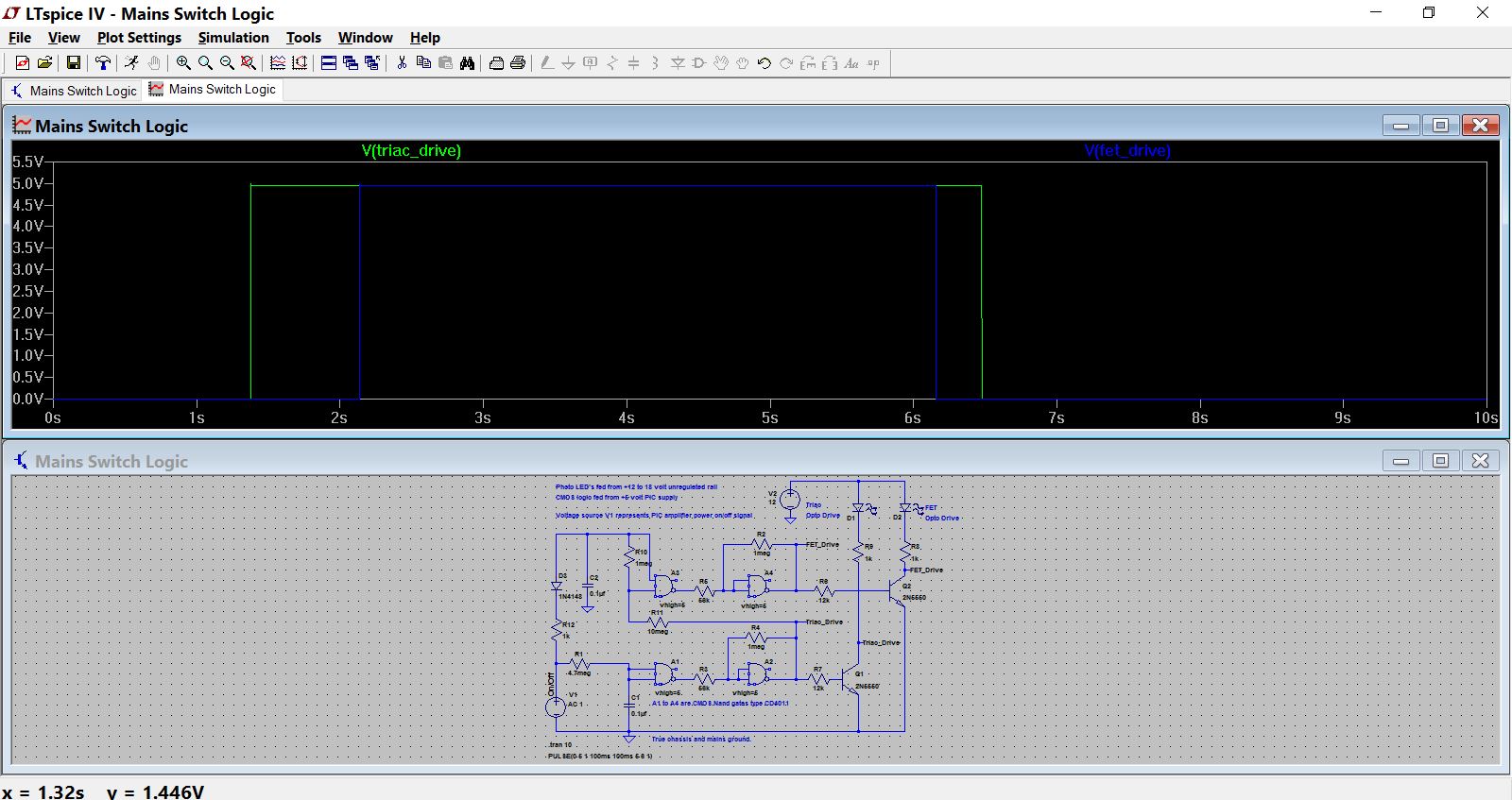

I have a circuit beyond a prototype stage (i.e. it works) that uses a triac + resistor to soft start a toroid and then a few moments later the triac is shunted by a solid state switch.
The logic circuit allows on/off via a simple logic input such as a uP or a PIC etc, or just a simple low voltage manual switch. For safety it should be power from a low voltage standby supply... other methods of obtaining a suitable low voltage low current supply are available of course, but are outside of the forum rules.
The triac fires first and turns off last. The FET switch places a low impedance shunt over the triac effectively killing any commutation noise etc. High voltage FETs are easily available, I used BUZ11's from my TV repair days. Not the most suitable choice in terms of current rating and low Rds but they worked perfectly. The tranny was a 650VA toroid.
You can see the timing here. The circuit should run straight off in LTspice as it uses standard library parts. The delays are easily changed by altering the time constants.
The triac drive used an MOC3023 ? (from memory) operating on a power triac like the BTA/BTB16-600B. You need a triac that will fire in all four quadrants. I didn't have such a device and you can see the glitches that that caused here. Of course once the FET shunts it the problem goes away but better to do it right from the start.
The FET switch is a copy of the well known speaker relay version that uses a photovoltaic coupler but with FET's suitable for mains use.

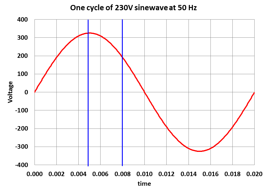

It occurs to me that Douglas Self's recommendation to use a relay and a resistor, might turn out to have very nice timing properties when you choose the right relay. I see that inexpensive relays with high current contacts like the RTD34012 are available with a datasheet guaranteed maximum pull-in time of 8 milliseconds.
If the manufacturer has added standard amounts of guardband and safety margin and C.Y.A. so that essentially 99.999% of functioning relays meet this spec (there is no "yield loss" when otherwise good parts must be discarded because they don't meet this spec), then I expect that real relays measured in the real world will have a pull-in time somewhere betweed 5 milliseconds and 8 milliseconds. I've placed vertical blue lines at 5 msec and at 8 msec in the Figure below.
Cowabunga! This is near-as-dammit to switching at the mains peak! Switch the relay coil @ zero crossing, the contacts switch at the peak. If the timing is off a little bit either side of the peak, so what! That's what the resistor is for! It limits the inrush current. (In an inductor, AC voltage leads AC current by 90 degrees. "ELI the ICE man").
Recall that 230VRMS = 325V peak.
