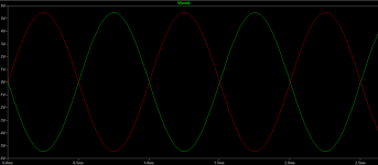

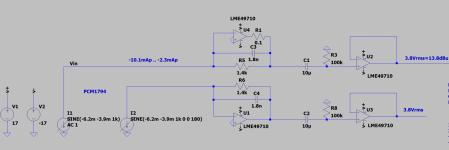

I have tried to use 4-layer PCB and low-noise LDO. The results are shown in the figure below. LDO suppresses the sound of transformer very well. The default circuit in the manual is used, but it is far from the nominal performance in the manual. I don't know what's wrong, or the performance of this circuit is like this. If you want to see more details, you can take a look at my thread.
That's a fairly typical output, especially the peak at 1K. Overall, it's not bad but can be improved with better filtering. Some Sample Rate Converters and DSPs often have filters or similar to minimize those components (at 1K, 2K, 3K, 4K) and it's still in the digital realm. The rising curve starting at 10K is typical too. The master clock can cause problems. With 4x over sampling you can expect to see the three additional peaks from 1K. A high quality external master clock (PLL) can be helpful to help alleviate jitter problems. Make sure you use a high quality voltage regulator for the external clock (I use LP2982 and a PLL1707 for the clock, another common D.I.Y. clock is the "o2"). Tuning the I²S track lengths can help too, even though its low frequency, and if your DAC output has differential (not balanced) circuity, it's essential to tune the differential tracks. I tune (as best as possible) to within 0.01mm to 0.05mm, both in length and symmetry.
Considering the low noise of good op-amps, it's no problem to construct a 4th order (two op-amps) to an 8th (four op-amps) or higher LP filter. The LP filter is going to have lower harmonics amplified, and despite the oscillator frequency, it will start at 1K due to the DAC topology. The filter roll-off of the LP filter will create a lower harmonic noise starting and rising at 10K, and a lesser magnitude lower harmonic starting at 100Hz and rising to DC (the DC is filtered out by the DAC. Usually). If the internal filter is disabled and you haven't included your own, that may not be the case, then, woe to thy tweeting devices! The internal filter can usually be disabled, a good filter won't fit in the package, especially parts like mica, polystyrene, or PPS capacitors. Furthermore, a great deal of noise is generated outside of the DAC anyway. It generally doesn't hurt to use both.
I'm just wondering about inverting the 1K spike and using it for cancellation (most of it), it's probably a lot more difficult than I think.

Yeah, extremely demanding and a bit limiting on the IV stage though the AKM parts. in 2 channel or fully mono setup, they require the IV stage to parse a huge amount of current, a bit like the 9038PRO. This forces your hand a bit with opamp choice, or means you must construct a composite amp, or discrete/IC composite for IV.
