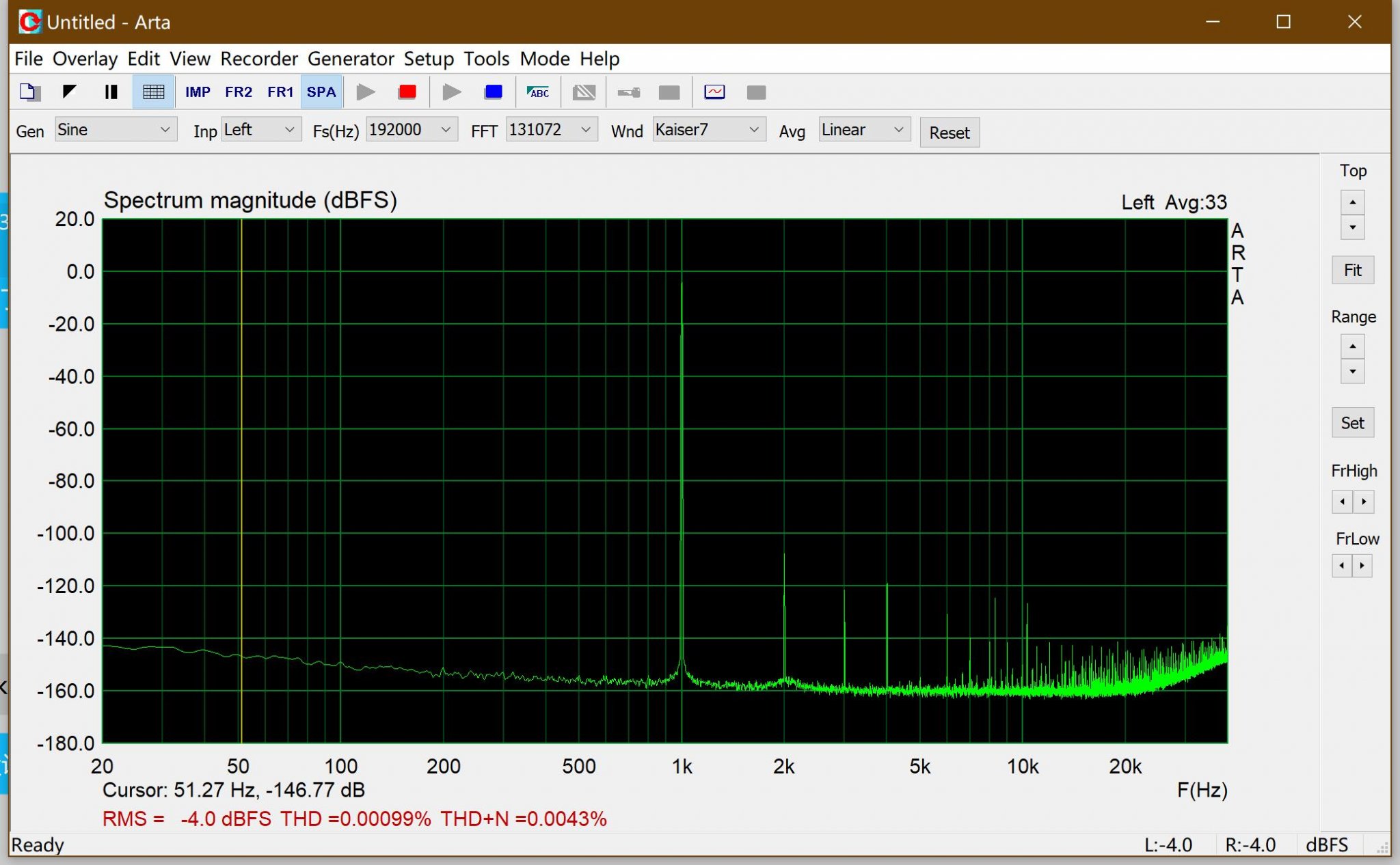

Where does the distortion of 1794 mainly come from? Accuracy at IV? CMRR of LPF op amp? Or from 1794 itself? Is it possible to achieve the same parameter performance as ess?
Joined 2005
The distortion comes from all of the above, but if using a transformer, that would be the biggest source unless you pay a fortune, and even then they are not ideal. Lower resistor values (~10Ω) will give you a lower impedance and lower distortion, but also lower output voltage, so getting an SNR of (≥100dB) is very difficult. Too bad really, transformers have a lot to be said for them, they are a nearly perfect component (on paper anyways) and almost 100% efficient! I have a few theories I want to try when I have the spare time and wind my own transformer.
The SNR+N from the PCM1794A is around what's stated in the datasheet. The I/V conversion is a culprit, but if you use a decent op-amp and design (and there's lot's out there) and layout and parts, that will be fine (or good enough). There's a lot of arguments about impedance matching because the PCM1794A has a high output impedance. A high (and low) input impedance op-amp are thought to create distortion due impedance mismatch. I've had very little difference using JFET or BJT input op-amps. The resistor values (resistors are noisy, see "Johnson–Nyquist noise") in the feedback do have an effect, depending on the type of op-amp. The Transimpedance Amplifier (designed as a TIA, not just a standard op-amp set up as a TIA, most of us don't have the equipment to LASER trim and measure parts, as well as a few other differences) takes care of that problem a great deal, hopefully that works out for me.

I have tried to use 4-layer PCB and low-noise LDO. The results are shown in the figure below. LDO suppresses the sound of transformer very well. The default circuit in the manual is used, but it is far from the nominal performance in the manual. I don't know what's wrong, or the performance of this circuit is like this. If you want to see more details, you can take a look at my thread.
