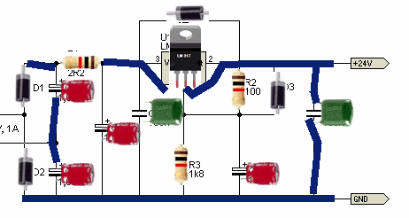

I have a picture of the scheme ,I would like to convert a PCB design .
Thanks a lot in advance for your help !
That design is far from elegant. Can you offer some insight into what you expect from this circuit, the rationale for this circuit topology (especially the voltage doubler input section), and your selection of component values.
Before you design a PC board you generally have at least a rough idea of what space the board must fit into, what the input and output connection interfaces are, and whether it'll be surface mount or through hole. In this particular case I'd want to have more info about that transformer!

That design for IEPE (ICP®) Sensors
IEPE be used for force, pressure and acceleration sensors, as well as in measurement microphones,
because the microphone uses the 4mA interface, . In common with most microphones that use the 4mA current supply, the recommended connector is a BNC at the microphone and power supply ends, and standard double-ended BNC leads are used for interconnection.

1) You can buy a pre-made 24VDC supply cheaper than you can buy the parts.
2) Research!! Only please call it "Plagiarism". Look for a similar plan and adopt it.
Adjustable Power Supply Kit - LM317 (#1725) | NightFire Electronics LLC
Variable Voltage Power Supply using a LM317 | soldernerd
3) Buy the parts. Put them on a printout of the schematic. Oops, parts that are small on the drawing are large in real life. (Depending on load (which you have not stated) the LM317 may need a large heatsink.) Move them around to sit together nice. Draw lines to make the right connections. (Making a neat compact layout without undesirable interactions can be quite hard!!)

Yes I use a program Easyeda to the schematic symbols , but the difficulty convert schematic to PCB Layout !!
