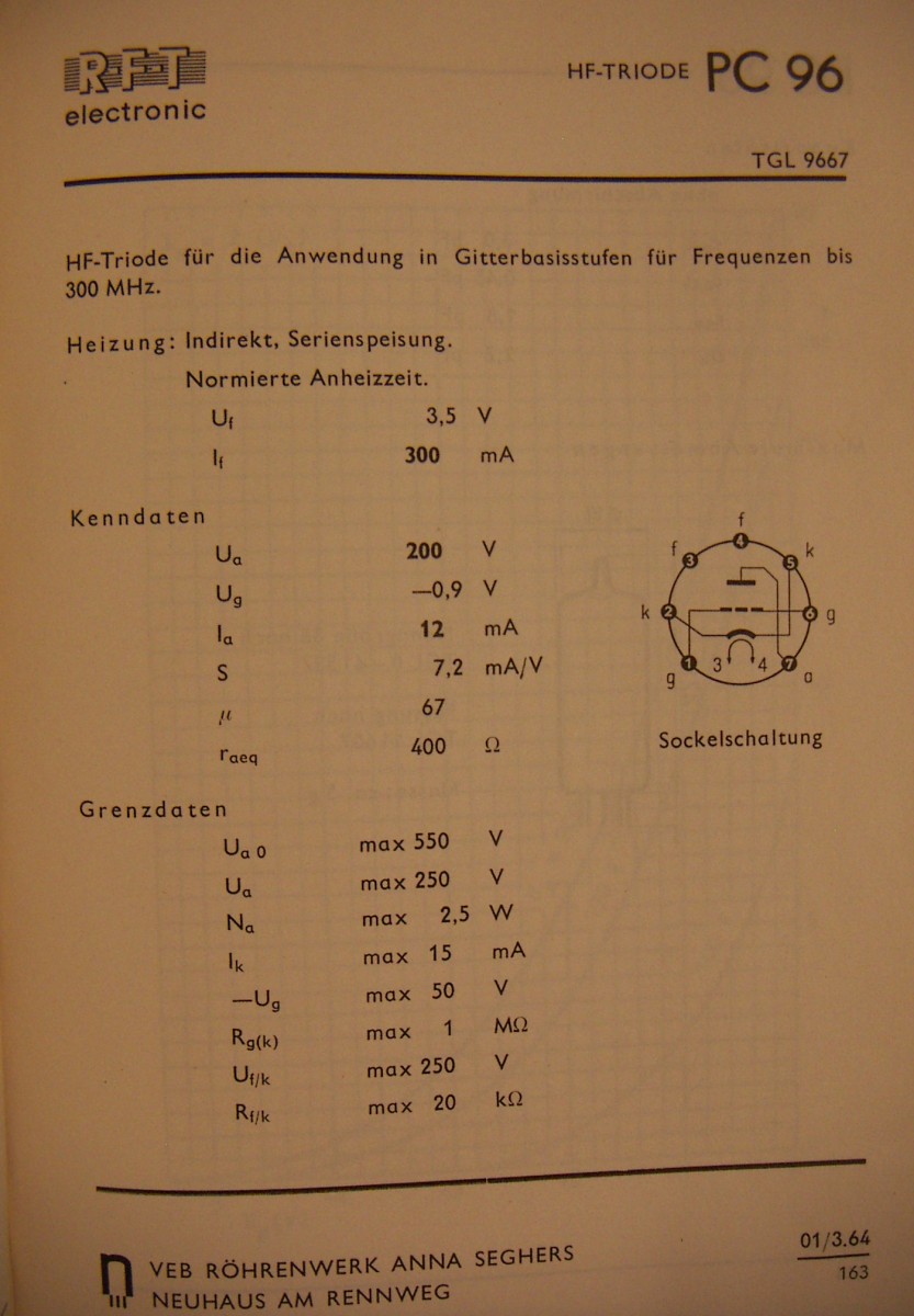

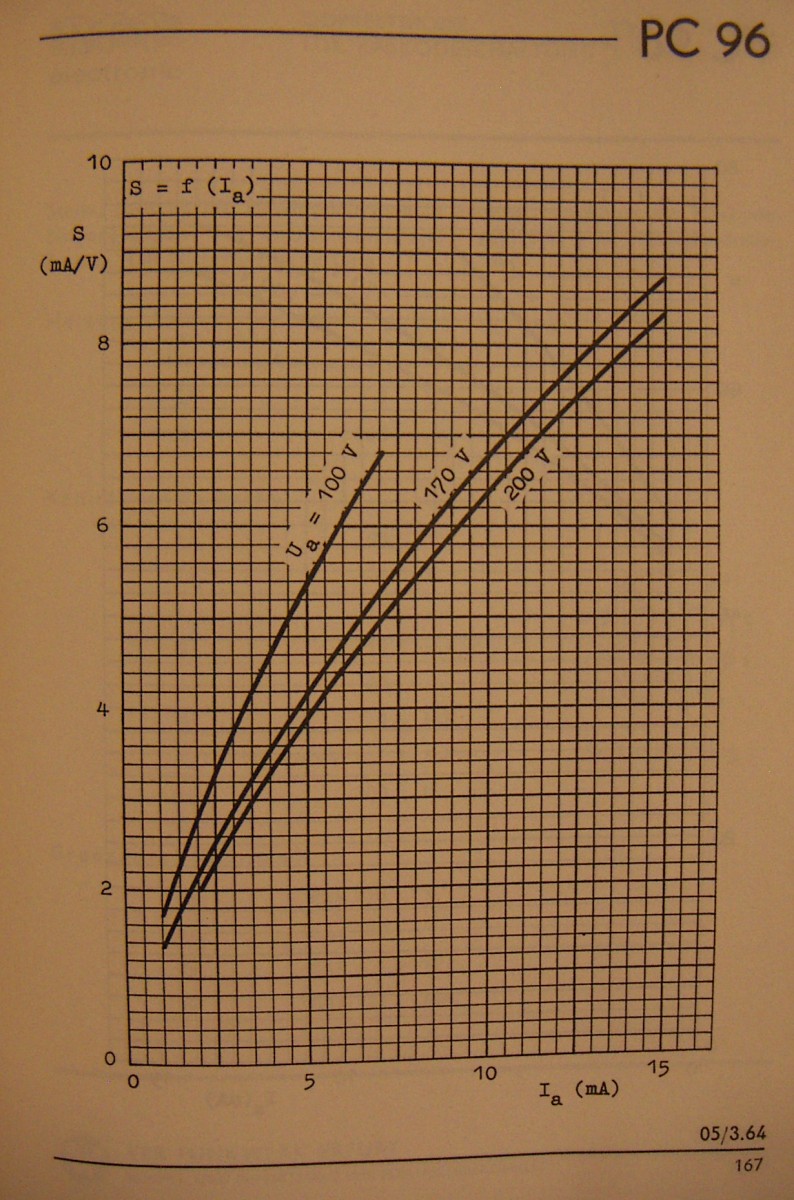

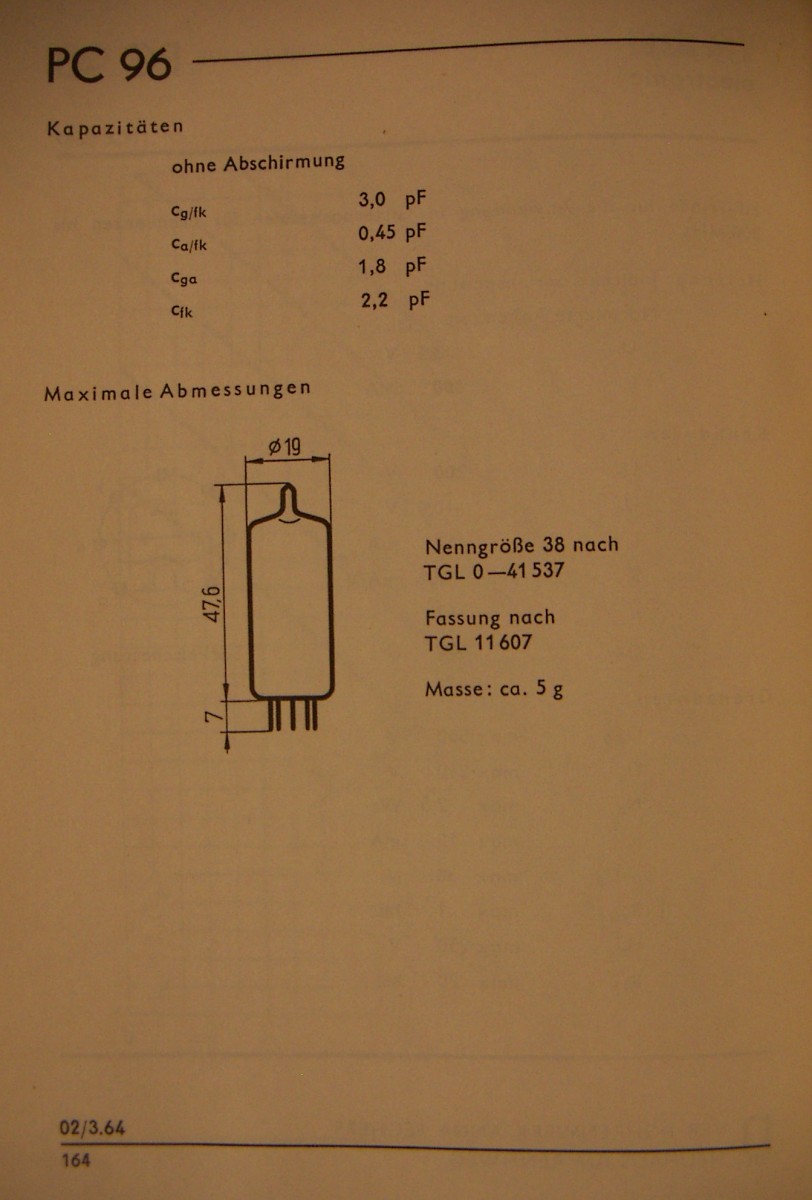

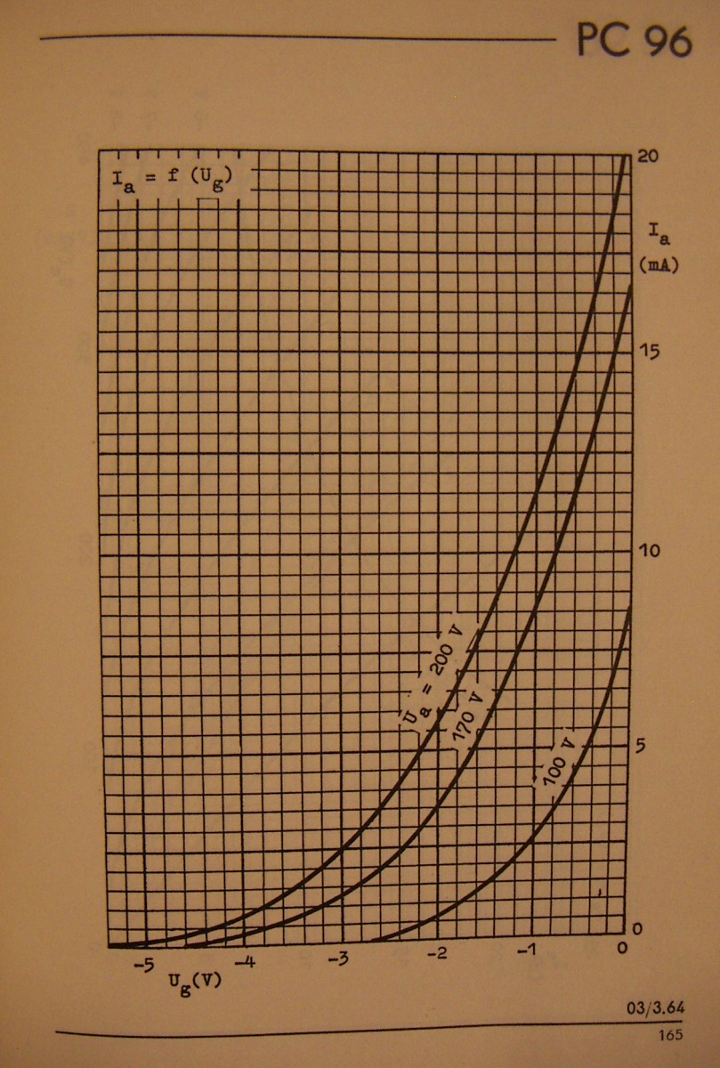

ok, it's 12 years ago, but while searching for PC96 data I found this thread. In my bookshelf I found "RFT Handbuch Rundfunk- und Fernsehröhren Ergänzungsband 1965" (Radio and Television Tubes Handbook Supplement 1965, German Democratic Republic) which contains the datasheet of the PC96.
Maybe it is still usefull for someone ...
Regards
Regards
PC96_RFT_Handbuch_Rundfunk-und-Fernsehroehren_Ergaenzungsband_1965_S163.jpg160.8 KB · Views: 458
PC96_RFT_Handbuch_Rundfunk-und-Fernsehroehren_Ergaenzungsband_1965_S164.jpg129.1 KB · Views: 423
PC96_RFT_Handbuch_Rundfunk-und-Fernsehroehren_Ergaenzungsband_1965_S165.jpg246 KB · Views: 392

PC96_RFT_Handbuch_Rundfunk-und-Fernsehroehren_Ergaenzungsband_1965_S167.jpg260.1 KB · Views: 393
