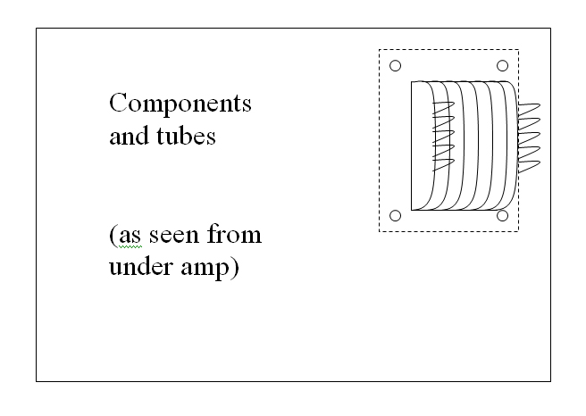

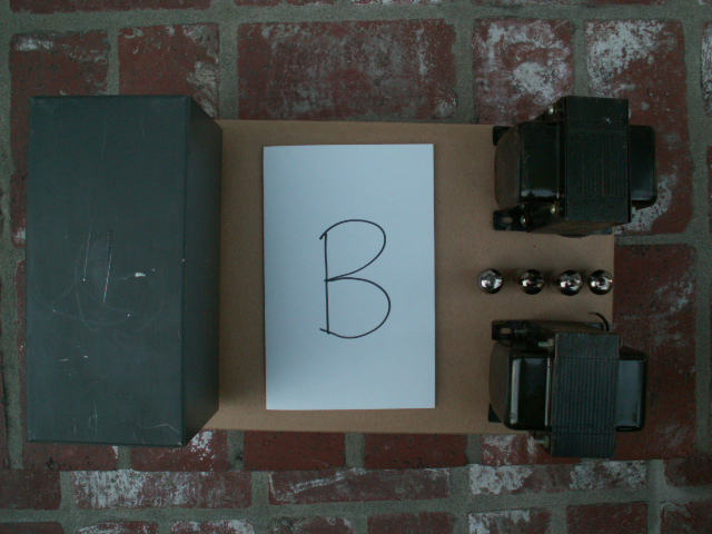

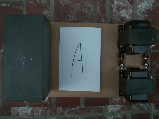

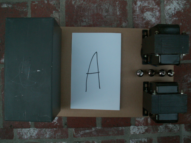

Hi everybody,
I have a question that is along the lines of this post; I just can't seem to wrap my head around the geometry that you all are describing above...
I want to build a stereo amp and the space on the chassis is rather tight. I want to know the best way to situate the output transformers so their magnetic flux will LEAST affect the pre tubes that are situated very close by to the output transformers. The choice is picture "A" or picture "B".
The power transformer is at the left, the middle of the chassis is for the output tubes and the 2 transformers at the right will be the outputs with the pre tubes (pre drivers) in between the 2 output transformers.
The pre driver tubes will be 6DJ8 or 6CG7 tubes, the output tubes will be 811A's in push-pull. This will be a stereo version of the Gotham Audio's cutter amp that they made back in the 50-60's. I have built a mono version of this amp and love the way it sounds, now I want to do a stereo version.
Thanks in advance...
Daniel
PS. One more question.... If the long side of the transformer core emits the strongest field, then why does the sides perpendicular to the core emit the most invasive of the magnetic fields? I don't follow. Wouldn't the side that emits the strongest field be the side that is most invasive?
I have no idea why the coil generated flux is more invasive. That's just an empirical finding from 35 years of helping other folks track down their noise issues. Were I to build the amp you show in your pictures and wanted the least interference and could not mount the tubes on the other side of the main board or just sticking up through pretty tight holes in the board I would place them as shown in the picture.
I would strongly suggest a bread board first and then a perfboard with sockets and OPT's mounted on the desired metal plate just so you can move the tubes around.
Bud
Bud
And even a metal shield needs to be very thick (>10 mm) to be worthwhile for magnetic shielding. Unless, you have access to mu-metal...
~Tom
You can get sample packs from mU-shield -- although you have to pay for them.
In my own humble experience, this is not predictable through an intellectual exercise or discussion.
The only way to be sure to have the least coupling is to test it on the bench. Different transformers in practice behave differently.
Apply the correct AC voltage to the power transformer and monitor your signal transformer or coil for a millivolt level AC signal. Sometimes a pair of headphones is sensitive enough. The input of an amplifier works also. Then move the coils around and try all orientations for minimum coupling. Try different orientations of both the power transformer and the signal coil relative to each other.
For example, I found the best orientation for Hammond open frame filament transformers on one amp to be with the open coil directly facing the OPT. Go figure...

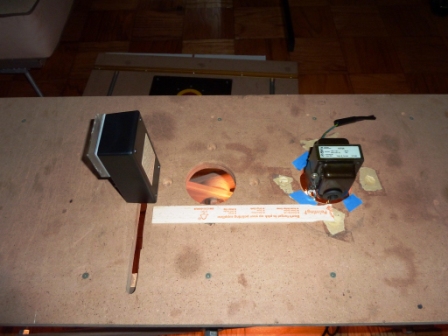

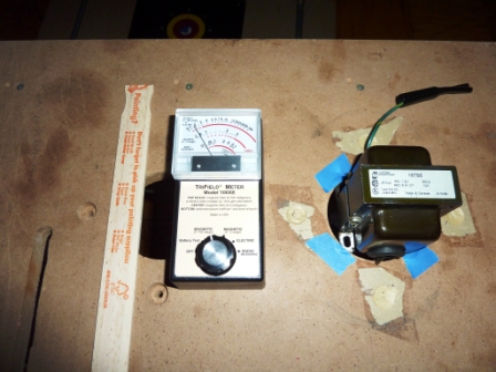

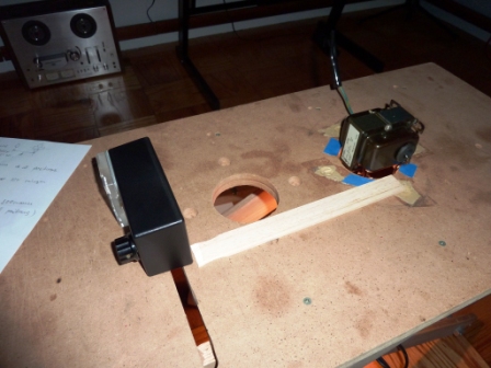

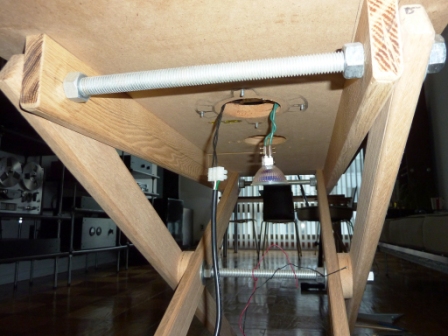

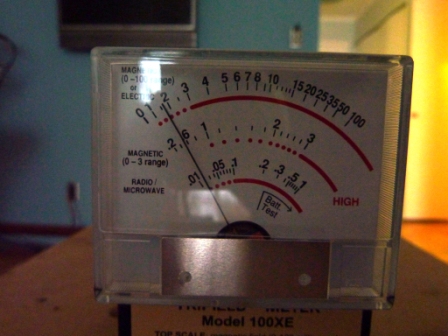

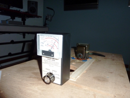

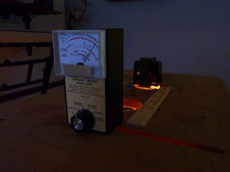

Hi All.
I decided to do an experiment and measure magnetic leakage field. The following is a brief description of the experiment.
Materials and Methods:
I used Hammond 167S6 filament transformer (116V Pri. 6.6VCT 10A sec.) loaded with 12V 50W halogen bulb. Transformer was mounted on the wooden table. The Magnetic field was measured with TriField Meter
Trifield® Meter
Meter was set on "Magnetic" 1-100 mgauss for all measurements. In all measurements the distance between the TriField Meter bottom and the transformer center was 10.25". Transformer center is assumed to be an intersection of the symmetry axes.
See photos P1 and P2 for the setup.
Results:
1) I made sure that there are no strong external magnetic fields to interfere with the measurements (e.g. turned off my stereo and lights 🙂). Also placed the table in the middle of the room. I made multiple measurements in the visinity of the test device ( 3-4 ft spere around the transformer with power off). In all cases the measured field was less than 3 mgauss (see photo P3).
2) I measured magnretic fields with power on with transformer in three different positions (three axes). For each position I made measurements at each side along the axis and equal distances from the transformer center. The distance was 10.25" for every measurment. I choose this distance because the strongest field gave me 100mgauss (full scale) during one of the measurements.
Here are the actual results:
a) the measurement axis is parallel to coil axis (photos P4,P5): 100mgauss
b) the axis is perpendicular to laminations (photo P6,P7): 50-60mgauss
c) the axis is perpendicular to laminations and transformer is rotated 90 degrees (photo P8): 50-60mgauss.
(continued in the next post)

Irakli, why did you move the meter?
You could plot level as you just turn the transformer through 90 degrees (keep meter in same position), for each of the three transformer axis. And could repeat for each of the three meter axis orientations.
Ciao, Tim
Ciao, Tim
actually I did it both ways 🙂 the results were the same.
pictures represent the one you are talking about.
As measurement is made with a fully shrouded transformer, the faraday cage is makes could explain the quite equal measurement on all axes.
Anyway, usual components are far closer than 10" in an actual amplifier.
valid point.
So I repeated the measurements with 2.5" distance. The setup is the same as above except I use variac (located far away) do decrease primary voltage to 25V. This way I could get stray field in the range of my meter (again, the strongest field at 2.5" was giving me 100mgauss).
The results are absolutely the same as in previous post.
valid point.
