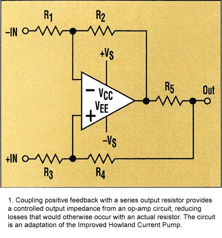

I redraw this fig.2, and it seems device 59 is forming "Howland Current Pump" with Vc at R7 as the input.
But I'm confused. In my thinking, R4 should be connected to VC (not to ground) and R6 should be connected to ground (not to VC).
The logic is if Vc is positive towards ground, then the device 59 should be giving current, not sucking current. Am I wrong here?

This schematic is made By Mauropenasa. In this schematic, R6 is the sensing resistor, and the more positive side of the sensing resistor is connected to (+) input of U1.
In the statis patent, R7 is the sensing resistor, and the more positive end of this resistor is is connected to (-) of device 59.
These 2 has opposite operation of the current pump, one gives current for positive sensed voltage, one sucks current for positive sensed voltage?
Which one is the right one?

How to use this schematic?
The (-)input of opamp block is to be (-)input of the current pump.
The (+)input of the opamp block is to be (+)input of the current pump.
IF the (+)input is more positive than (-)input, then the output is giving current or sucking current?
