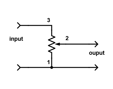

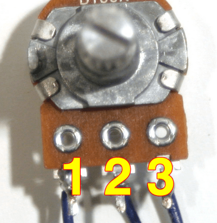

Please wire 1,2 and 3 on your logarithmic pot accordingly, you will know what thirdicomplex meant.
Screenshot 2023-06-27 at 19-27-20 IMG_2386.jpg (JPEG Image 635 × 683 pixels) — Scaled (70%).png
Screenshot 2023-06-27 at 19-49-41 Scheme-it Free Online Schematic and Diagramming Tool DigiKey.png

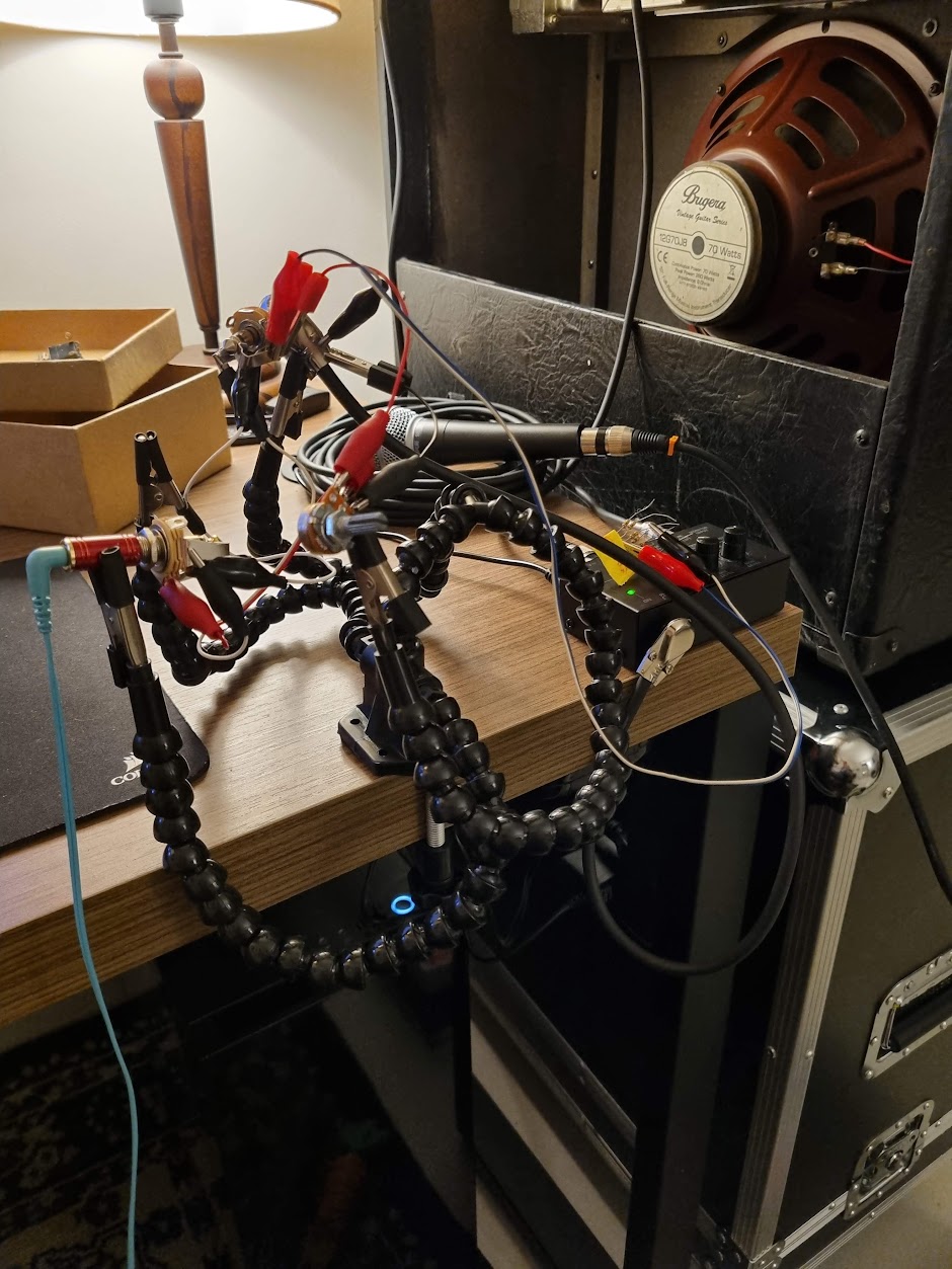

there's basically nothing there, just whatever pot I'm testing, between the (L channel from the) stereo out jack and the headphones jack
R channel is connected directly from stereo out to headphones
Ground too, and also to the pot
The only resistors I wired were temporarily the ones from wiper to ground
If I remove the pot from the equation and wire the L channel directly I get the same output level as the pot maxed out without any resistors
In fact I'm gonna eliminate the R channel entirely for testing since what I want is basically a volume pot for a mono channel.
