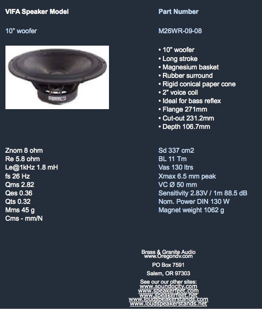

The bass XO consists of a 330uF Bennic electrolytic cap in parallel with a Vifa M26WO-06-04 woofer and a 5.3mH coil (1.1 Ohm DCR) in series with those. I haven't found the T/S parameters for this woofer, but I have found them for two other Vifa 10 inch woofers, the PL26WR-09-04 and M26WR-09-08 (see attachments). I would be surprised if my M26WO-06-04 is very different from the PL26WR-09-04.

In this Stereophile review they measure the woofer resonance at about 36Hz, which should be far enough away.
Is it really as simple as plugging L and C into that equation? Seems that's not telling me the whole story.
Yes it is that easy, sort of. 1/(2PIsqrt(LC)) will give you the resonant frequency (corner) of the LC components but it will not tell you what Q is. Q will depend on the load. There will also be some effect of VC L on this as well.
36 Hz isn't that far away.
