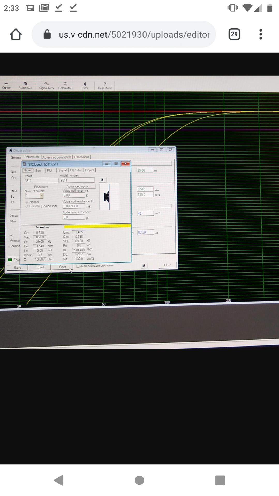

One other question. Say each of the drivers has a compliance volume of 30liters. Does this mean I need to have box volume of 60 liters if both of those drivers are sharing the same box. I am planning to make separate sealed compartment for each if the drivers

I just played frequencies from youtube. 5-200hz
Here are the graphs
I can use either 6503+6502 drivers
Or 6503+6511 drivers
The curves that are almost identical are 6503+6511
6502 seems like an inefficient driver. Lower curve
I want tighter mid-range
I'll play speakers in open space in few days to confirm 40-50hz dip in frequency response.
Here are the graphs
