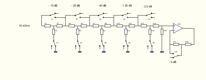

This is an "almost passive" preamp.
The attenuator is configured such that input impedance is constant 10 kOhms for all attenuations and output impedance is constant 3 kOhm for all attenuations except 0 dB.
It allows for attenuation in 1.25 dB steps.
Relays are encapsulated nitrogen-filled Teledyne. The amp is in use for about 20 years the relays are still doing perfectly well.
The bipolar chip opamp was later replaced by a discrete Aikido replica with 2N5196 matched n channel JFET pair and BUZ22 Mosfet.
It can drive 3 volts rms into 1 kOhm without distortion.
Dieter F.

its been 20 years and I am messy but I found a document that has the values of the first -10 dB step attenuators
R1 6800 Ohms
R2 4700 Ohms
R3 230 Ohms
R4 8760 Ohms
R5 1500 Ohms
R6 3300 Ohms
R7 10000 Ohms
R11 150 Ohms
R12 4700 Ohms
The attenuator is terminated with 10051 Ohms
The attenuation was measured with HP RF voltmeter only the -50 dB deviates by 0.1 dB as it yields -50.1 dB attenuation.
All other errors are less 0.1 dB.
The input selection is also accomplished with Teledyne military spec encapsulated relays. A push pull emitter follower ensures impedance of less 10 Ohms.
I cannot find docu for the other resistor values nor of the PC board layout this is supposed to sit on a 5 inch floppy disk which cannot be read by any existing PC excpet perhaps in Siberia East.
The device is built in a Mu metal case the power supplies for the Opamp and the logic ( an up down counter ) are external.
Replacing the power supply with a set of 2 times 2 7.5 volts NiCad packs made great audible improvement and is highly recommended.
Should I find more docum ( not very likely ) I will post it.
