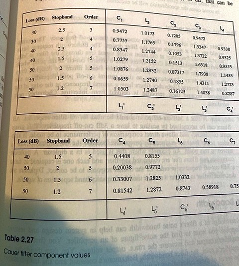

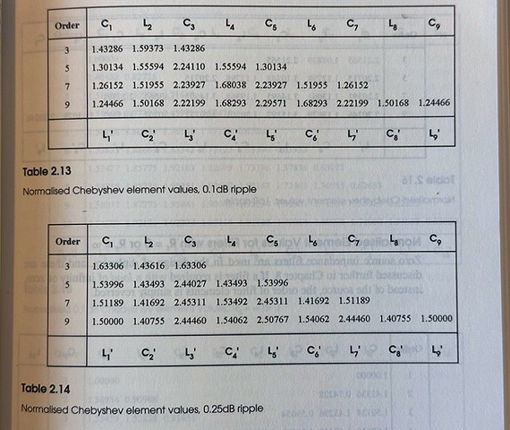

I found a book on one of my shelves, "Filter Design" by Steve Winder. It shows how to construct passive Chebyshev and passive Cauer ("elliptic") filters using resistors, inductors, and capacitors. So he thinks they CAN be made with a passive network. I have never done this myself. Never. But if someone paid me $4000 a day to read those chapters and use them to synthesize a filter, I suspect it would probably be successful.
Sorry for the awful image quality; I couldn't access a flatbed scanner today.
_

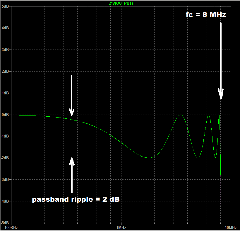

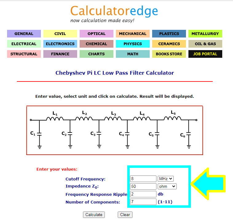

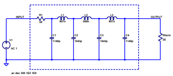

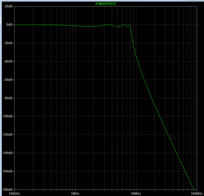

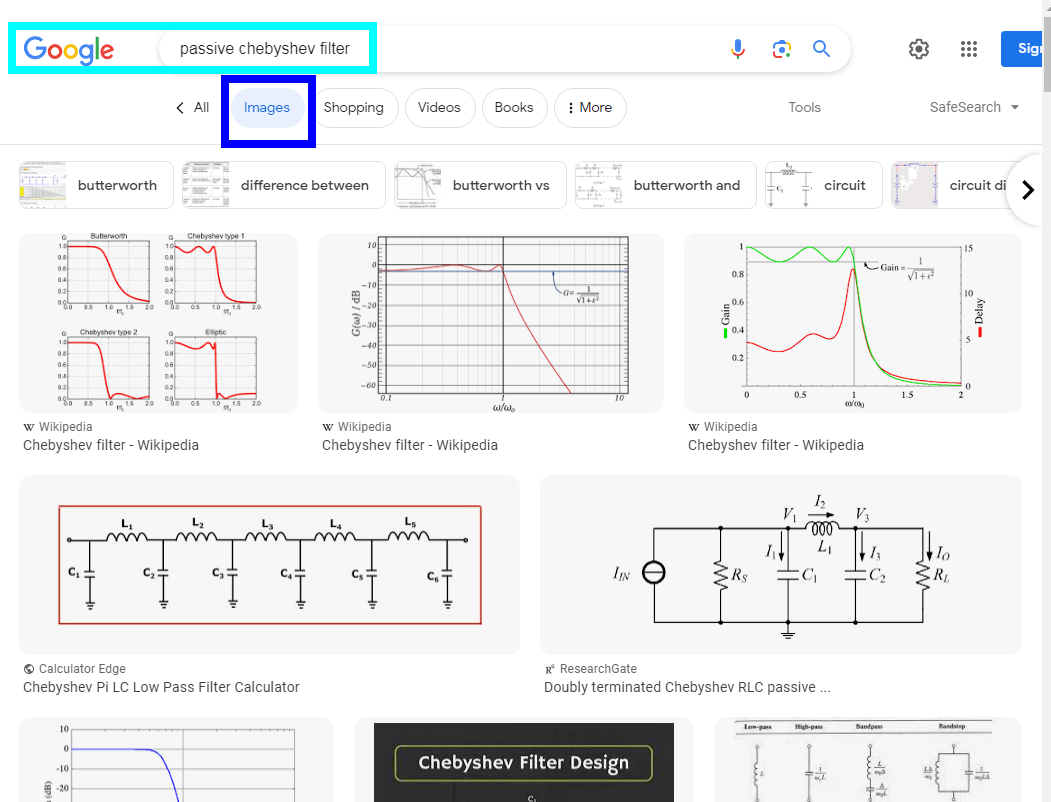

Traveling without book. However there's all kinds of great examples on the Internet.
_

Oh they certainly CAN! There is a HUGE book consisting of many, many design tables for ellitpical filters by Zverev. The problem is that all of these tables are for standard elliptical filters. I need to synthesize networks to realize filters that are LIKE elliptical filters in that they have zeros in the stopband but are NOT the standard ones found in these and similar tables.

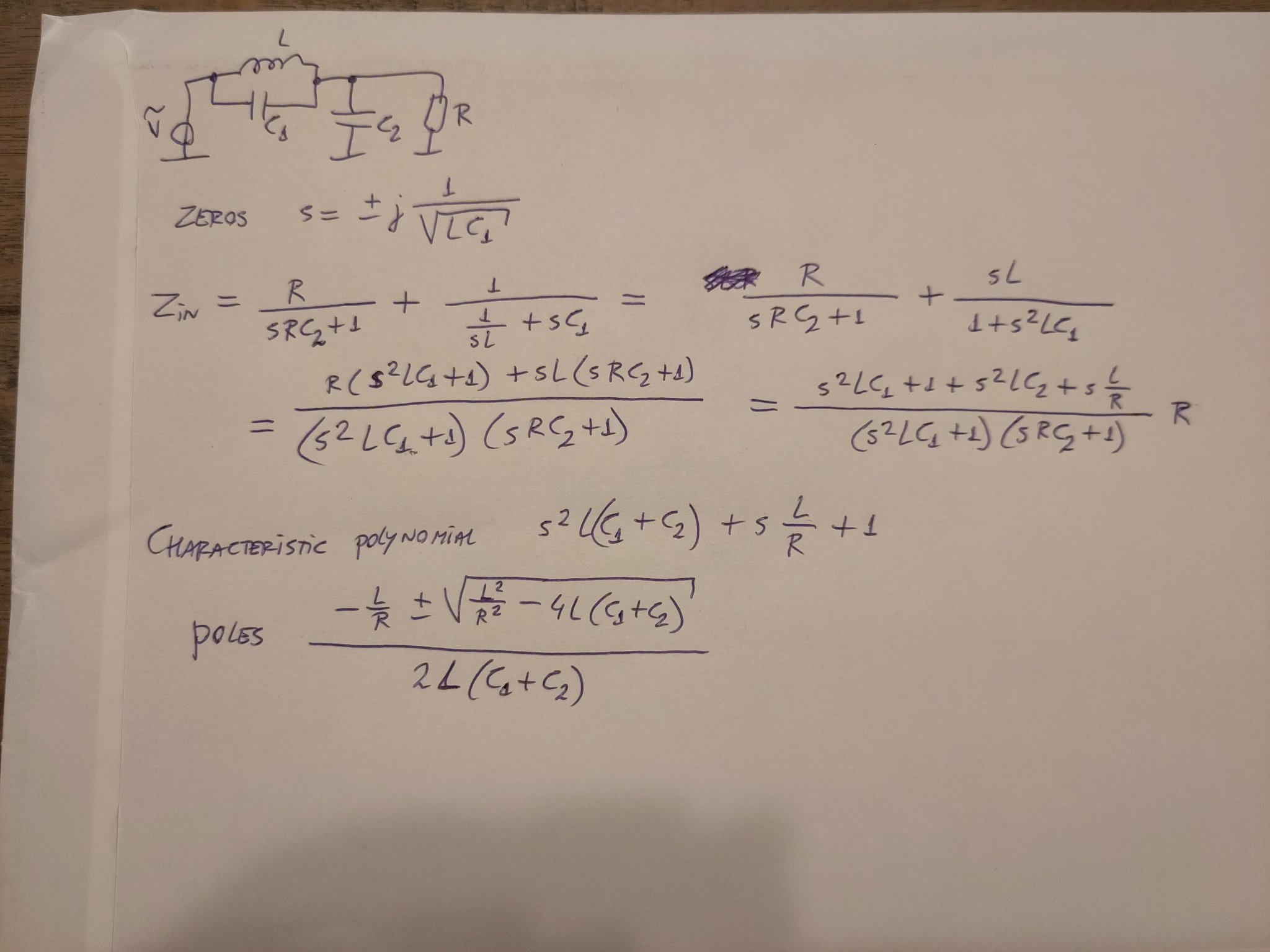

I never designed anything like that and I'm no filter synthesis expert, but if you know where you want the poles and zeros to end up, you could try something like this:
-Draw a ladder circuit with enough LC parallel and/or series tanks to make the zeros that you need
-Calculate the input impedance (symbolic calculation) of the LC filter including its termination resistor or resistors
-Calculate the characteristic polynomial; this is either the numerator or the denominator of the input impedance, depending on whether you drive the input with voltage or current
-From the desired poles, calculate the coefficients of the desired characteristic polynomial
-Equate the coefficients of the characteristic polynomial to their desired values and try to derive the component values from that
I have no idea whether the last step will lead to a useful analytical solution, or whether you get stuck there. The other steps are straightforward (but tedious).
If it doesn't work, read DeVerl S. Humpheries' book on filter synthesis very carefully and use whatever tricks he uses.

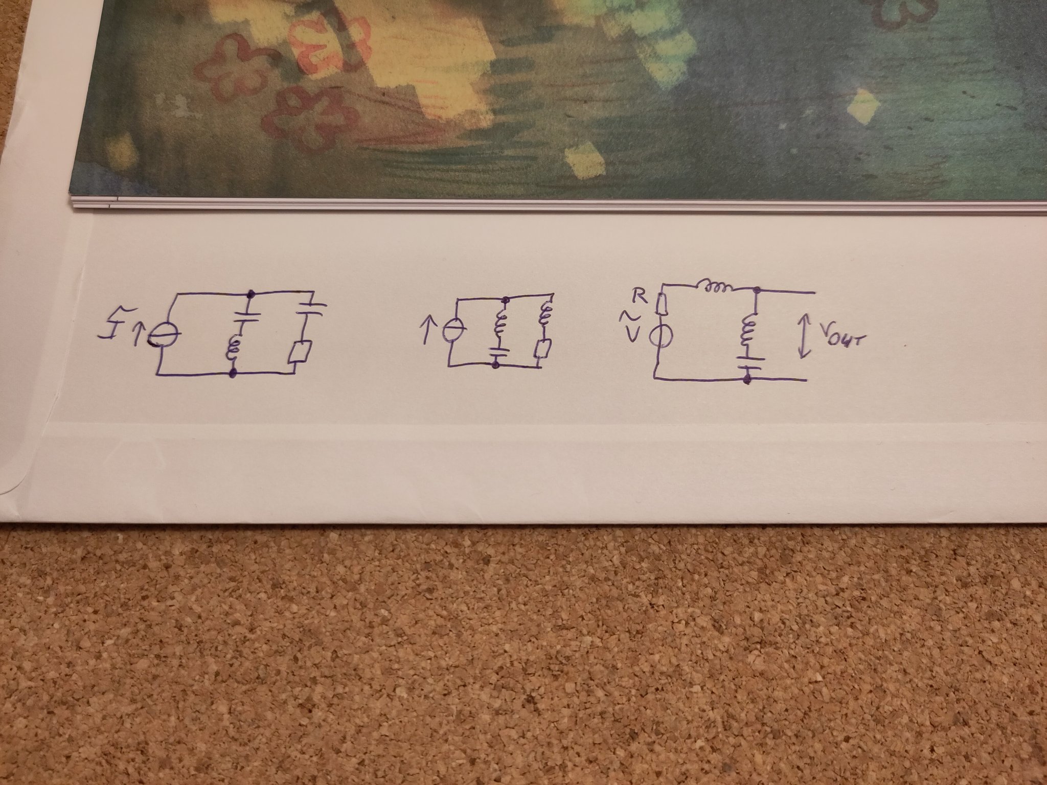

This is a second-order filter with a notch and a high-frequency gain that's smaller than the low-frequency gain. It's not nice, because of the capacitive load on the input voltage source. With a nonzero source impedance, it becomes third order. Replace the inductors with capacitors and the other way around and the low-frequency gain is smaller than the high frequency gain (and the voltage source is shorted at 0 frequency instead of in the limit for frequency tending to infinity).
