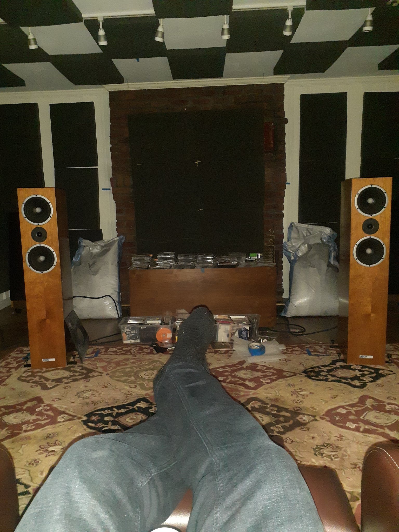

The monster coils form a 100hz Xover. I would like to try and make a first order 100hz xover and see what it sounds like when paired with my mains: Salk/Fried commemorative tower speakers. My amp is 550w, so plenty of juice there and all speakers will be fed from it. I know there will be a lot of overlap and efficiency concerns but would like to try this inexpensive option without damaging the mains or the amp. Perhaps an L-pad?
I'd appreciate all the help offered.

Sure. What actually is your problem at this stage.. You have two mains and one sub and want to cross them passively but are not sure how? You wonder if 100Hz is a good frequency (it's a good place to start)?
yes, Id like to Xover a passive sub to my mains. The passive sub does have a Xover to control it and its sattelites. Id like to use that Xovers huge coils (15mH) to make a simple 100hz xover
Sorry about that, somehow I accidently posted it b4 I was done..
Yes, Id like to use only the Fried subwoofer for more bass while playing my main speakers.
I'd like to pull the huge coils from the Fried Xover to create a simple bandpass filter for those subs. An online Xover calculator shows that coil at 15.1mH is good up to 84Hz. Is it correct to say that only that coil in series with the subwoofer driver of 8ohms is all that's necessary to play music from 20hz to 84Hz? If so, then that's done. If not, what would it be.
Secondly the hook up of now, two sets of speakers from my main amp. Will that connection hurt my amp? Will it be stable?
The sub is 8ohms and main speakers are 4ohms. Each amp channel will have 2 wires each on every pos and neg output terminal. Is that a parallel hookup and what would be the combined impedance now to determine if my amp can safely handle it.
Thirdly, efficiency concerns. If the subwoofers output is not loud enough, its a lost cause I imagine but if the output is too high while playing the mains simultaneously, would a simple L-pad in series with the inductor coil work to decrease its volume?

Are there two subs? Is it a single sub with dual voice coils? or just one sub? This is necessary to know before answering.for those subs
At the low end either a change in inductance or adding resistance may work.If the subwoofers output is not loud enough, its a lost cause I imagine but if the output is too high while playing the mains simultaneously, would a simple L-pad in series with the inductor coil work to decrease its volume?
Broadly speaking, yes. Each case has it's own exceptions but at least you have a place to start.Is it correct to say that only that coil in series with the subwoofer driver of 8ohms is all that's necessary to play music from 20hz to 84Hz?
The "sub", as you call it, is actually a single cabinet split lengthwise to form 2 separate TL woofer channels, each with a single driver, Kef B200. I guess i;m being confusing by calling it a sub since in reality it will be functioning as one to my main speaker system when im done. No single driver with dual voice coils. 2 drivers total, one for each channel. here ya go:

If what you say is correct, that the low pass would be just the coil in series with the B200,If I were to add an 8ohm resistor in parallel, tje amp would to lock it in?? see it as 4ohm....8+8/2=4 Would that resistor change the Xover freq?
The reason I ask is that each sub or woofer drivers is 8ohms and the mains system Xover are 4ohms. Off the bat, it sounds like the sub wont be loud enough especially since the sensitivities are 96 spl db @ 8v @8Ohm for the B200 and 88db @3v @ 4ohm for my main speakers.

Ok. If I were in your shoes I'd connect the subs through the inductors and test them for level. Don't turn them up too far since it's unclear whether they would show a low impedance at the lower frequencies. You'll be interested in high passing the mains at some stage to take care of that.
The next step depends on the result of that. Changing the levels, either way, or even high passing the mains requires some thought. If it turns out the best option is to get another amp, that might save some trouble in other ways.

Out of curiosity, to save some wire, what about a different hook up to the speakers from my amp:
Amp outputs to my mains as they currently are but then hook up to the subwoofer TL's. positive on the main speaker to positive on the subwoofer speaker and so on since they're only 5 feet apart instead of a 20ft run. Thats still the same parallel hookup as before, right?

Heres that behemoth that's just too big and heavy to put somewheres else, that I figure it's time to deal with. Even though my main are flat down to 40 these should give me what I've been missing. the coffin tests flat down to 16hz and Ive been trying to make my room get better to hear down to 20.
