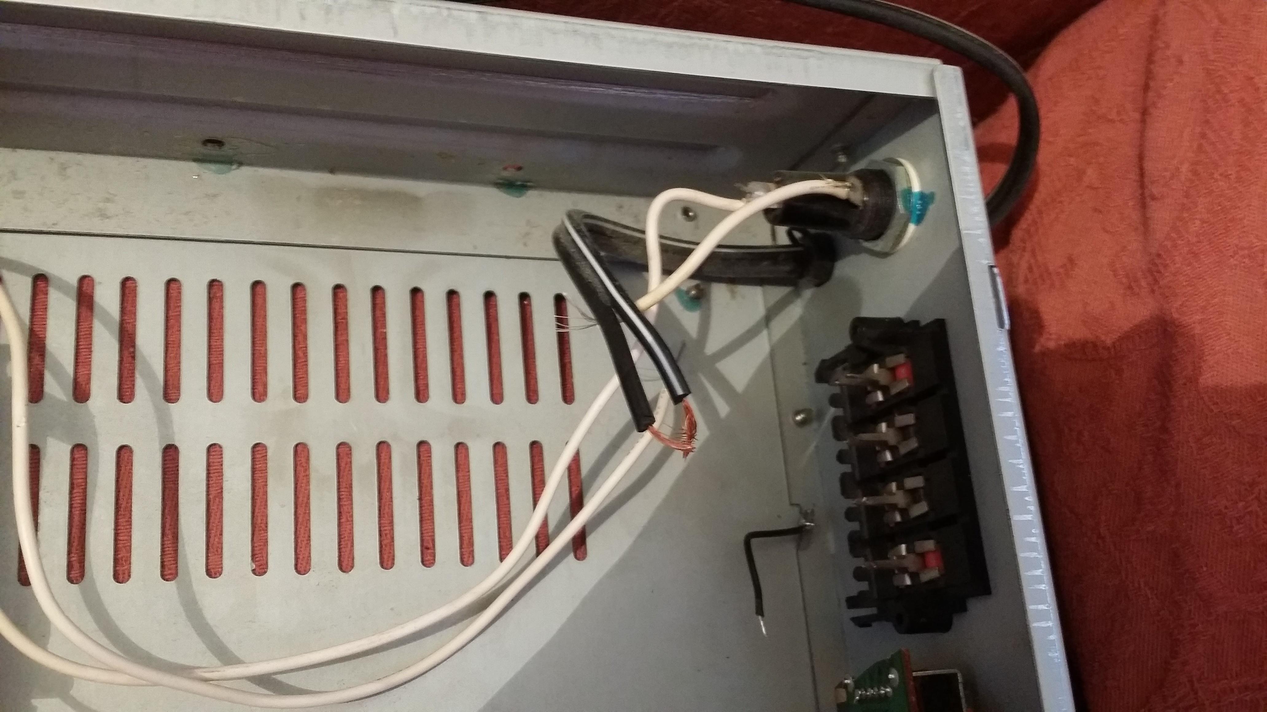

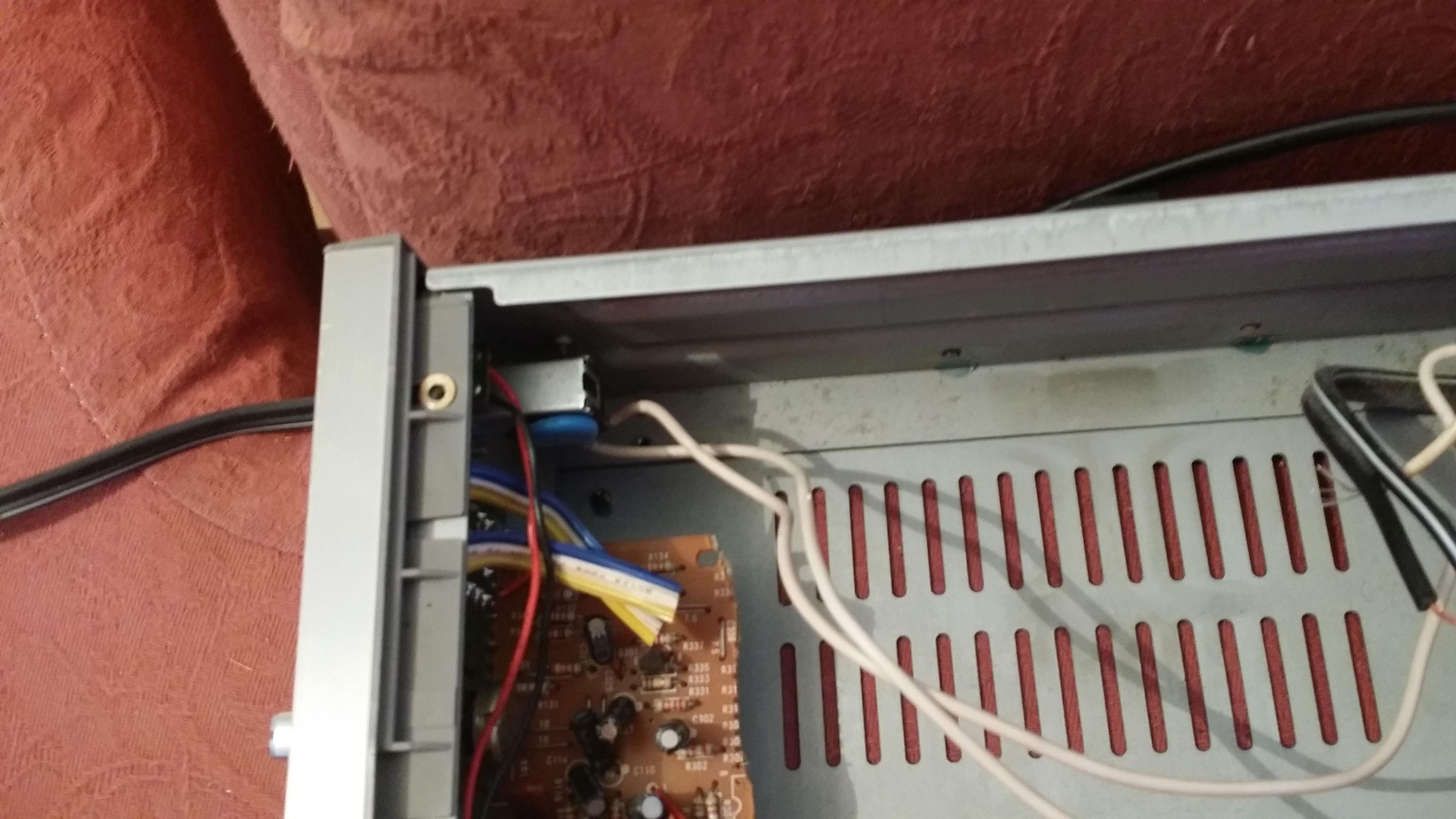

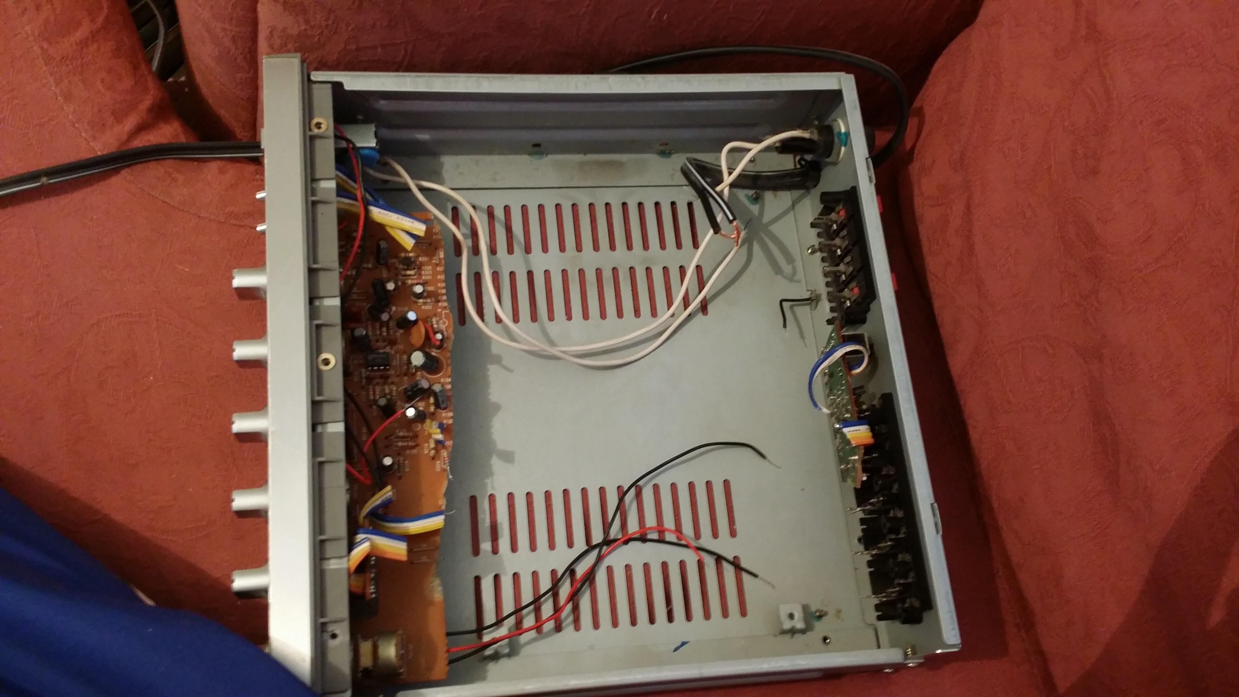

Well, a couple of weeks ago I finished my B-3 board and the Super Regulator board. I have the suggested Antek power supply. I would like to assemble these parts together in an old Radio Shack integrated amplifier case which I gutted if that is ok. It has the power switch, power cord, volume pot, and rca inputs intact.
The problem is that when I sat down to wire all of this together I realized that I have absolutely no idea what I am doing. I have replaced capacitors before and stuffed a few boards but my knowledge of electronics is beginner at best.

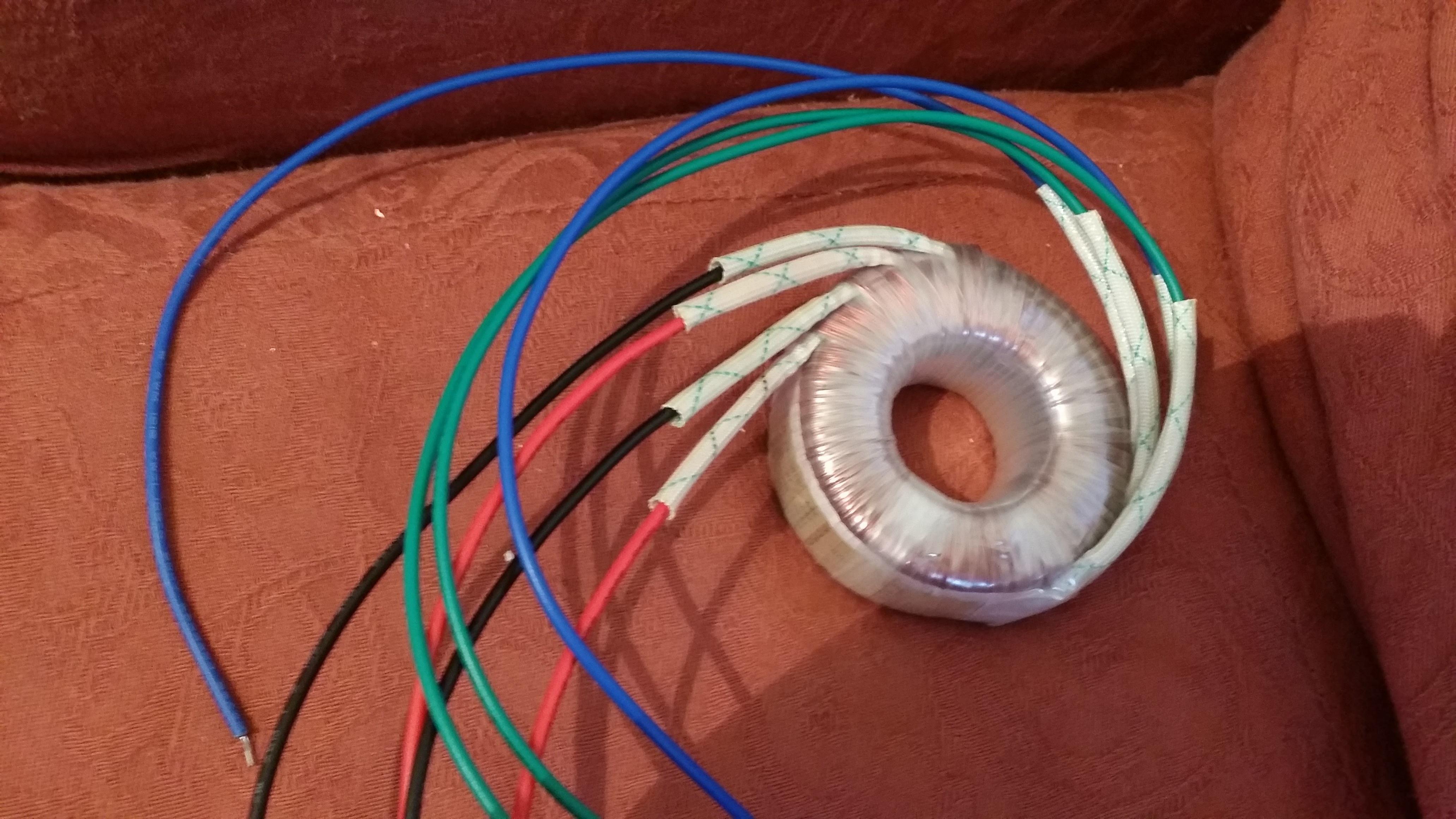

Is it possible to use this case with the parts that are already there? Or will it not work at all? All of the wires on the torodial transformer scared the hell out of me. Which ones go to the power switch or power cord?

Well, it looks just like the transformer that 6l6 used. Is it Antek? If correct for BA-3 pre, primaries are the red and black wires. They go to switch, as 6l6 photos clearly show. Blue and greens are secondaries. Use continuity test with multimeter to determine the correct pairing. They go to rectifier/ power supply. Pictures show this clearly.
Wiring from power supply to board lightly more complicated but clearly dedicated.

Hi all. I am indeed going to have to take baby steps with this but I will eventually get it. I am using the transformer that 6L6 recommended. It has two pair of red/black primaries and the two pair of blue/green secondaries.
I am still in the process of wiring the power switch/power cord/fuse section to the transformer. It looks to me like on the build guide he connects the two red wires to the positive and the two blacks to the negative of the power switch.
My case has a white wire running from the negative of the power switch to the fuse on the back.
Before I go any further I am going to get a grip on this. Which wires do I connect to the power cable itself? You can see on my pic above that I have two loose ends of the power cable coming into the chasis. I am assuming that I would run a wire from the positive of the switch to the positive of the cable and from the negative of the switch to the negative of the cable. Is that correct?

there are not positive and negative on power switch , same as no these on cable
I strongly believe that learning some basics , prior to proceeding further with build itself , will save you from wasting time and money , and especially will give you more safety while working
fiddling with mains powered gadgets is not exactly safe Lego time .

Do one step at a time.
Take a picture of each step and ask for confirmation.
Look at the powersupply schematic a million times and look at a few of the 6L6 build threads eg F4, F5 etc.
Check IEC socket wiring too (google is your friend)
Once you've completed the power supply wiring get someone to properly check your work.

When looking at the transformer primary and secondary wiring, use a DMM set to continuity or low resistance measurement to test which leads are pairs.
So, on the primary side, take one lead and connect the red probe to it.
Take the black probe and touch the remaining leads.
The pair will read 0 (zero) ohms if using resistance setting or hear a tone when they are a pair.
Mark them with tape.
Use the manufacturers key to know which is 120v and the other is 0v.
Now with that knowledge, look at the power supply schema and see how they fit into the power supply primary side build. You can do the same for the secondary side of the transformer.

Use the boards you have to draw a template with them. Outline the perimeter and where the stand-off holes are, even draw some of the parts to mark board orientation.
Use the templates to see where you want the parts to go in the case. It's not a good idea to handle the built boards and place them flat on a metal surface.
