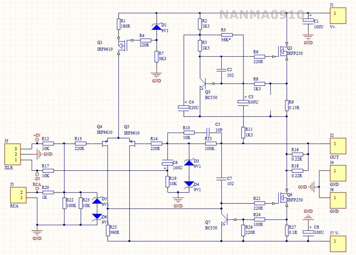

P pftrvlr Member Joined 2007 a-ling.com 2018-03-06 6:04 pm #1 2018-03-06 6:04 pm #1 Got a pair the Pass AM 10W class A boards off eBay. The schematics shown below. I googled but did not find useful info about the design. Anyone has experiences with this amp? Attachments pass_am_10w.jpg 133.8 KB · Views: 659 jacco vermeulen Member Joined 2004 2018-03-06 6:13 pm #2 2018-03-06 6:13 pm #2 The Mini-A P pftrvlr Member Joined 2007 a-ling.com 2018-03-06 6:40 pm #3 2018-03-06 6:40 pm #3 Thanks. Googled again and found that "ALEPH M" design is also similar. Status Not open for further replies. Share: Facebook X (Twitter) LinkedIn Reddit Pinterest Tumblr WhatsApp Email Link
