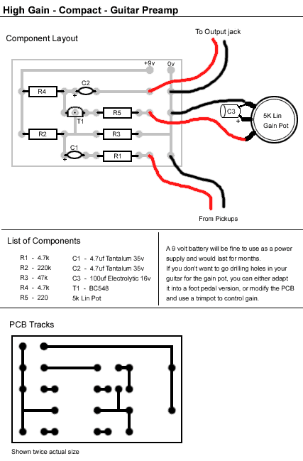

Well I have decided on my first build, small very small for some of you guy's but i have to start some where.
http://www.sputnikmusic.com/lesson.php?lessonid=195
So I have the parts, however the bc548, i could not find locally, so I googled and came up with a 2n3904 or 2n3907 ?
Any way Radio Shack only had a PN2907 . So Is this still gonna work ? should I change any other values to compensate ?
and lastly im going to hook this up in an enclosure to test. I would like to use the stereo input jack to cut power when not in use. How do I do that. I know it has something to do with using the unused right side connector of the 1/4 inch jack. since a guitar is only mono which runs mono left. correct ?
thanx guy's any info would be a help.

PN2907 will not work without modification.
It is a PNP transistor whereas the BC548 is NPN
Check with Radio Shack for a small signal AF NPN transistor
examples :- 2N2222, BC107, BC108, BC109
it will save problems.
Another thing to check with a substitute is the lead order.ie BCE or CBE.
Check whats available with www.alldatasheets.com
good luck
Andy
