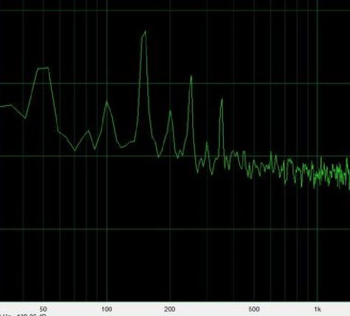

hi ! thanks a lot for the always kind and very valuable advice.
I try to elaborate better.
I am attaching a picture that I think can explain what I mean
Sorry for the bad quality
I have those peaks at lower Hz.
I was wondering if better caps or diodes, the passive parts, can help in smoothing those peaks out.
At first I would like to leave regulators untouched (I mean to keep if possible the original design. Changing it woul imply a complete rework of the unit).
Only intervening on passive components replacing them with others with better specs/different value.

You have strong peaks at 50Hz and odd multiples of 50Hz. The peak at 100Hz is smaller. This is the opposite of what you should expect from a full wave PSU. A commercial PSU doing this might be considered faulty. A DIY PSU would be a design or build error.

You generalise again regarding power supplies, both linear and SMPS can be rubbish or they can be good...
A bad design and layout can only be cured by throwing it in the bin....
Also some supplies may have built in filtering again you could add this to an existing supply and improve its performance. I once steared someone in the direction of Picor/Vicor active filters and the like, for a fraction of the cost of an "audiophile PSU" he built a far quieter better specked PSU.
A y axis grid is always useful on a graph...

My main target is to smooth out and lower the low Hz noise at the 500 Hz level. To flatten out the curve.
